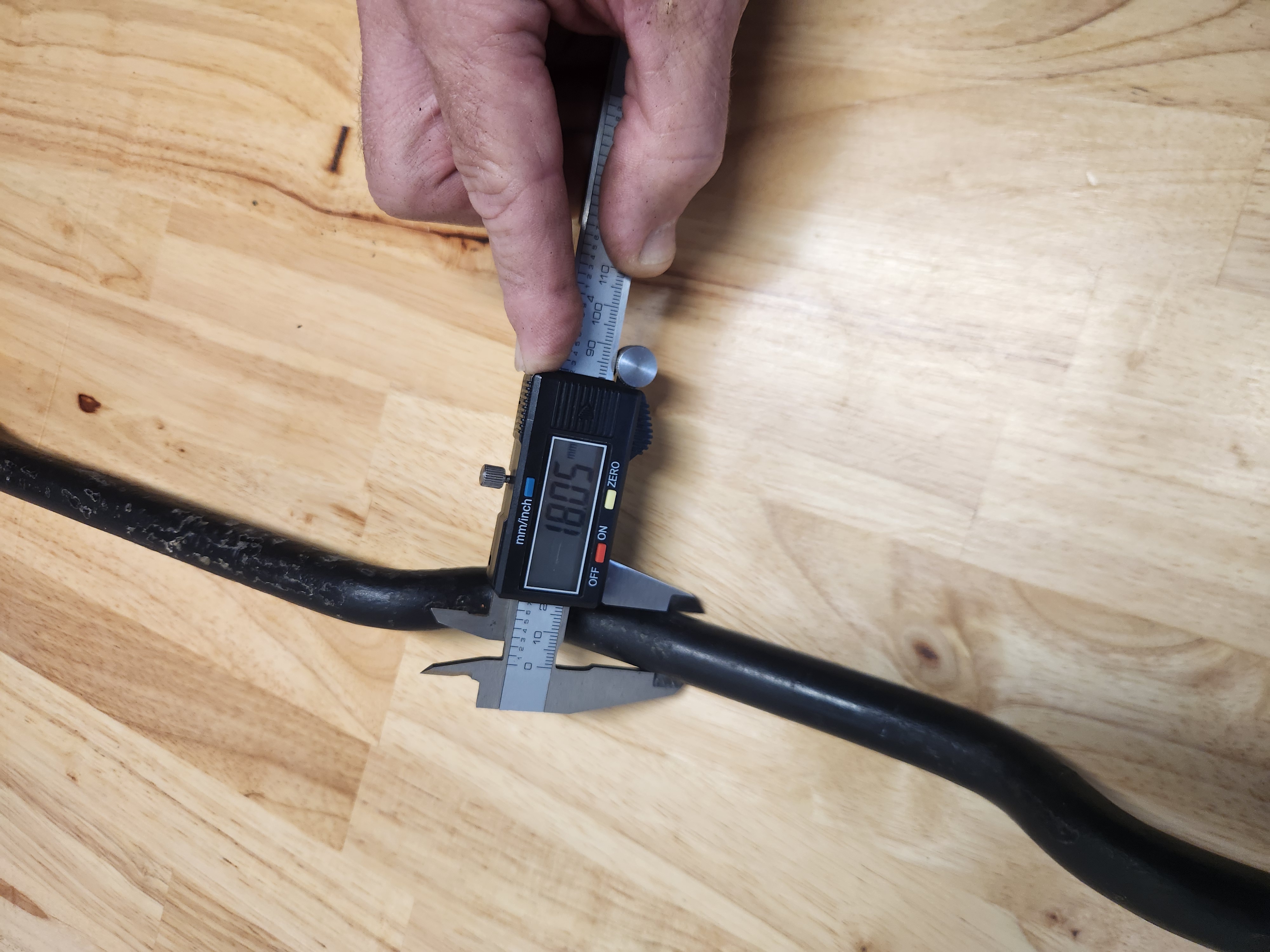

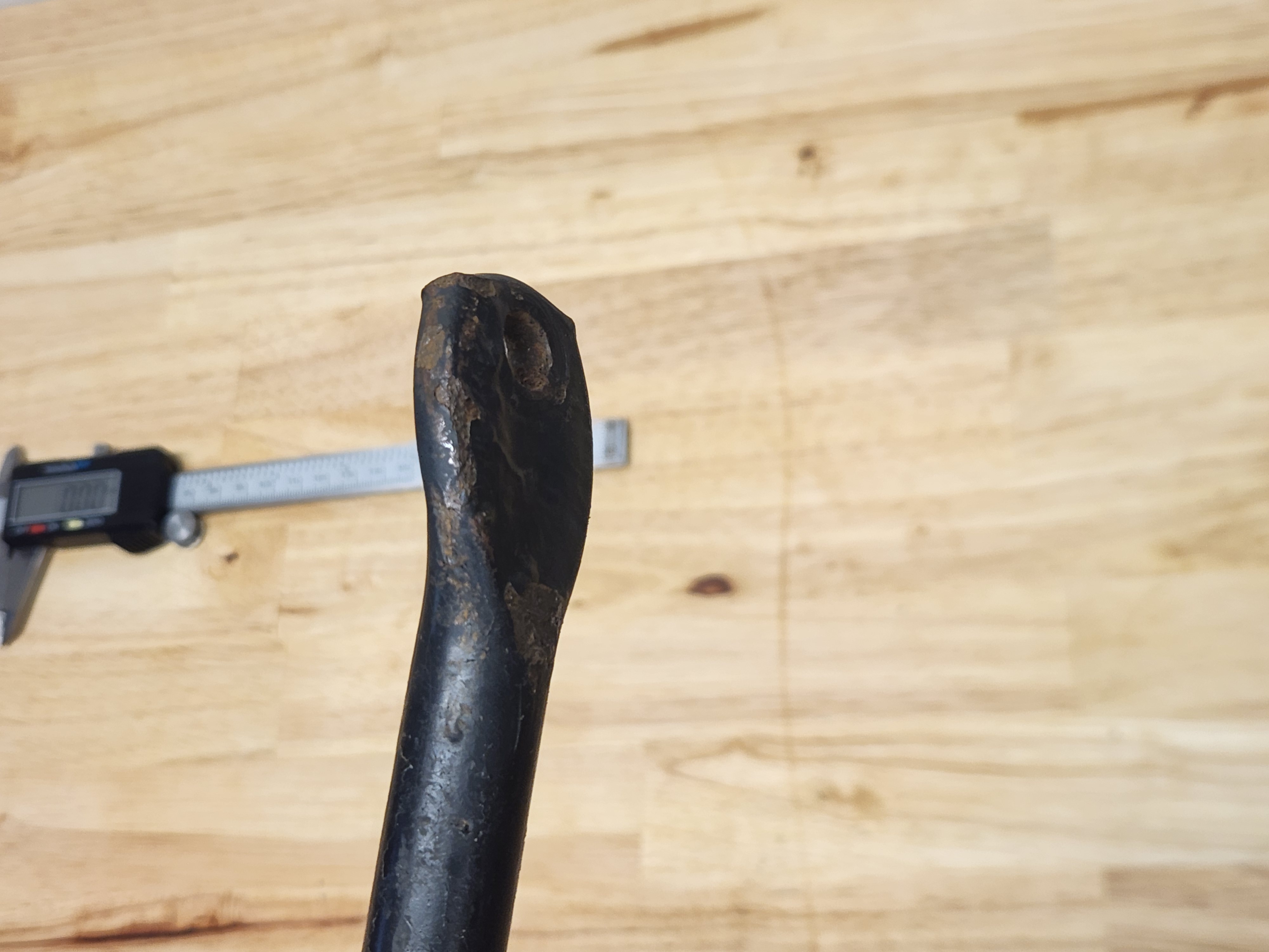

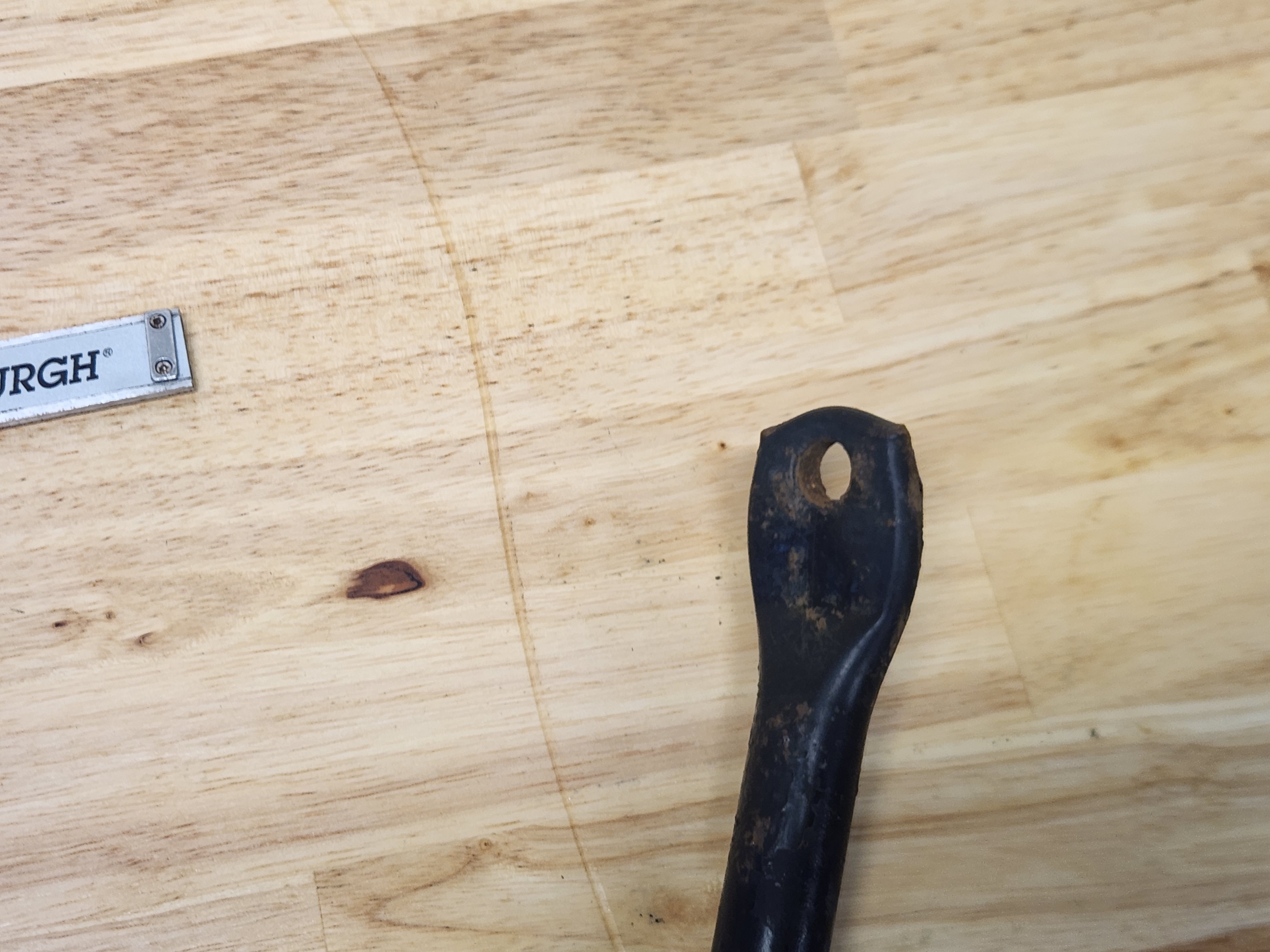

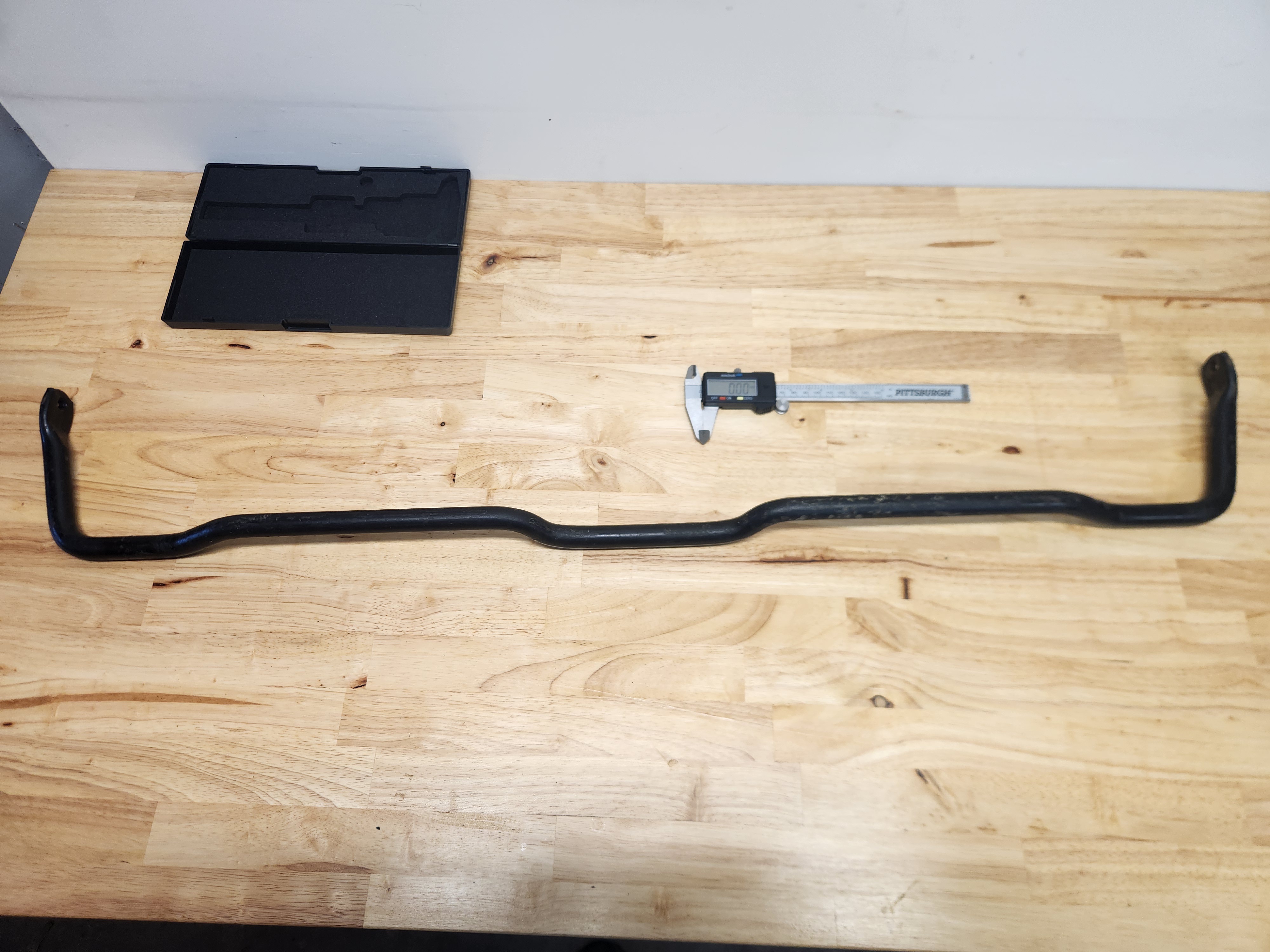

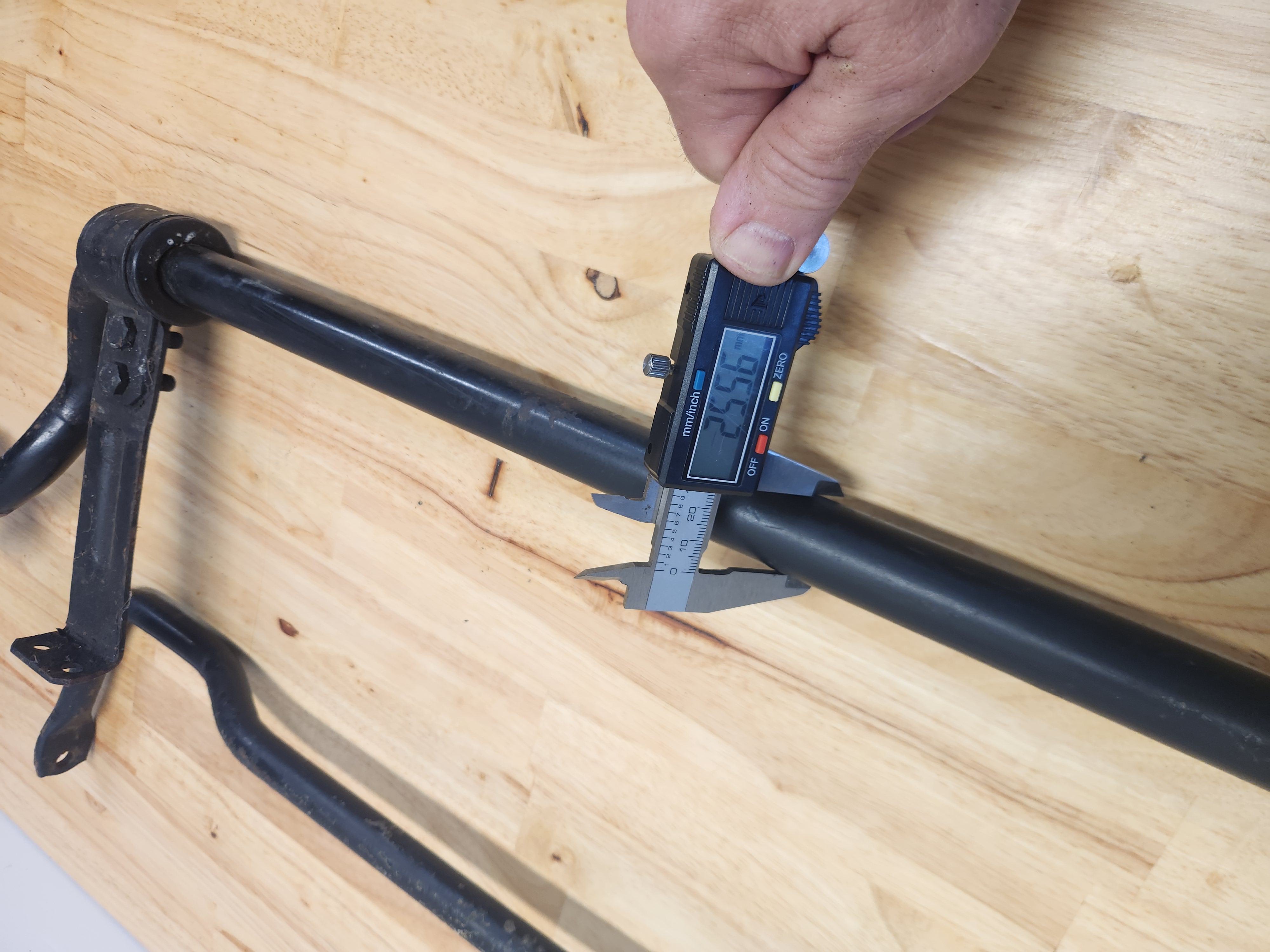

Just got the bars down off the shelf.
There is a small bit of surface corrosion on one end. A wire brush and some Krylon would probably work wonders.
Here's the front... JIC...
Unfortunately, I really don't know regarding the difficulty of changing out the rear eccentric bolts, maybe someone more knowledgeable can chime in.
