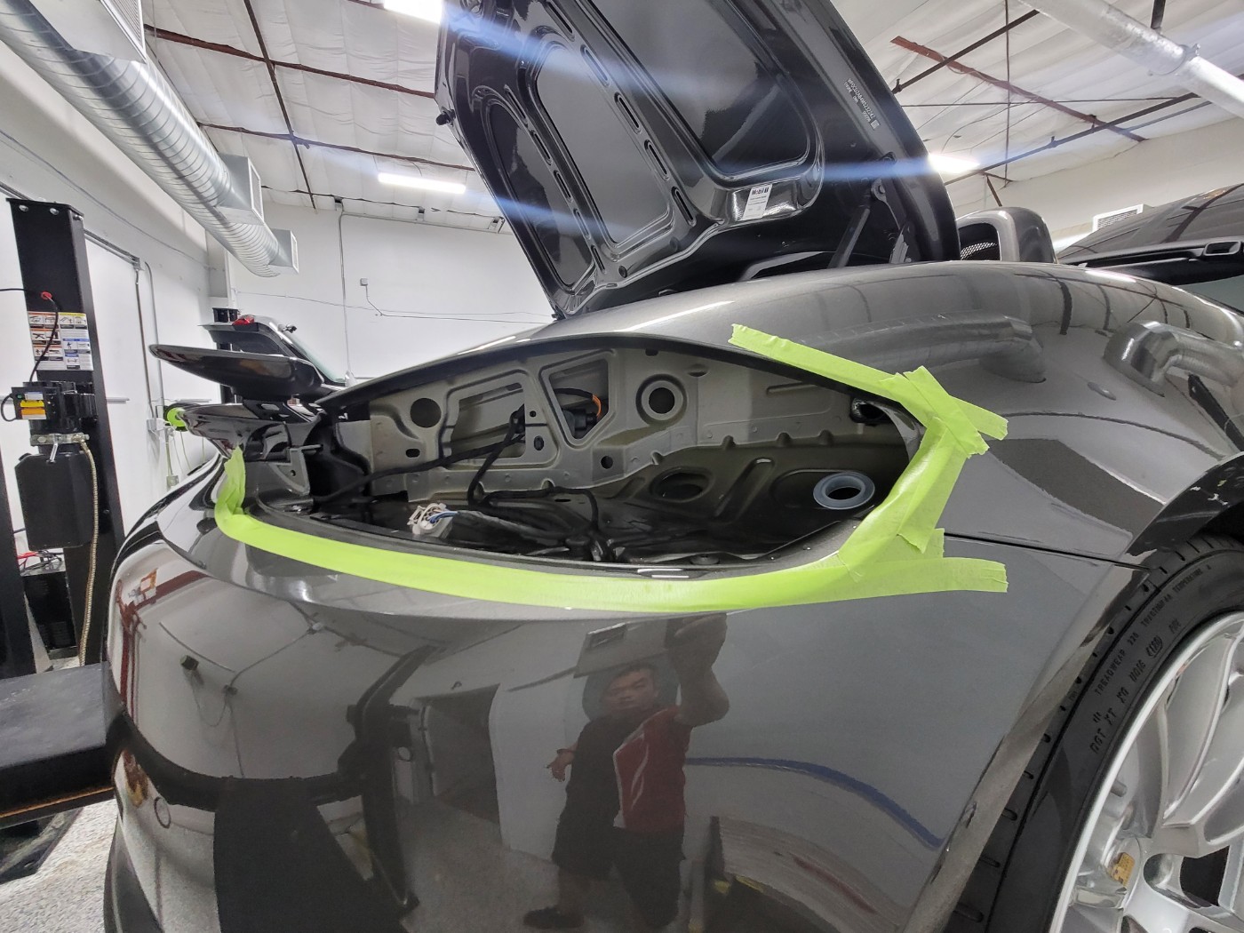

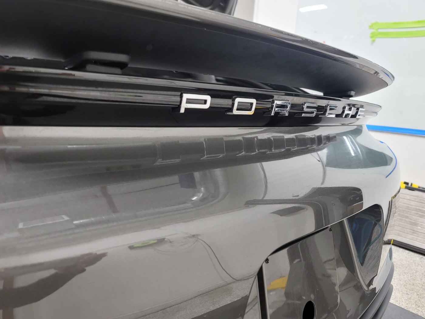

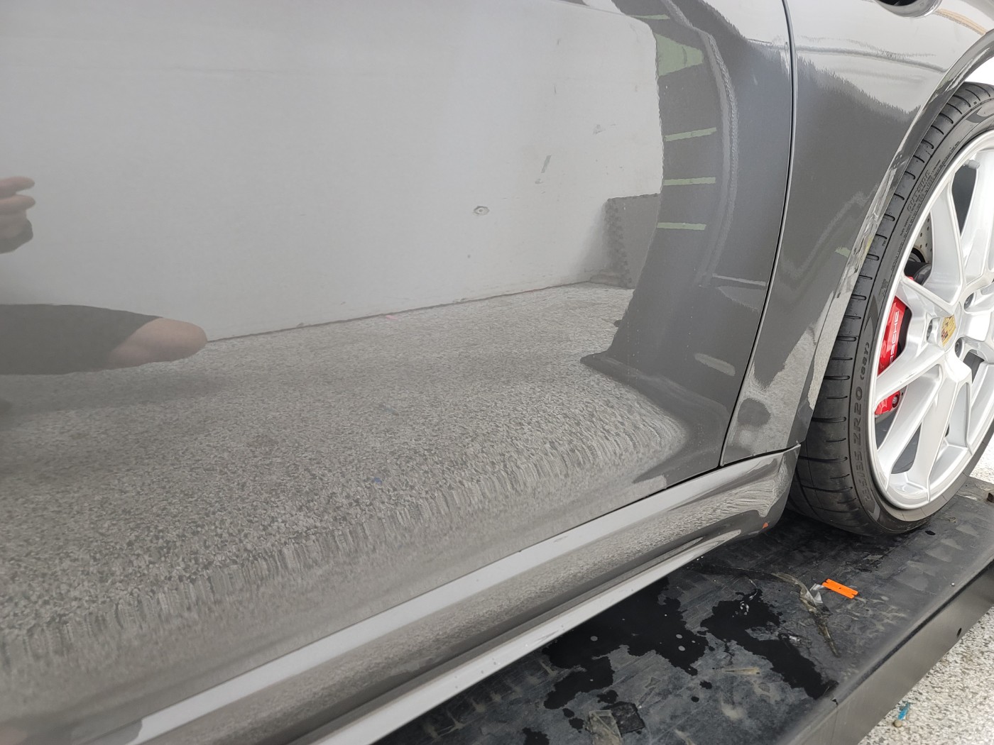

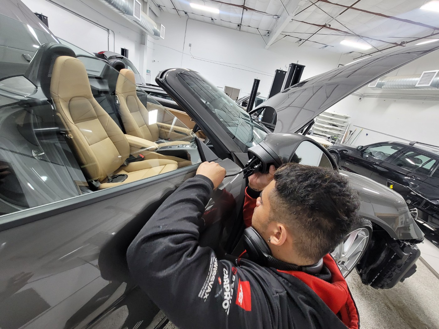

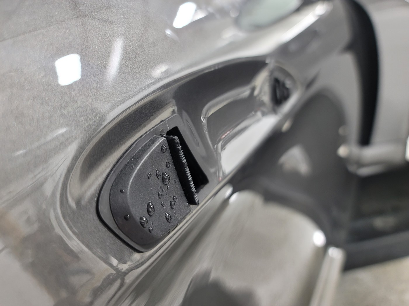

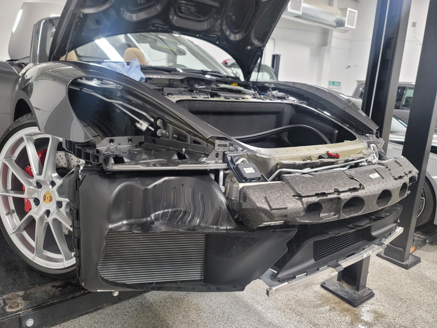

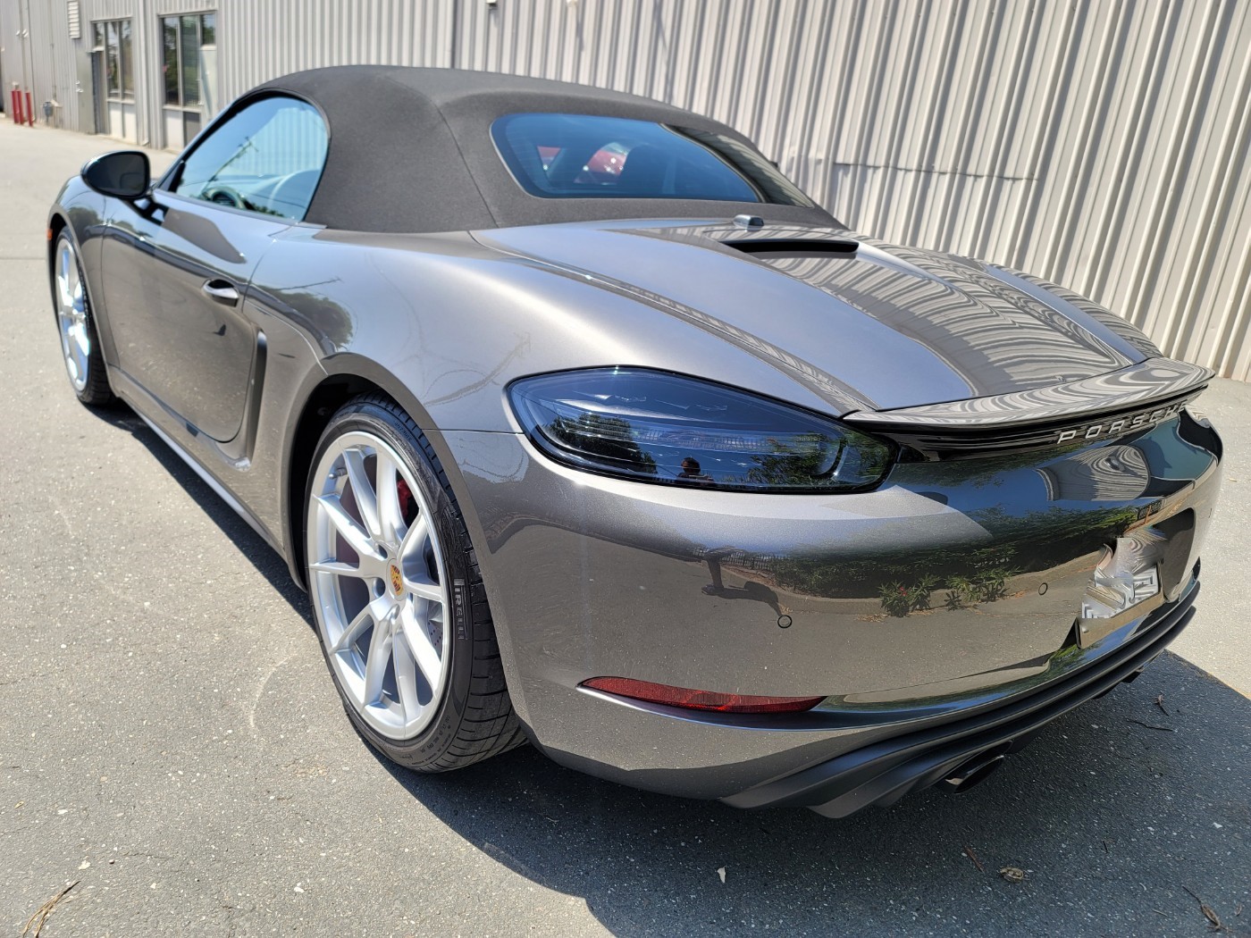

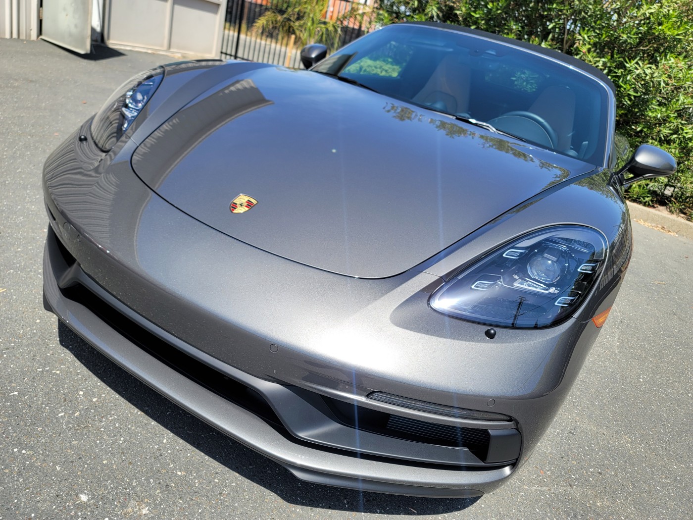

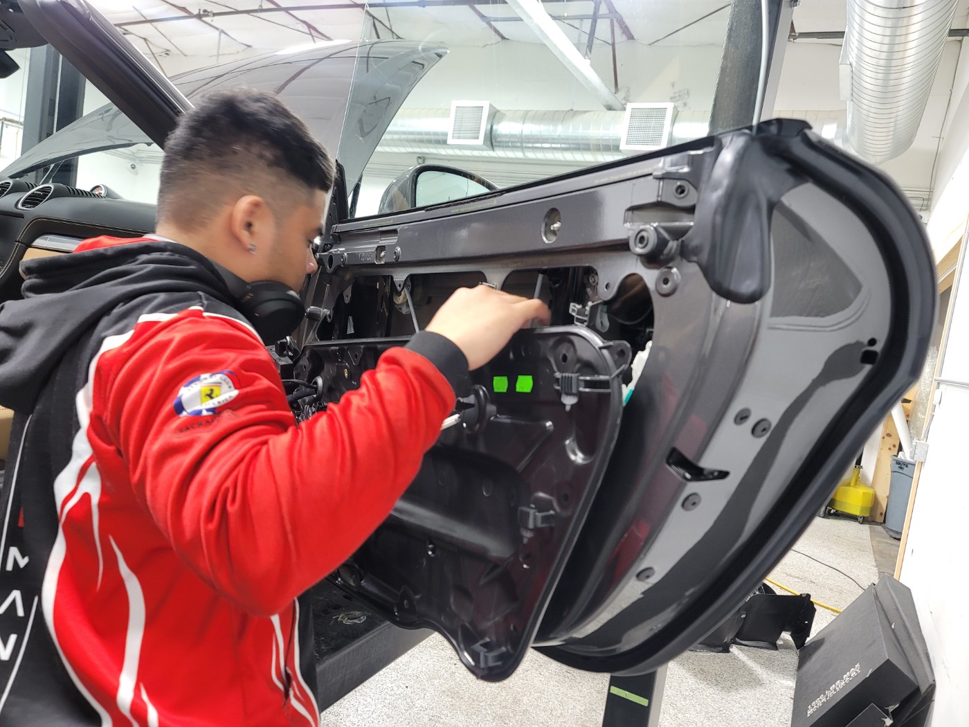

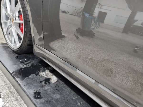

Sorry for being late to the post....I thought I already posted pics. Full car PPF + Gtechniq HALO done in Sacramento by Detail Maniac .... Very impressed with the detail to their work and the finished product. Fairly expensive but well worth it given the cost of the car itself.
