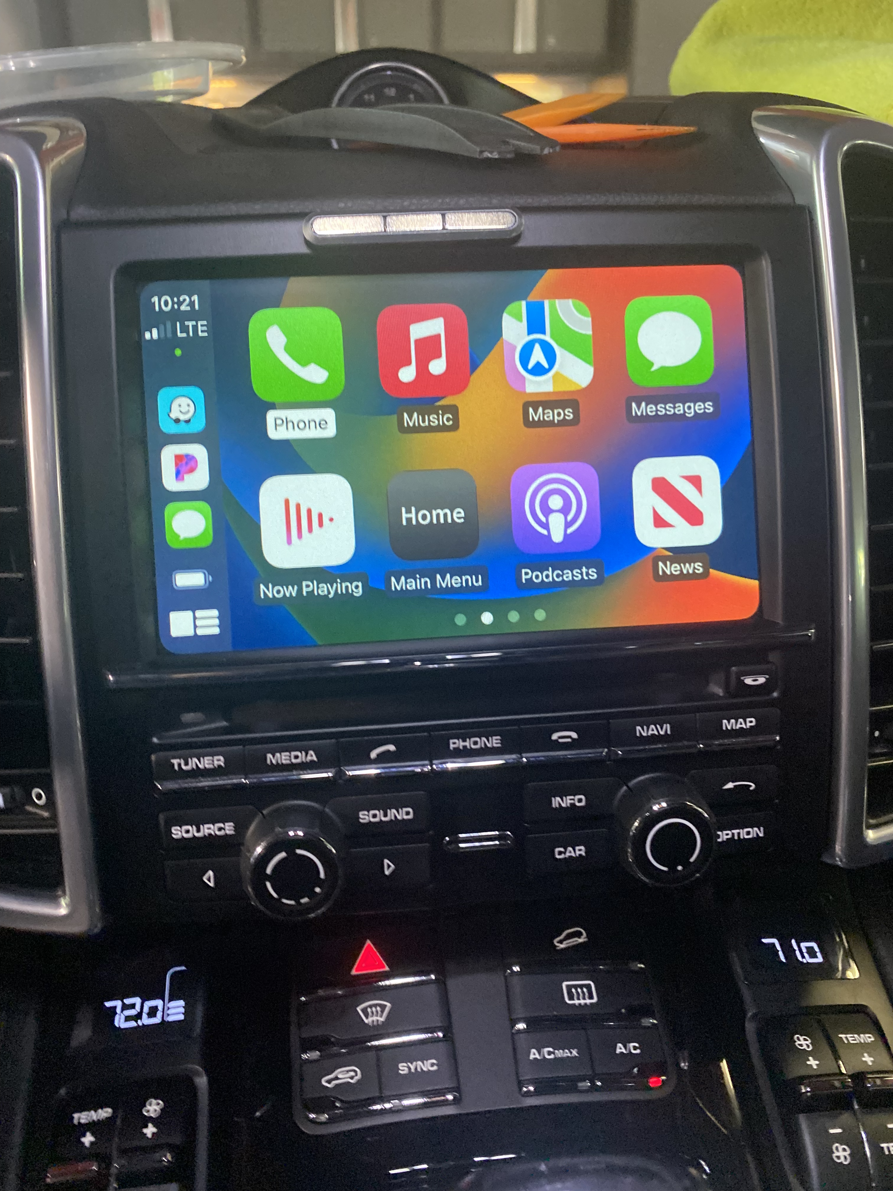

Yes. We purchased the Isudar. Our most recently install was a 2015 Cayenne Diesel. It is a wireless connection with near immediate connection. I am pleased with the results.
Link: https://www.aliexpress.us/item/32568024 ... 4itemAdapt
- CarPlay Cayenne.png (13.75 MiB) Viewed 1193 times
