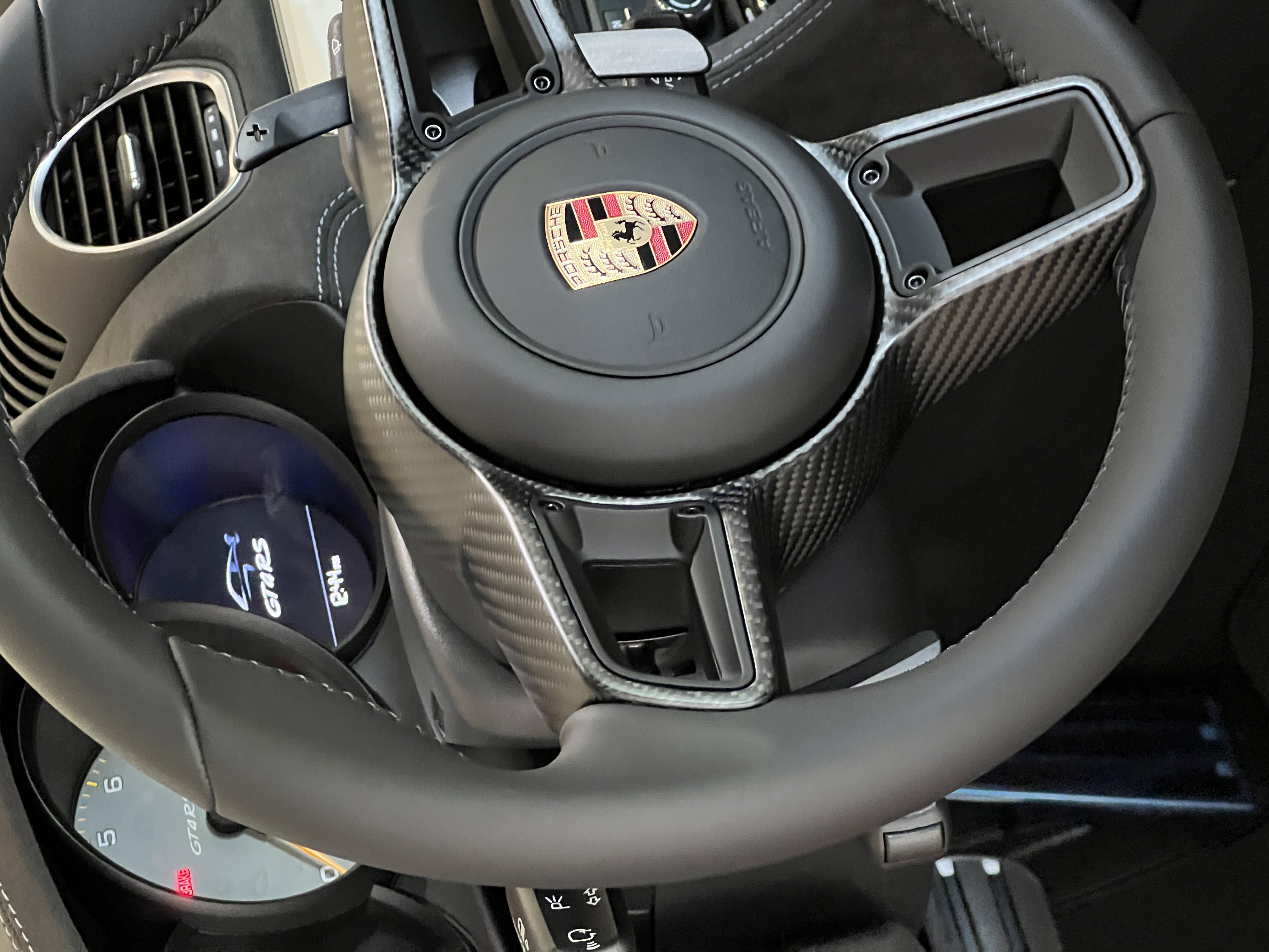

Helped a friend install some JCR aluminum paddles in his RS.

Chulander wrote: Tue Oct 10, 2023 2:11 pm Helped a friend install some JCR aluminum paddles in his RS.
Those look fantastic! I've been considering going with a set painted racing yellow to match all our other yellow interior bits...still on the fence regarding whether it would be too much yellow.

Treemagnet wrote: Wed Oct 11, 2023 11:28 am
Yeah, it’s definitely a “look” to have paddles in a bright color. I have some elements in my interior that’s bright—door handles, seatbelts, and fire extinguisher. I found the bright painted trim can get to be a bit too much when sprinkled all over the place.
So for my car, I went with black paddles:
