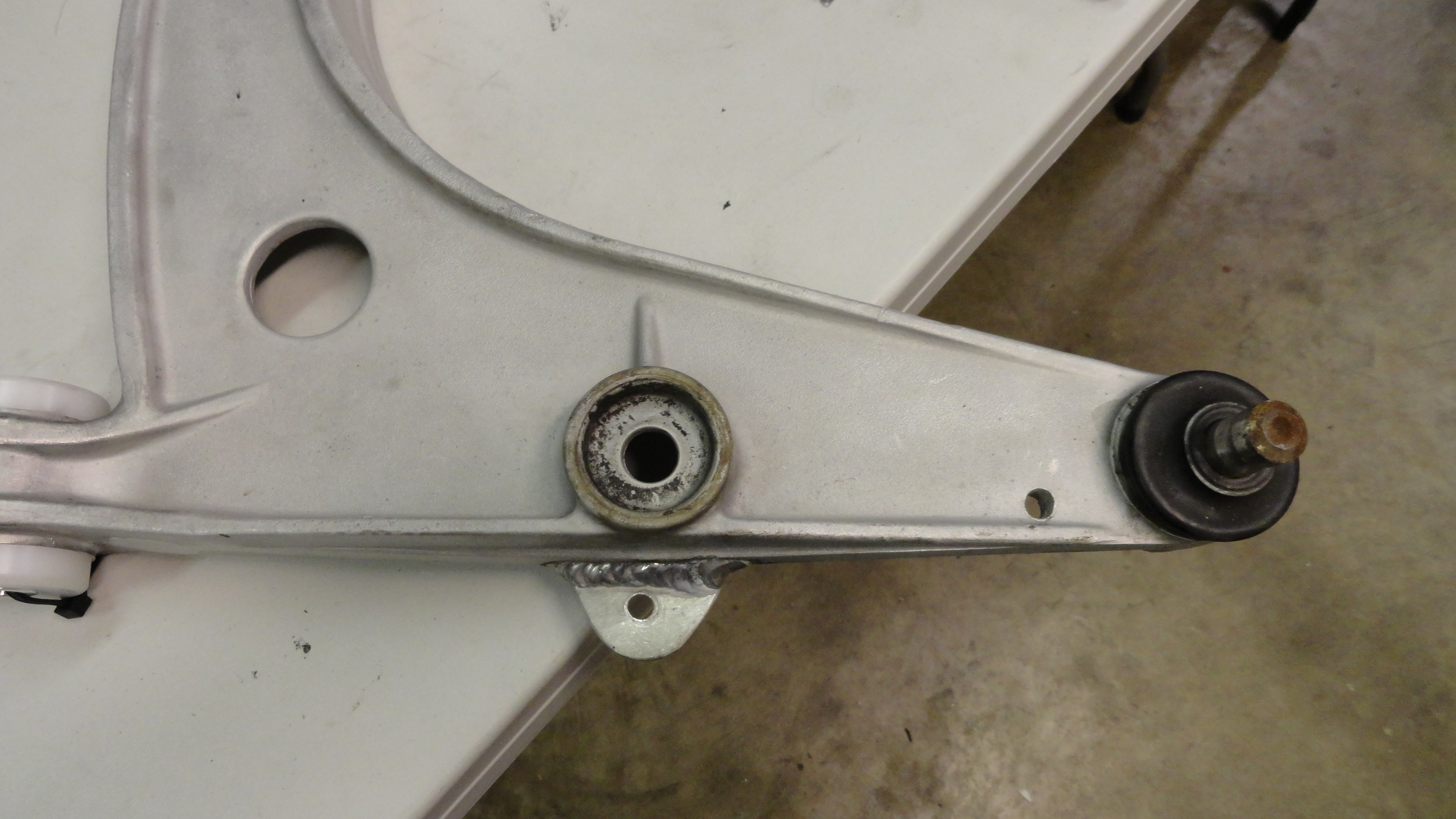

I had tabs welded to the arms, and drilled one hole in the arm.

Cruise98 wrote: Wed Mar 20, 2024 6:07 am DSC05438.JPGDSC05437.JPG
thank you! perfect!
