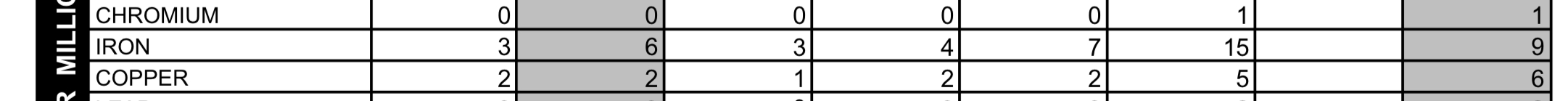

FWIW, I’ve attached the last report from my 99 996. You can see that there were a couple of high iron numbers, which correspond the oldest readings, but overall they just tended to fluctuate. I wouldn’t worry until/unless you see consistently high numbers over multiple changes.
Here is an example of iron that is too high (not mine): https://www.blackstone-labs.com/wp-cont ... Report.pdf

Very helpful, thank you! Interesting report on that engine that blew. I'll bet he wishes he'd heeded the report from 4 years prior and maybe addressed the IMS with those high numbers. Of course, you never know for sure what is going on, I suppose. But then, that is why we do the oil analysis, isn't it?! Same reason I get a blood work-up every year!vitaminc wrote: Sun Mar 31, 2024 7:28 am FWIW, I’ve attached the last report from my 99 996. You can see that there were a couple of high iron numbers, which correspond the oldest readings, but overall they just tended to fluctuate. I wouldn’t worry until/unless you see consistently high numbers over multiple changes.
