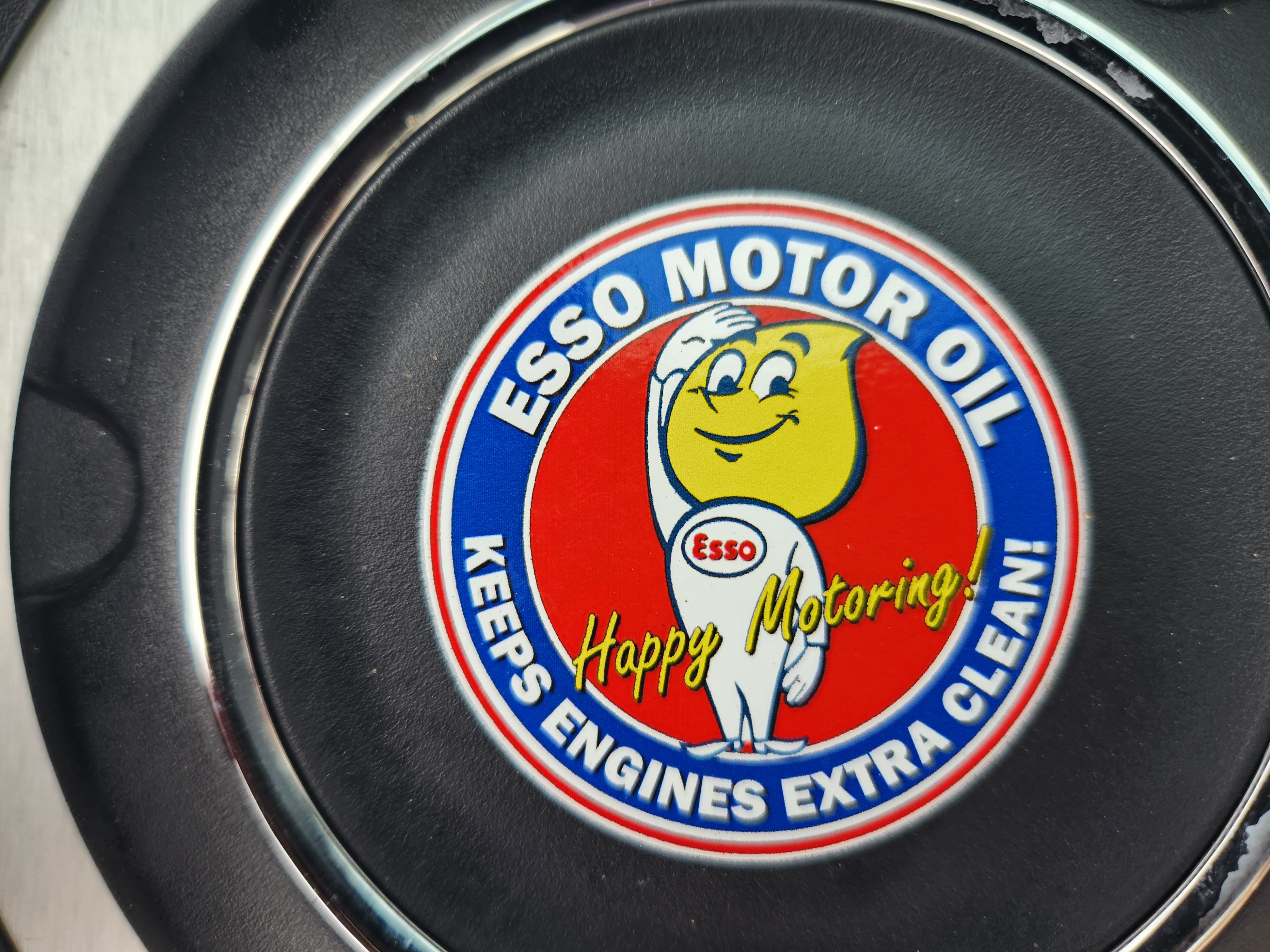

And... what do you have on your OIL/WATER caps?
It worked great for my entire trip, over 2000 miles, including spirited backroad driving. I never had to adjust anything.
The oil decal is sentimental. The coolant one was an afterthought I'm not sold on. I know I dislike the imprecise 'Water' decals I sometimes see.

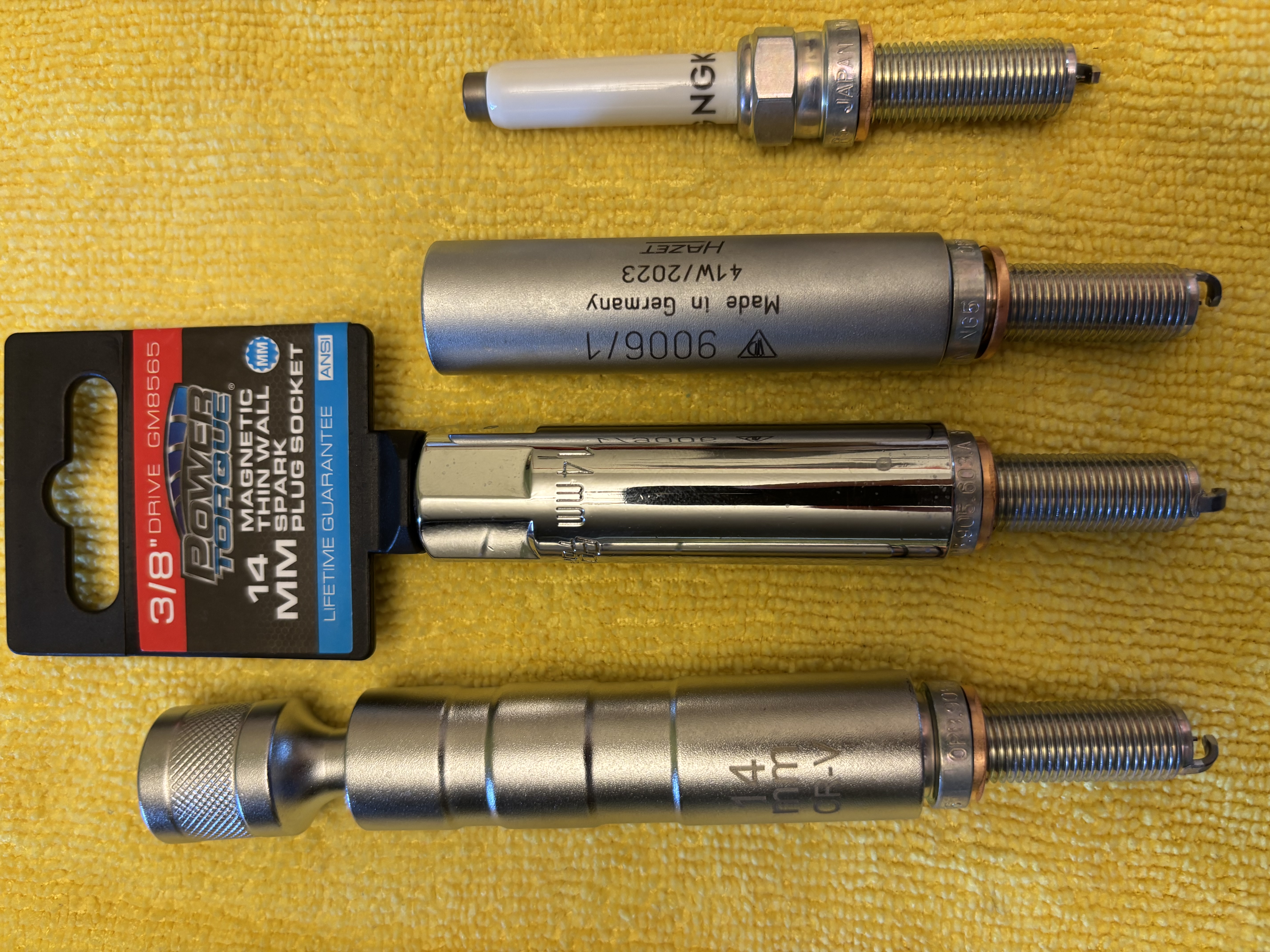

Want to change the spark plugs, just for fun.
A couple weeks ago I removed a coil pack to see if either of my 14mm spark plug wrenches would work, they did not. Too fat to get all the way down the spark plug hole. I bought the genuine Porsche tool, which turned out to be a Hazet 9006/1. I considered buying this straight from Hazet for half the cost, but decided to go straight to Porsche since I just did not know. Now we all know, save yourself a few bucks.
The far left is 18.4mm, the middle is 18.3mm and the Porsche/Hazet is 17.3mm wide. I have not swapped them yet but it does look like this will work.
The NGK plus are straight from Porsche as well, I can't find them directly from NGK.
This is for the 4.0l six cylinder, I believe this same wrench is required for 991 GT3 as well.

You really should get a swivel. That, and another swivel fitting.
This one is 17.7mm, and I've done two spark plug changes on 2.0L 718s.
https://www.amazon.com/gp/product/B07RR ... =UTF8&th=1
Also need a selection of extensions. Different plugs require different combinations/orders of extensions/swivels. Start with the left side, which is easier. You'll have learned a bit before doing the right side, which isn't that much more difficult.

Thanks for the link, I had not seen that option before.

This is the one I have, a few bucks cheaper.
https://www.amazon.com/dp/B092YLDXDT?ps ... ct_details

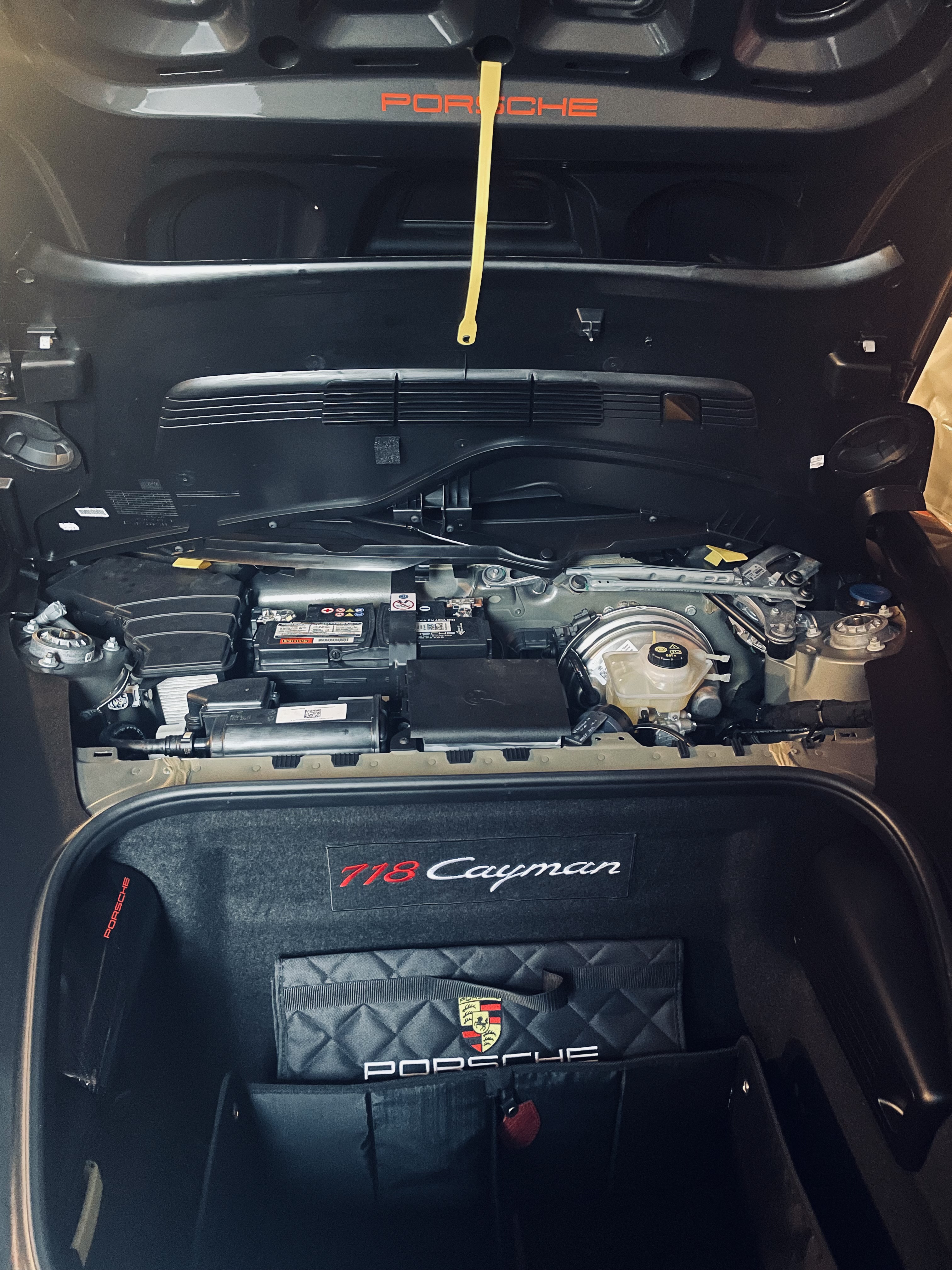

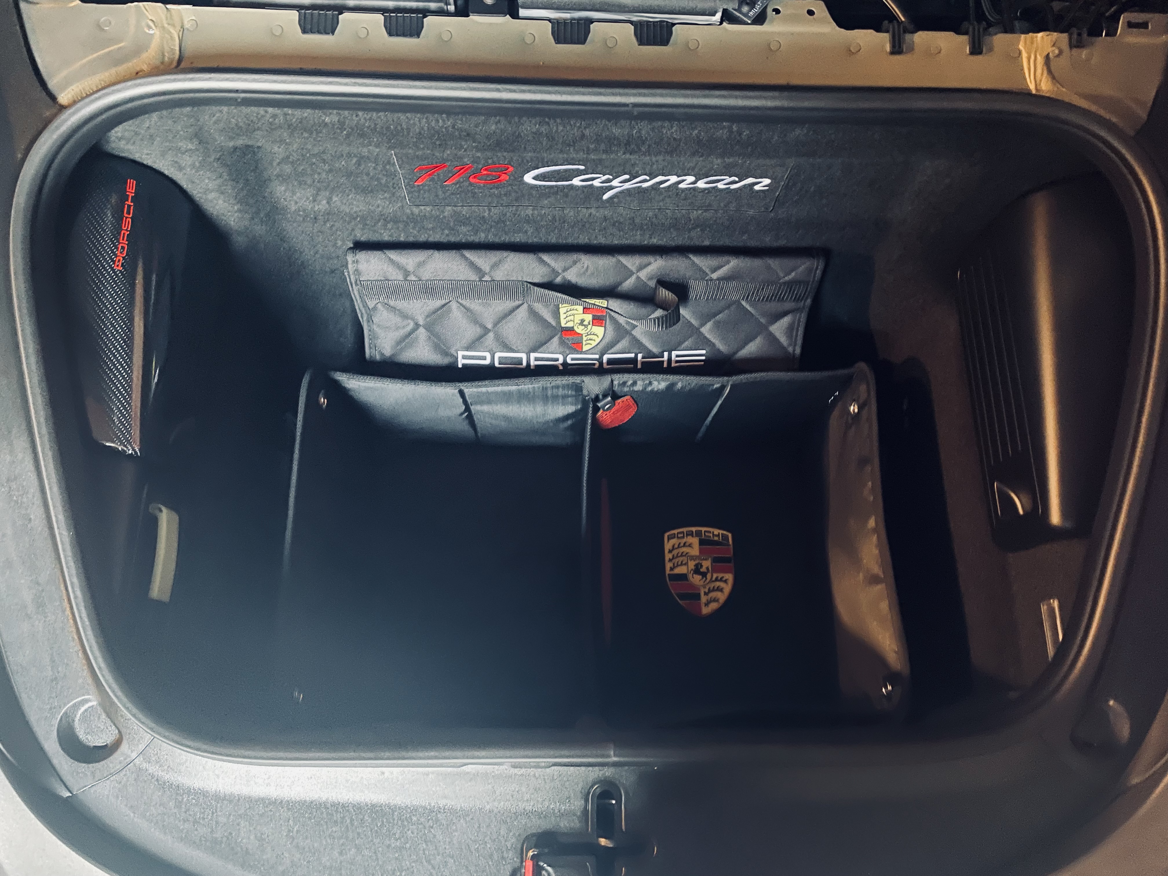

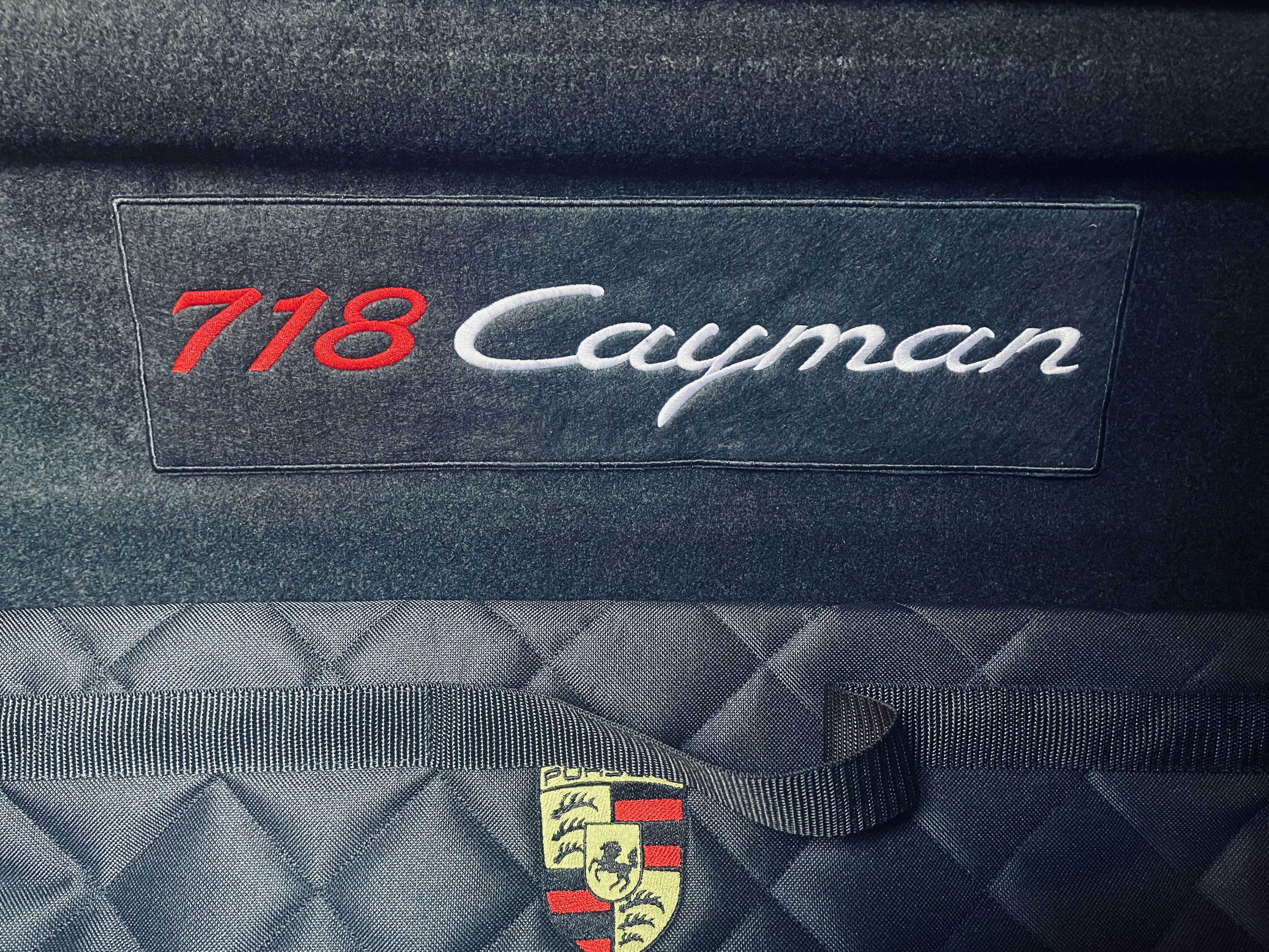

Replaced some velcro for my "718 Cayman" embroidered felt badge for my Frunk...
Rather embarrassing.... I only just now discovered the yellow cover holder for the frunk cover (as seen in photos)... Had no idea. Every time I needed in there, I just took it off and put it some where in my garage... I should have known better Porsche had a solution for that :lol: :lol:

It is handy!

As a “Recovering Perfectionist”, I’ll let it slide :lol:
