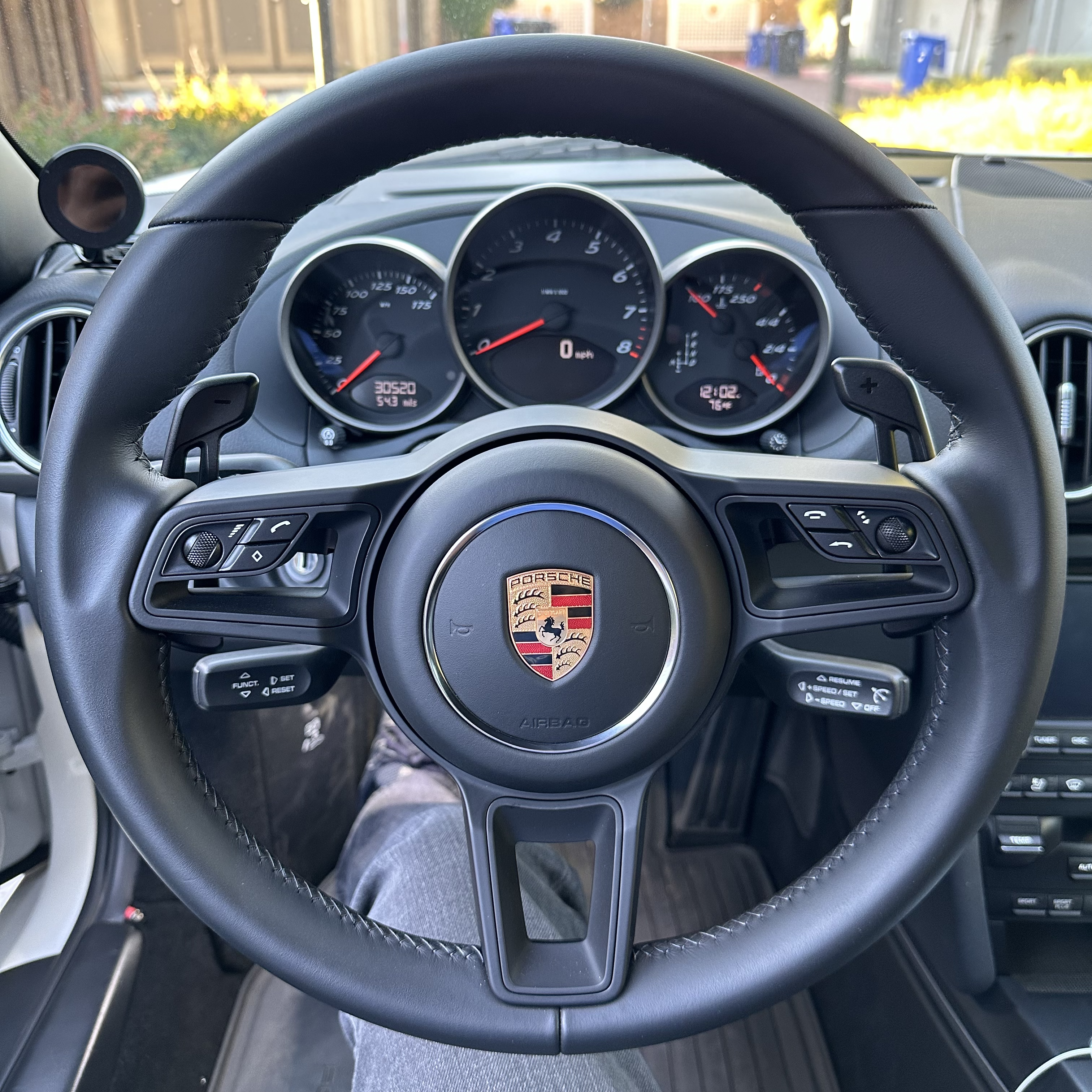

Depends on your budget and what functionality you want to add/keep. It's also a lot harder to find a replacement wheel if you have a non-black interior and want a color-matched steering wheel.
Cheapest and most popular option is to swap to a 987 sport design steering wheel with the paddle shifters. I see a lot of these for sale locally for <$500 with black leather. The nice thing about using 987 steering wheels is you don't need to pay extra for the airbag, you can simply swap your current airbag over.
I ended up installing a 982 GT sport wheel w/ multi-function buttons and heating. It's a lot more expensive than the former option since you need to get the 982 airbag and an adapter to get the multi-function and heating working. It was close to $2200 for the wheel + airbag + adapter, and then another $1300 to get the heating working since the car did not have the heated steering wheel option from factory. Photo:

Also Techart sells a paddle shift conversion kit for the buttons but it's more expensive than finding a used 987 sport design steering wheel. However, you do get to keep your multi-function buttons assuming you have those on your current wheel. It's also probably your only option if your interior is non-black and you want a color matched wheel but don't want to spend the time finding one.
