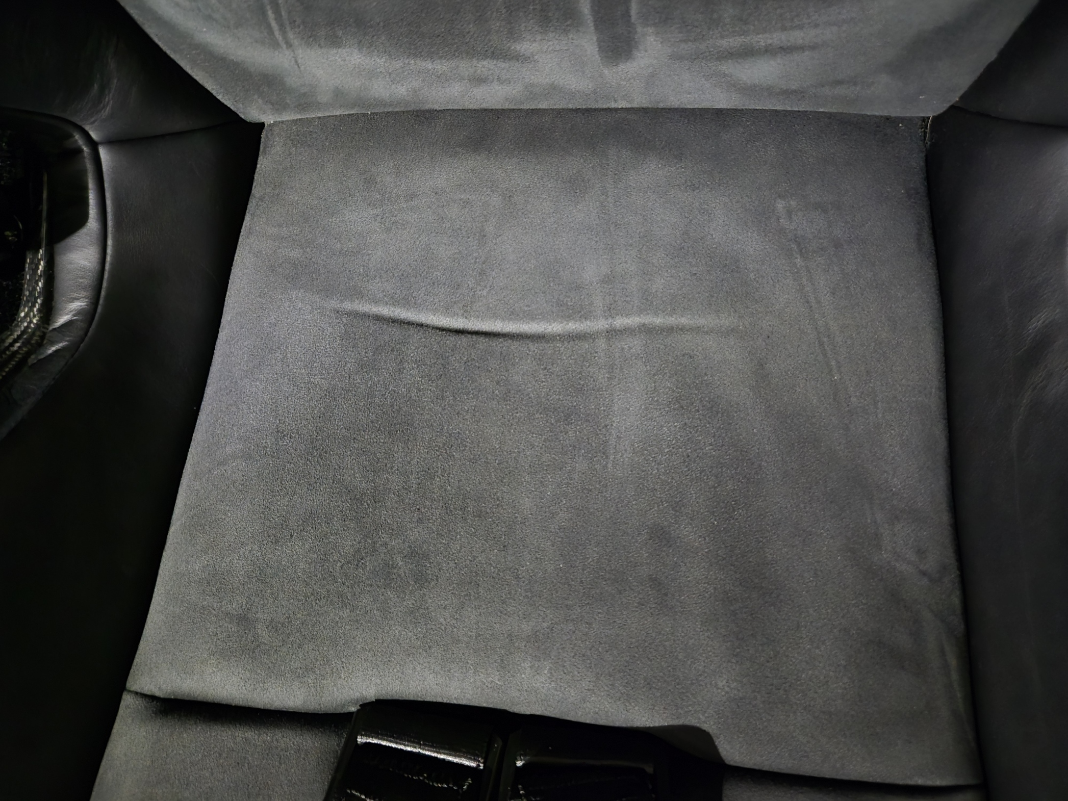

Refresh packed-down LWBS seat cushions in 718 GT4
I've always used competition seats (Cobra Evolution, etc) in my DE cars and they always retained their thickness, never packing down. I recently became the owner of a nused 718 GT4 and have found after 6k miles (in 3 months) that the drivers side has both packed down and developed a crease. Normal Alcantra cleaning hasn't had any real effect, looking to see if there's something I'm missing or it's just the nature of the seats.

Thanks for the comments. First pass around for Alcantara, learned quickly how to use Sonax to get the steering wheel back in shape, amazed how dirty it got from the previous owners. Replacement for a wrinkle in a 3-year old car seems a bit much at this point, just seems odd/disappointing for an OEM product to pack out with this type of usage.

Can you post a picture of it?akirasan wrote: Mon Aug 04, 2025 10:46 am Thanks for the comments. First pass around for Alcantara, learned quickly how to use Sonax to get the steering wheel back in shape, amazed how dirty it got from the previous owners. Replacement for a wrinkle in a 3-year old car seems a bit much at this point, just seems odd/disappointing for an OEM product to pack out with this type of usage.

Yup - unlike the previous owner I'm gloves on-track and clean hands in general as well. I'm ~170 w/helmet so not terribly large. The Alcantra material itself is fine, it's the foam that is at issue where it appears to have lost its memory capabilities. The only thing I can think of - I have brackets that rock the seat back ~3 degrees to keep my neck in position when wearing the helmet. I know that changes load angles (had to put a Sparco cushion in for lumbar) which might account for creasing (pushing forward instead of straight down) but that's just a guess. Fun times...

Now I understand - it's the cushion foam itself that's the problem, rather than the Alcantara. Maybe there's a way to get rid of the crease? Light steam? (Don't try that based on my suggestion - was just a random thought!) A good upholstery shop should have an idea.

Thanks! I'd seen the steam thing with upholstery restoration so maybe an option. For grins I've poked my service advisor with "Is this supposed to happen on these cars while under warranty?". Car is fun - my previous built 987.2 was fast, this is equally fast with less effort (safety buffer), lots of upside should I decide to push like I did with the old car.
FWIW, here's what it looks like:
Local dealer mentioned upholstery shop they work with, added that Porsche typically stays away from any warranty coverage for things like this. Maybe the answer is steam them, put them in a plastic bag and get inserts from Eddie.
