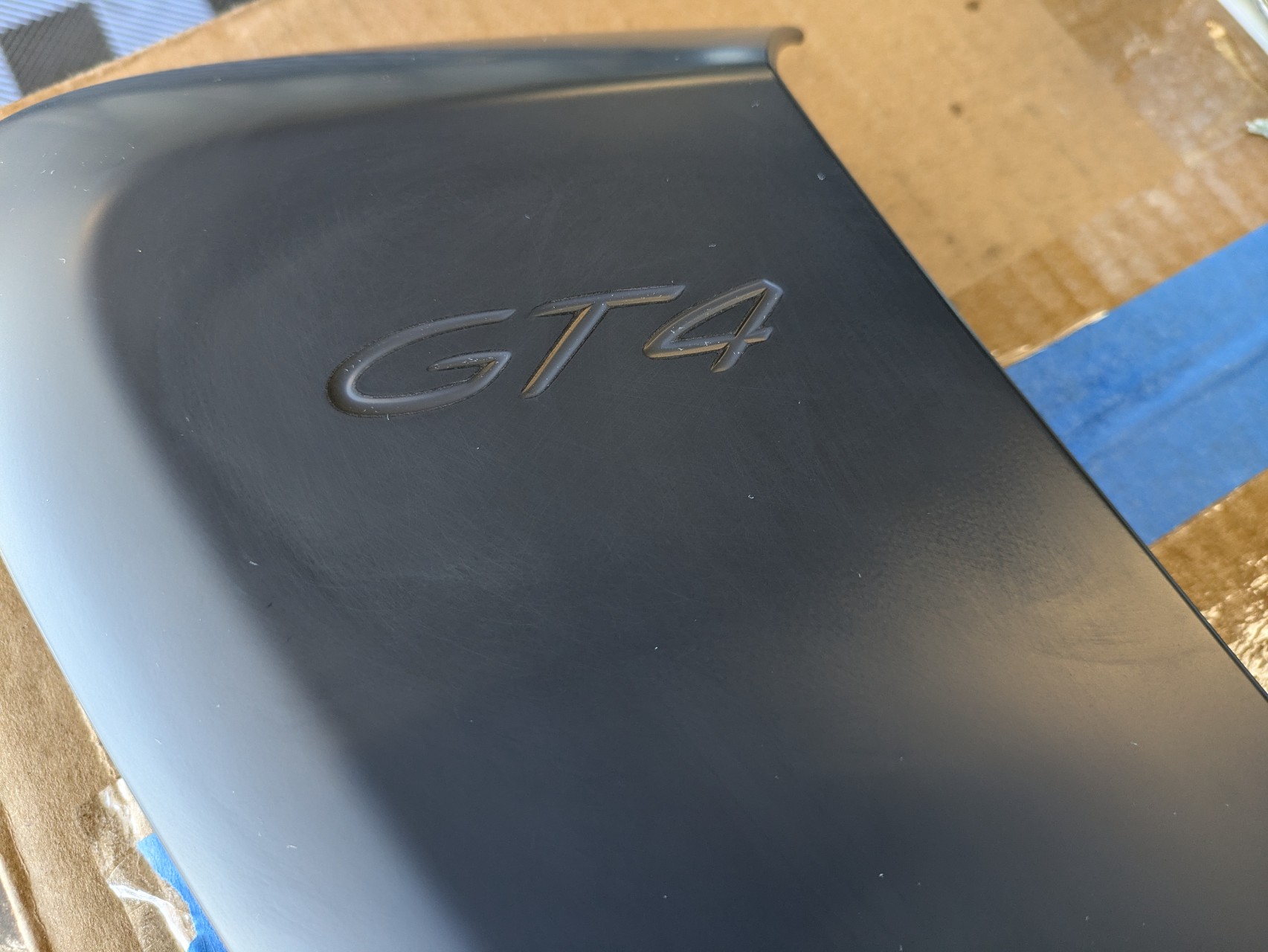

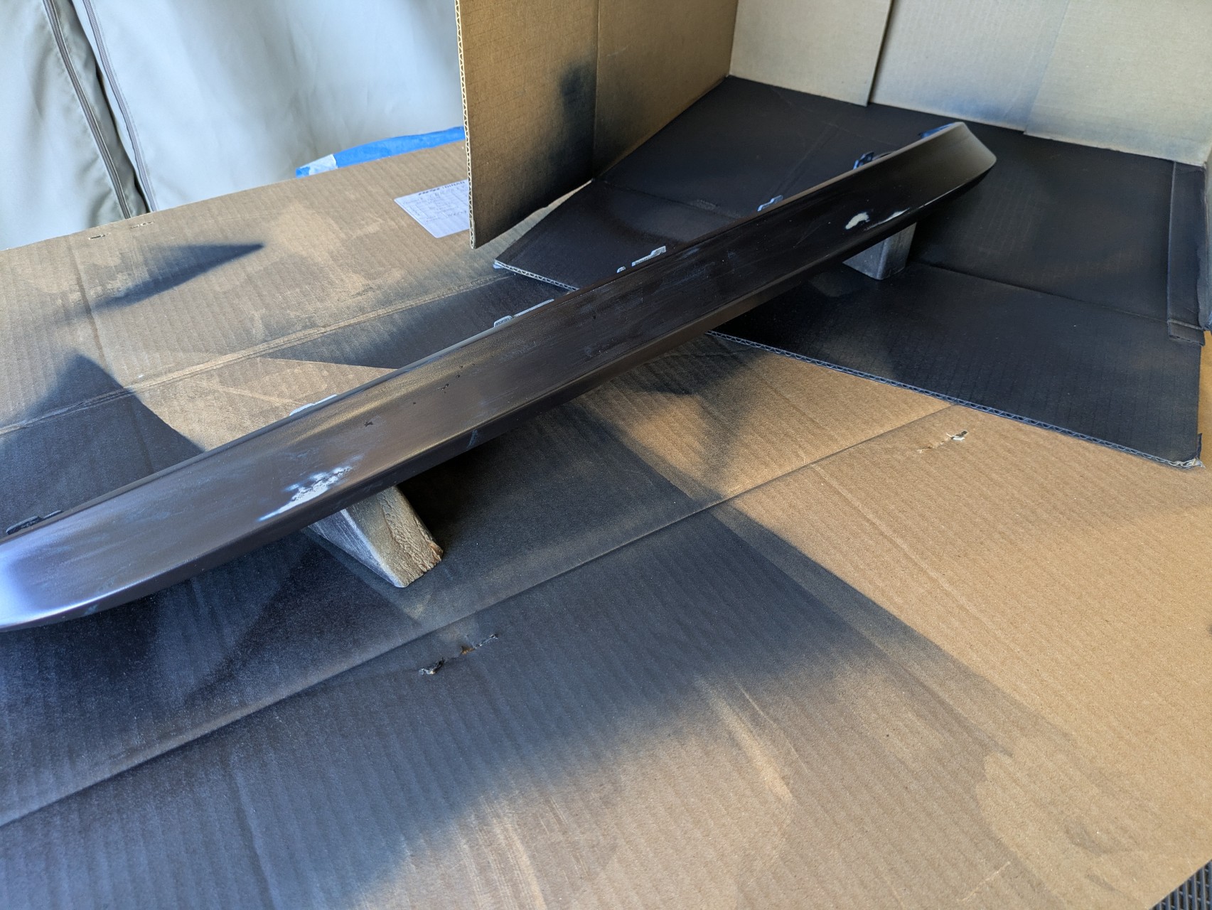

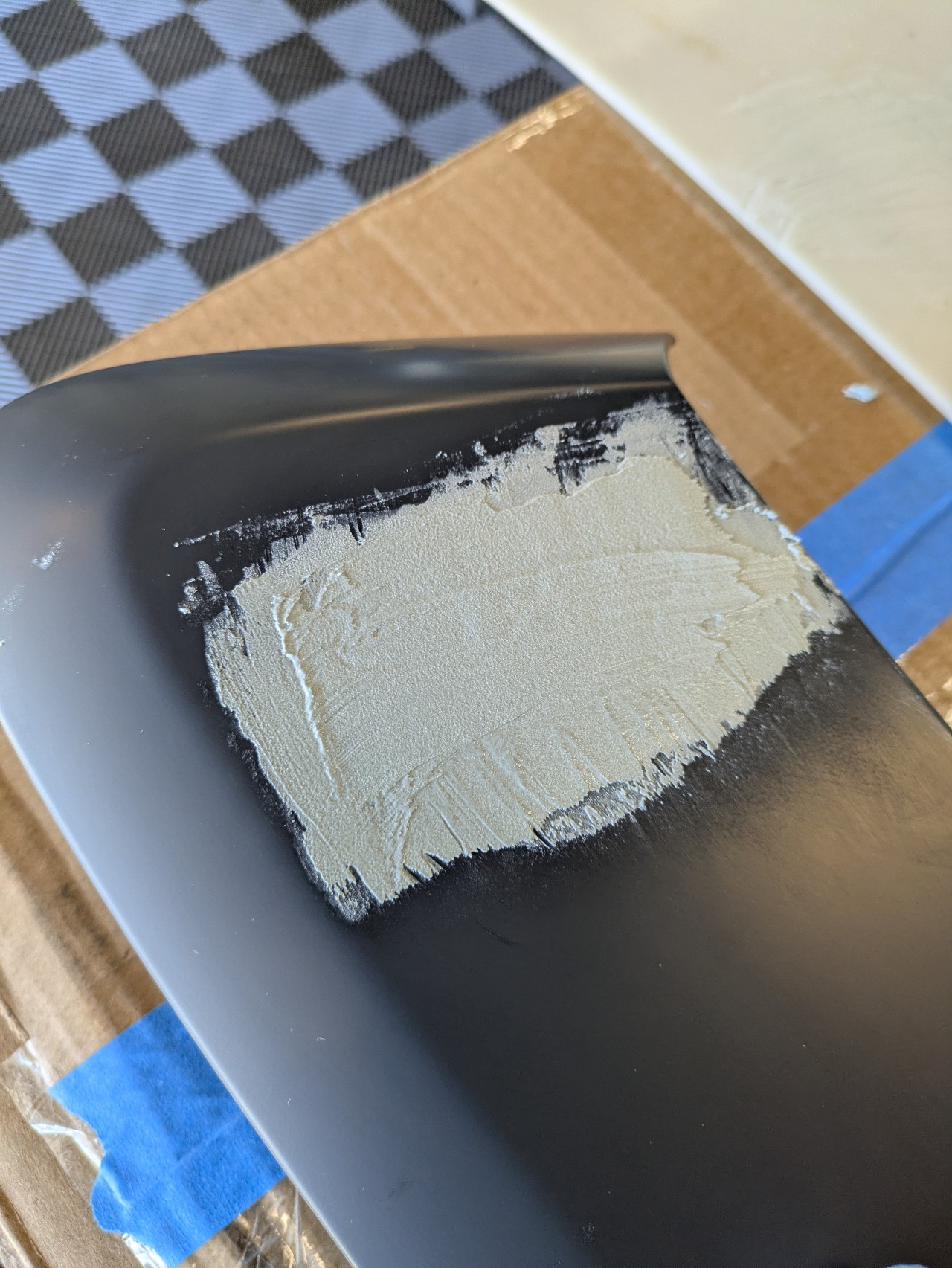

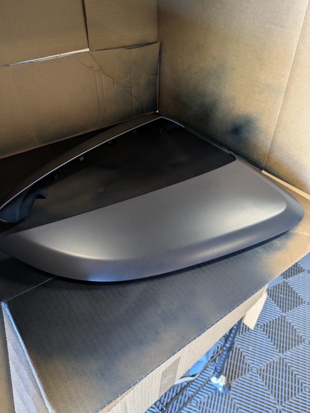

We start with "Bondo" body filler. I scuffed up the stock surface to ensure the filler would stick well. Mix; Fill; Sand, and repeat until any tiny holes are filled. Gaining experience applying an even coat is what means you won't have to do this 3 or 4 times, but just know that you can always sand it off and try again.

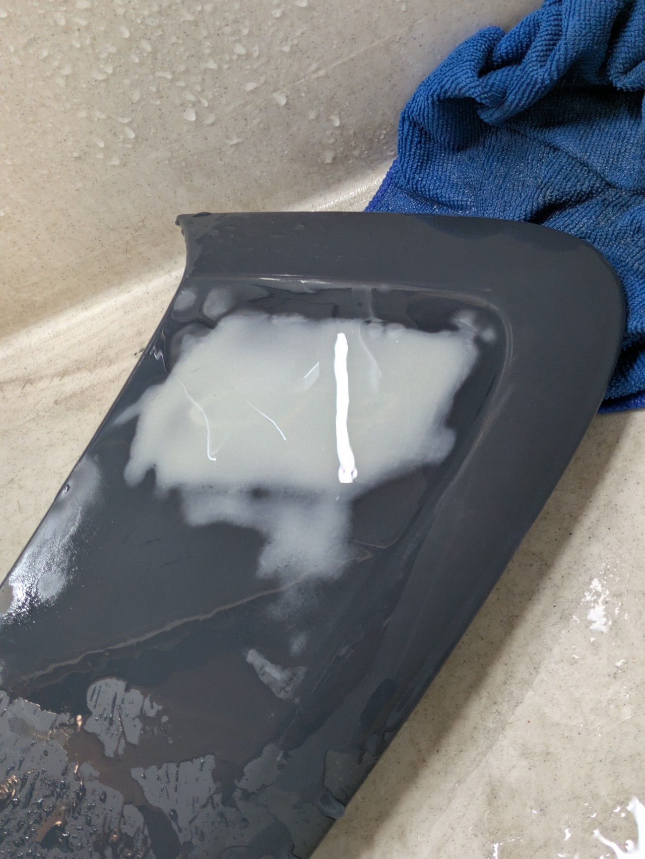

Let the filler completely harden 24 hours+ before wet sanding. Now the dusty part is behind us and we'll wet sand the rest of our work. I picked up a pack of 2" wet sanding squares, and I started with a 300 grit to knock this down quickly, and moved to a 500 grit to get the surface flat. You'll see in these pictures I'm using the reflection of my garage lights to determine the surface flatness. Having a utility sink is nice, but you can layout some towels on a workbench.

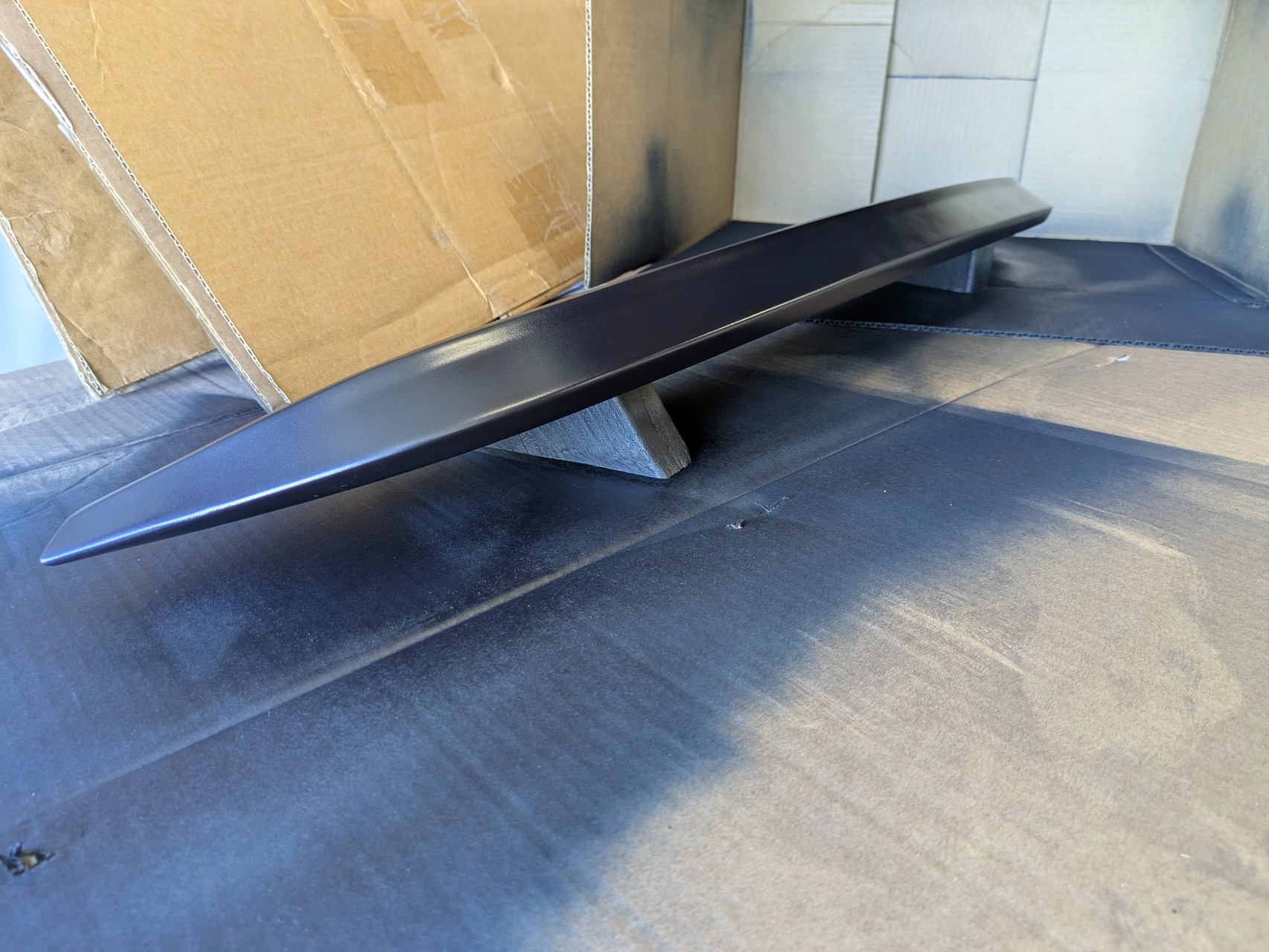

I then moved on to a sandable primer, and repeated sanding smooth with a 500 and then 800 grit. Primed again and let completely harden for 24 hours and worked the scoops and wing with 1000 grit until the surface was perfect. This is why paint and body work is so expensive. Between every coat I wipe down with IPA and a fresh microfiber towel to remove any dust before applying paint.

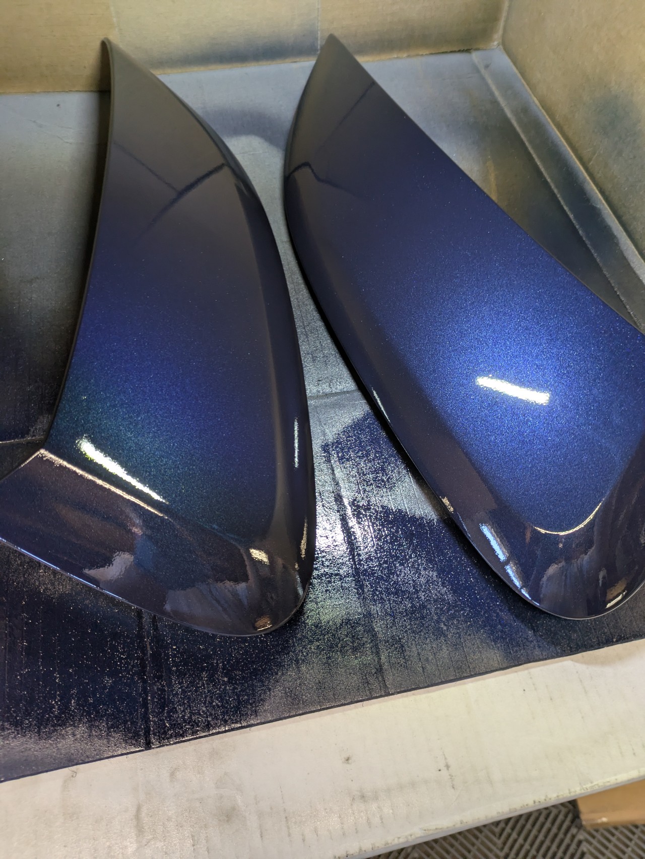

I've had great success with paintmatch cans from "ScratchesHappen" on Amazon. The paint match is perfect and obviously your results may vary here. They include a card to test, and if it's off they will work with you to nail it. Night Blue Metallic looks matte and almost black when done, but in the sun all your little mistakes will be revealed. :shock:

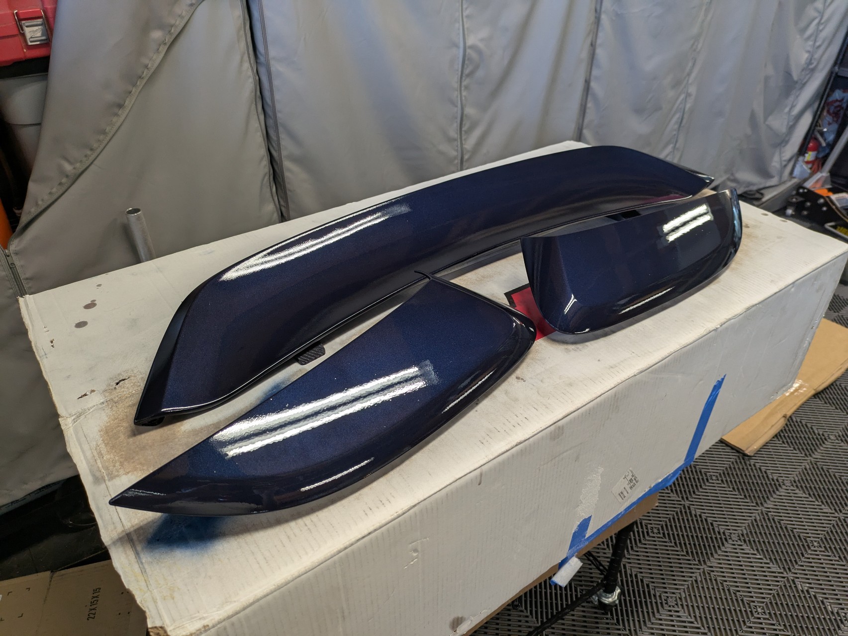

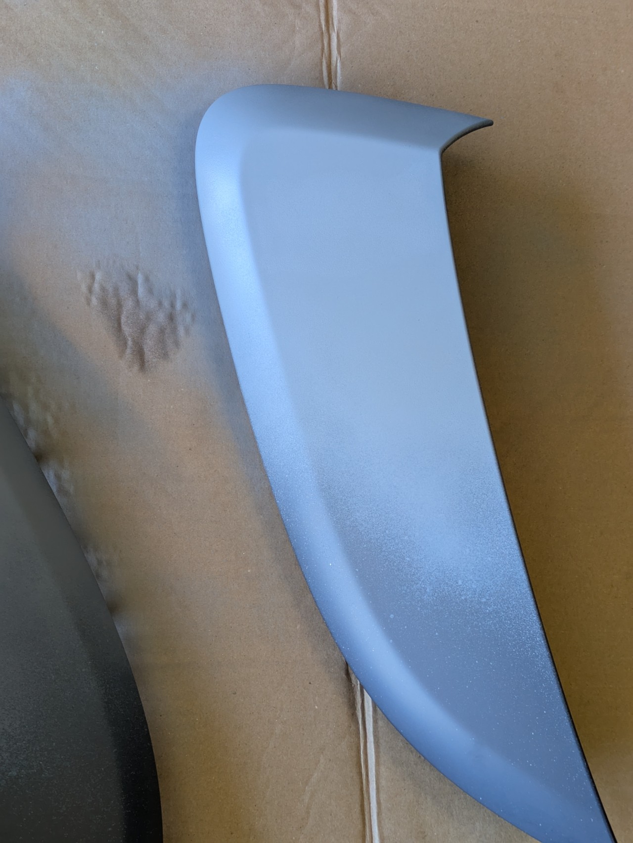

The duck tail spoiler required another round of paint and wet sanding, and took a lot more paint initially than expected. This is an aftermarket fiberglass one, and soaked up paint like a pine board. At $50 a can for custom mixed paint, consider that you would need to have access to a paint shop with a computer mixer, so IMO it's a pretty good deal. I would have used less if I was a little more careful getting blemishes out with cheaper primer. I am wet sanding after every coat of paint. With dry time this is DAYS of work - at a couple hours a day. You're not in a hurry right? Sandable primer dries pretty fast, but the more you allow it to harden the easier it is to sand by not filling your sandpaper with sticky paint.

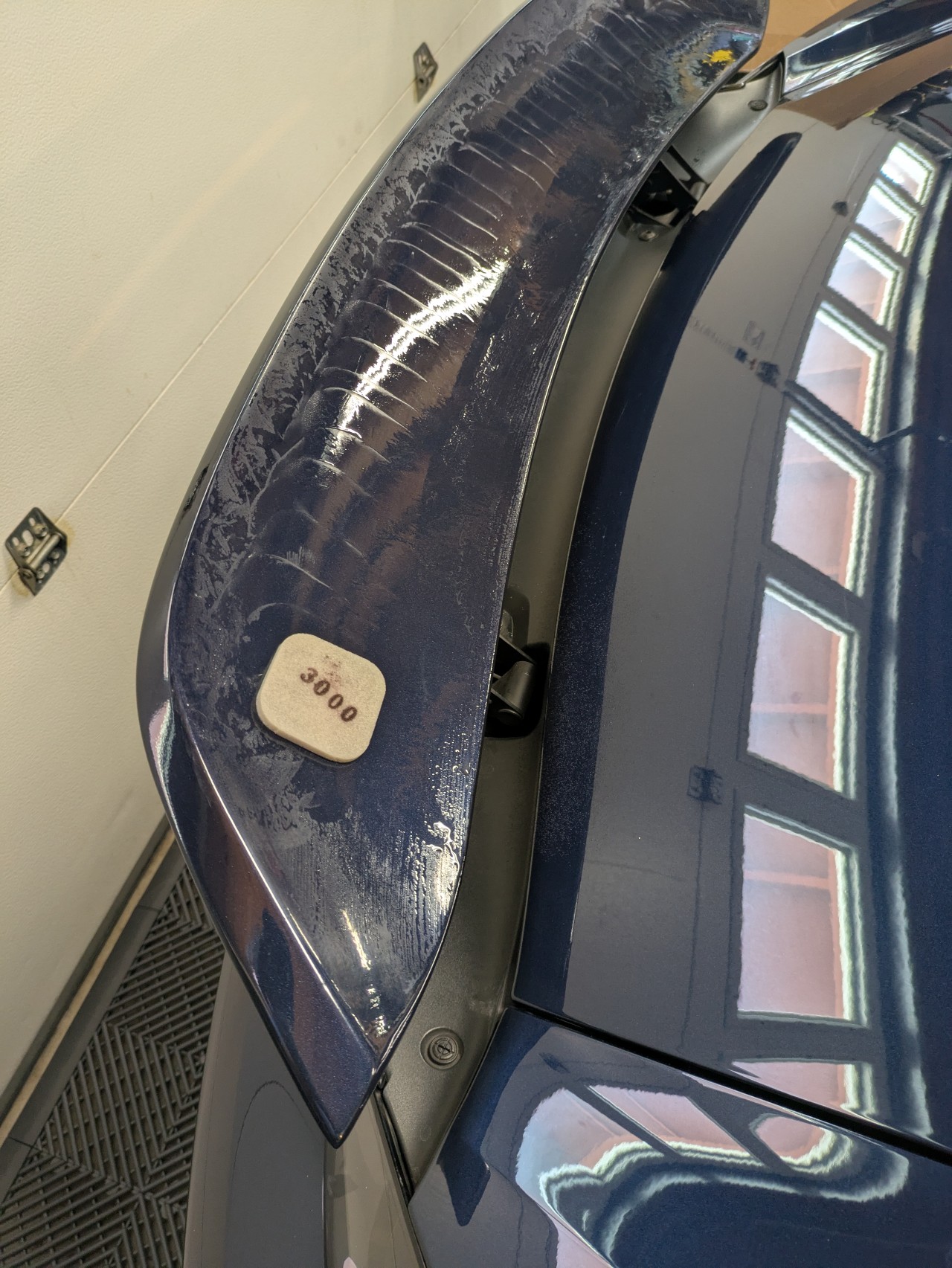

Clear coat time! I ordered a second can of 2 part clear after I ran out of mixed paint on the wing. I knew I'd need it.

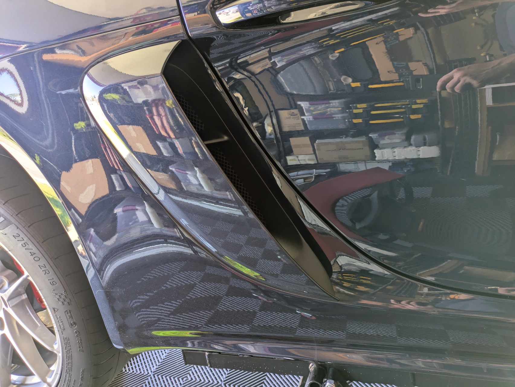

I start with a light coat to get the paint to stick and then roll on a heavy coat in a steady smooth motion to get that gloss finish. Wait 2 minutes and then repeat. There are going to be small imperfections and specs. Don't worry, you can wet sand this too. For the clear I start with a 1500 to knock down the spots, and 2000 to get it smooth.
Cut and polish. Cut and polish. Repeat again. I needed more effort on the wing as the orange peel was a bit more obvious. I'm glad I did two separate heavy coats of clear on it. This allowed me to sand on the car without fear that I'd wear through the remaining clear, and work on it with a 6" random orbital polisher after with a cut compound followed with a polish.
I'm proud of the results. I had tried some "aftermarket" scoops last year, but they were a disaster. The OEM scoops come with primer on them, so they took way less time even with the bondo filler. I wanted them for grabbing more air at the track and to give me an OEM+ look. I hope this encourages some of you who were on the fence about trying more paint work.

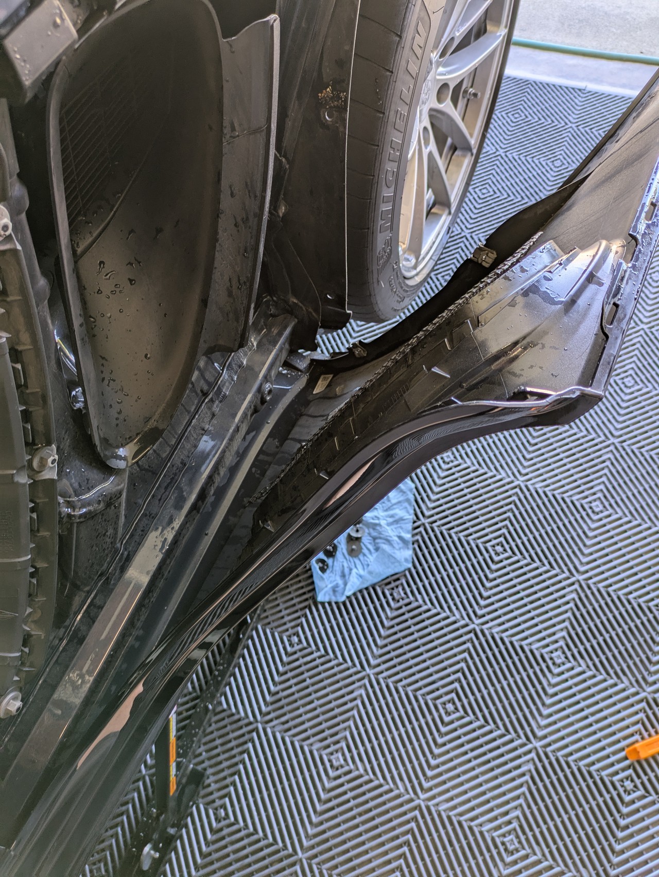

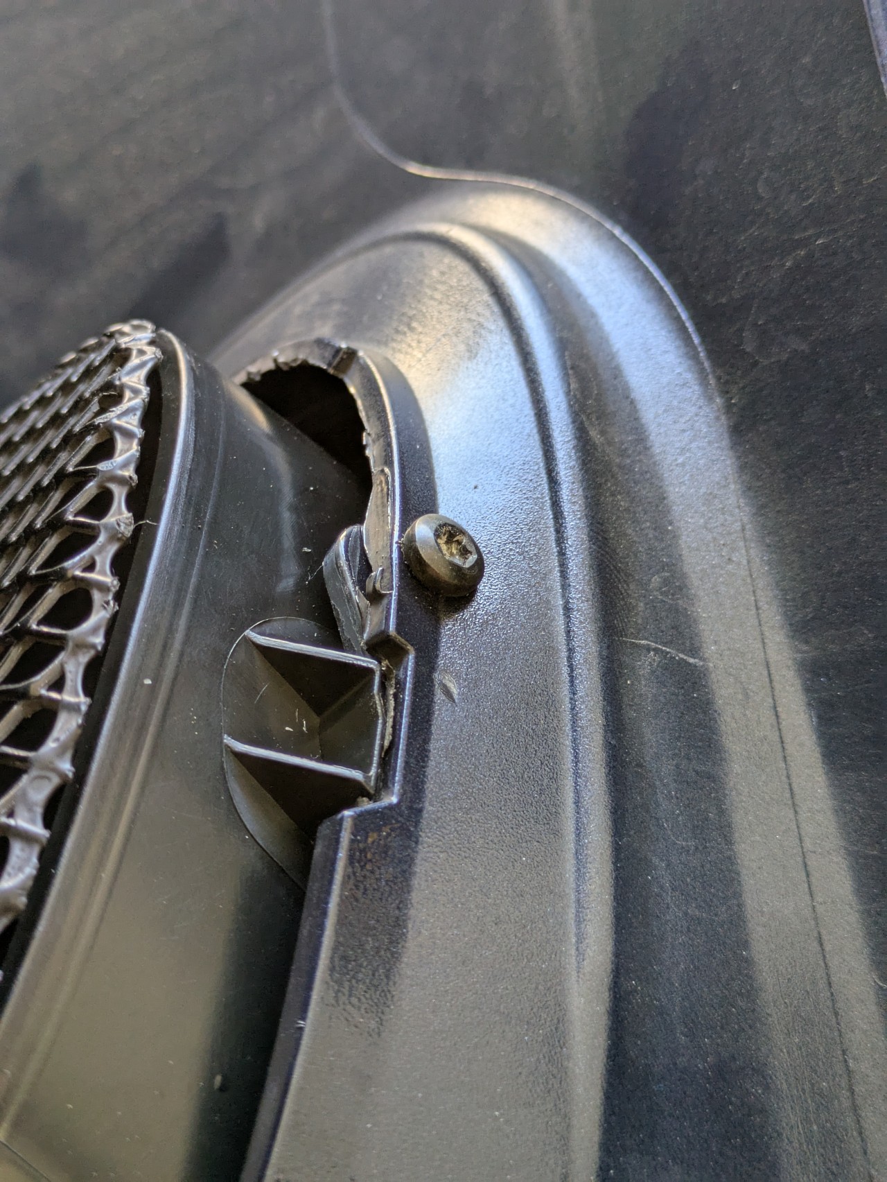

Nice work. How involved was the install of the side scoops?
webkris
Posts: 13
Joined: Tue Jun 03, 2025 2:33 pm
Has thanked: 18 times
Been thanked: 27 times
jkat wrote: Tue Aug 26, 2025 8:52 am Nice work. How involved was the install of the side scoops?
Thanks!

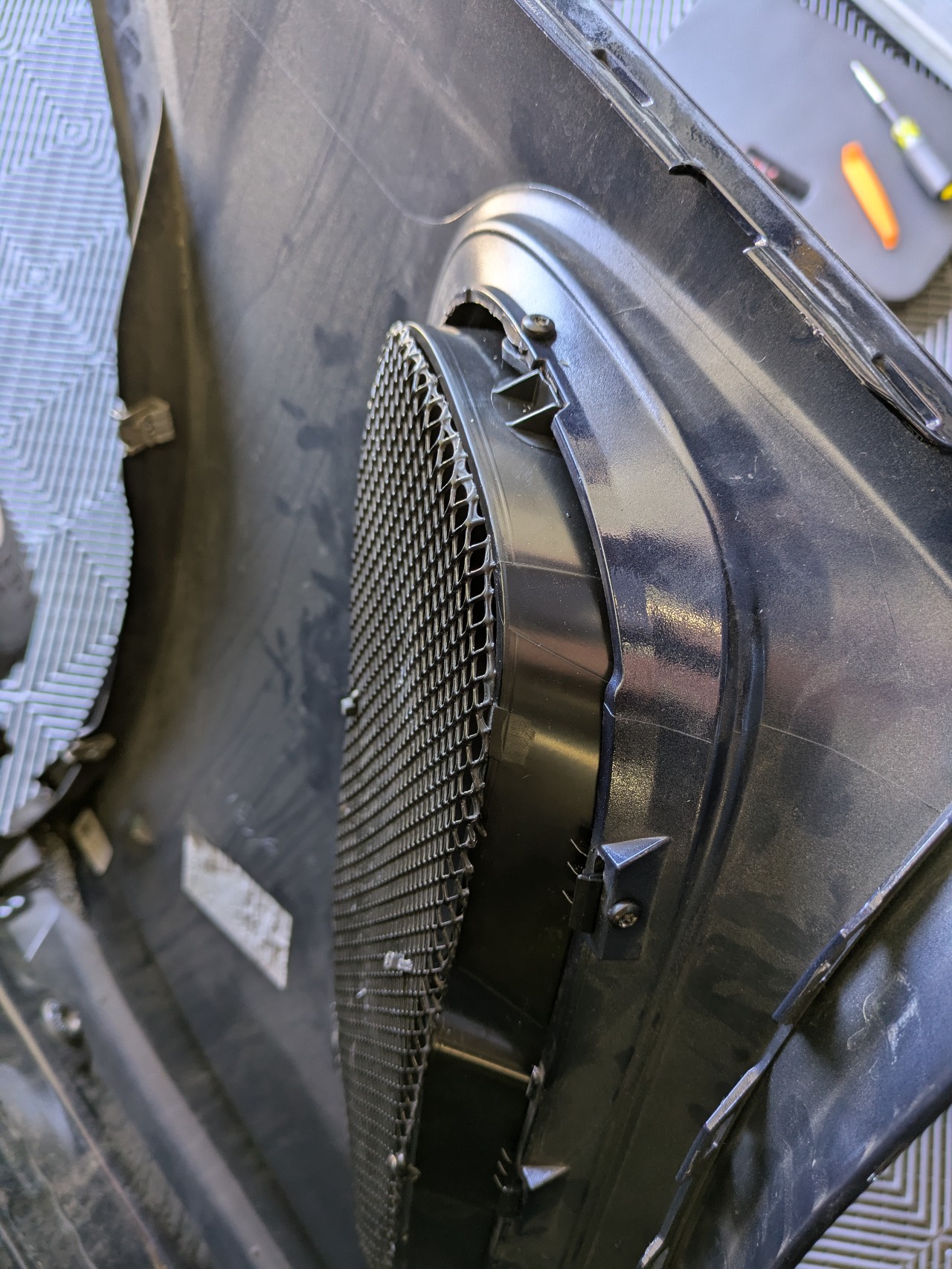

If you undo the 4 torx screws from the rear fender and the ~8 plastic clips under the sill plate and under the car, you can peel back the side skirts very easily. This way you can make absolutely sure that scoop is not coming out. The scoop and the black plastic clip together to form the one piece that snaps in perfectly.
I'm not sure where the factory installs screws, but this made the most sense to me. The front one locks in the black plastic and the top grabs the scoop plastic itself. Along with 4 pieces of VHB tape to secure it. You can also see I re-attached my grill protection which fit exactly like the stock "two bar" grill.

Thank you. I've been thinking of doing the same mod to get more air into the airbox and intercooler on track.
