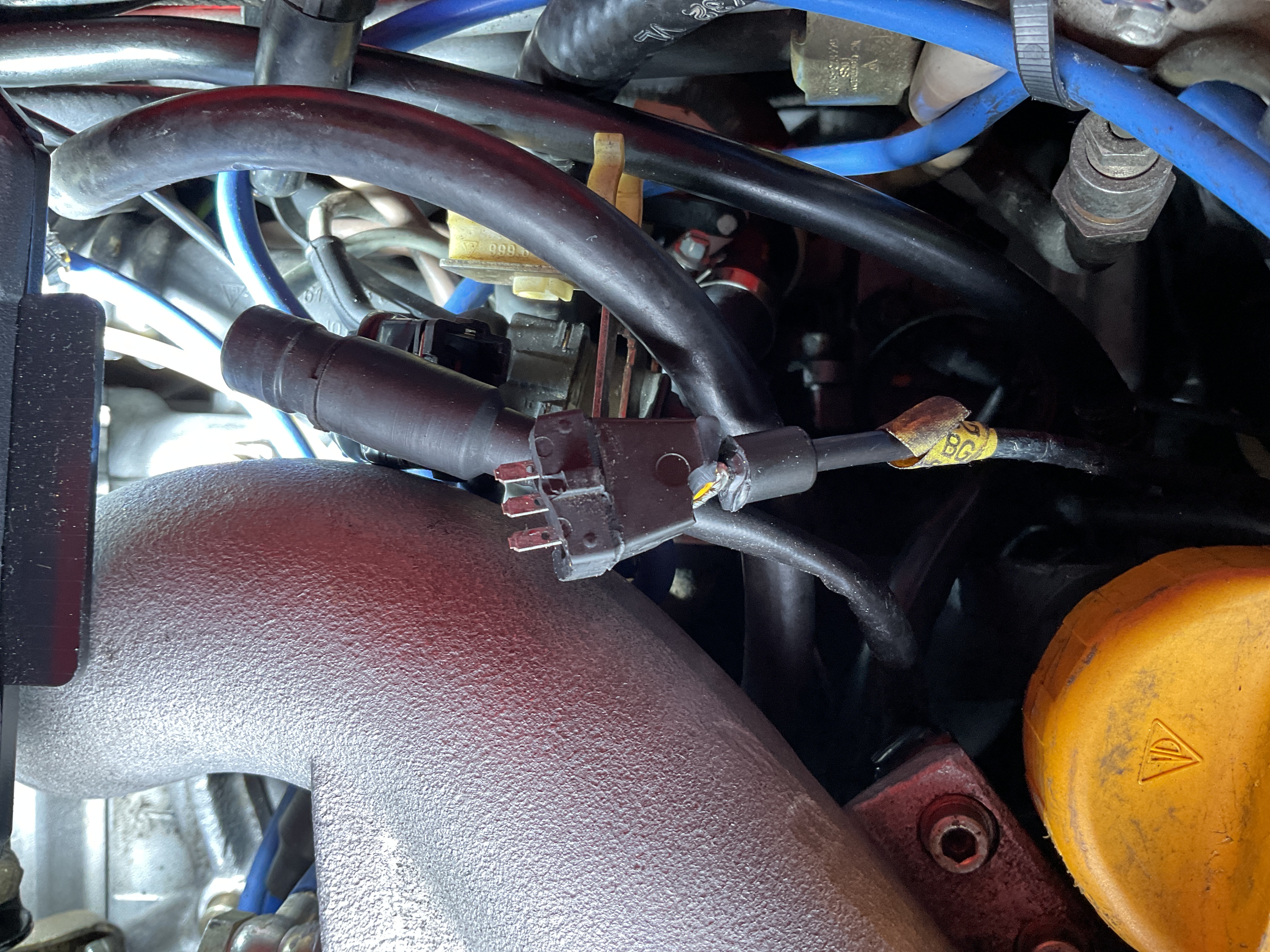

I broke down couple weeks ago and of all places near Crazy Ed’s neighborhood. Had the car towed home and after some troubleshooting I found my Reference Sensor cables all cracked and fell apart as I touched them. I’ll need to replace these first before I can move on.
Is there any videos or step by step tutorials on this topic? After all
These years of ownership this will be my first time tackling it.
Much obliged

Sorry to hear that happened. :( They're not cheap, and it takes some effort to install, but you can't go wrong with a new Kroon harness. See my install thread here. When I replaced mine, I was horrified to see how many places where the old factory harness was frayed or on its last legs....
If you would rather just do a patch harness, here are Lindsey's instructions.
Or if you want to try your hand at replacing just the connectors on the end of the factory wires, you can get part numbers and info on the connectors here.

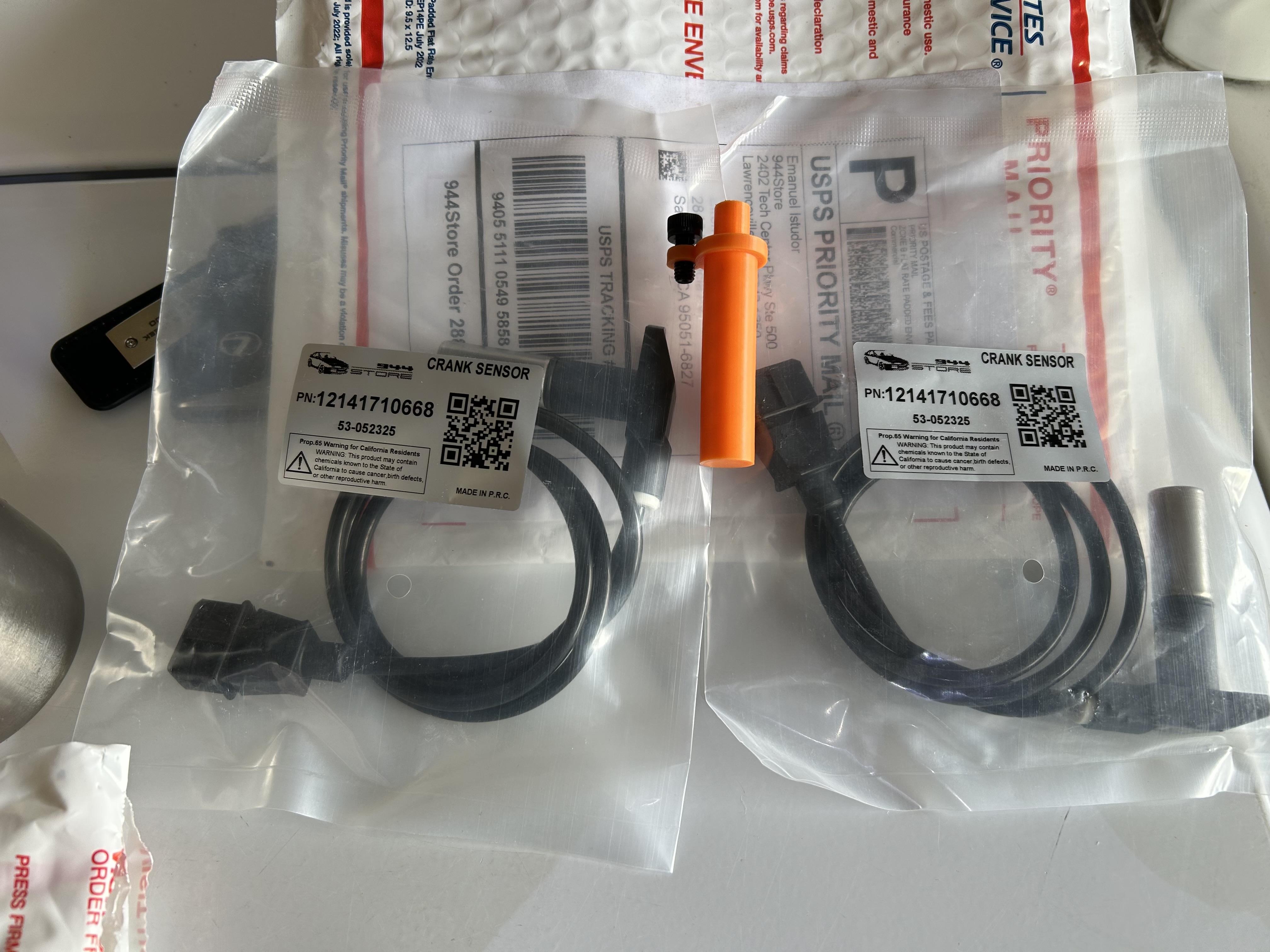

Thankfully the Harness end of the Reference sensor Connector is in good shape. I purchased two new sensors.
What I’m worried about is if I remove the old ones will I need to gap the new ones when I install them.
Or
Will the gap remain intact if I don’t loosen the adjustment bolts

Sorry for confusing you Tom.
I purchased new sensors. The harness connectors on them fell apart. The plastic ends just crumbled. I need to replace them.

I got it installed. I’m hoping I didn’t disturb the gap since I only pulled the sensors straight out with no issue.
Tried to start it but my battery is dead. I have it on a charger now so I’ll wait about an hour or two.
