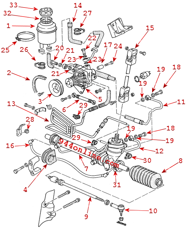

I'm not sure what you mean by " bushing with the spring that pushes on the rack" - but are you sure it's not just the mounting bushings? (#4 in the picture above). They are notorious for going soft and disintegrating from oil and power steering leaks from above, and are often mistaken for loose tie rods.

The "rack" in the rack-and-pinion is one piece, so it sounds really off that you have longitudinal play in the housing but one side only.
You can use a dial indicator to measure the actual play between the tie rod and the rack housing, then the tie rod and the rack itself with the boot slid off. Best way to isolate play in the inner tie rod.
The rack itself can move radially in the housing when the end bushings are worn. The dial indicator is the detective tool of choice once again, looking for relative movement as the rack tries to move initially when pressure from the pinion changes.
In the parts diagram, there's a cover with a spring and a preload pad that work to keep the pinion fully engaged with the teeth on the rack itself. Look at the C in .com text in the image, two hex cap screws over the cover. Part of that spring duty includes loading the rack in the end bushings, making it a little bit tougher to accurately measure radial wear in the end bushings. The steering and tie rod angles push harder than you might trying to just check them by hand. Your testing and measuring would be best done with the tires on ramps or pads so the suspension is loaded as normal
