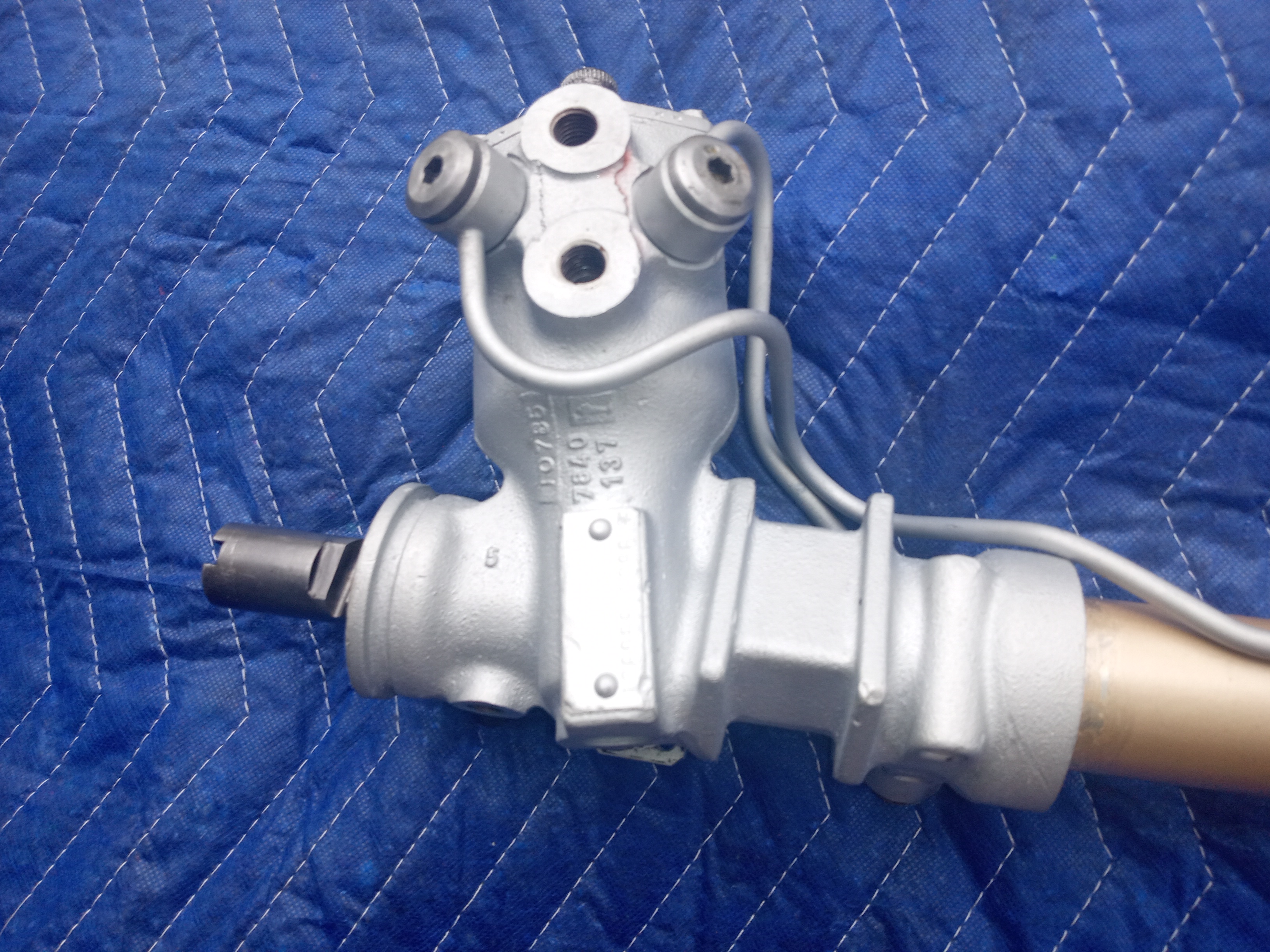

I wonder if one of the metal lines or banjo fittings on the rack are bad/pinched...????
Also, confirm you have the lines properly connected in the right location... more than one person has installed some the lines in the wrong position. Check the two lines that connect to the two open ports in this pic... If you have them backwards, you will surely have all the issues you are experiencing.

Thanks for the suggestion - but I had them correct - pressure hose on bottom and return on top of the gear housing. The other 2 metal hoses matched pictures I've see online.
I am pulling all the hoses and will have them checked/rebuilt to rule those out. No visible pinches in the rack metal hoses and air flows fine through them.
