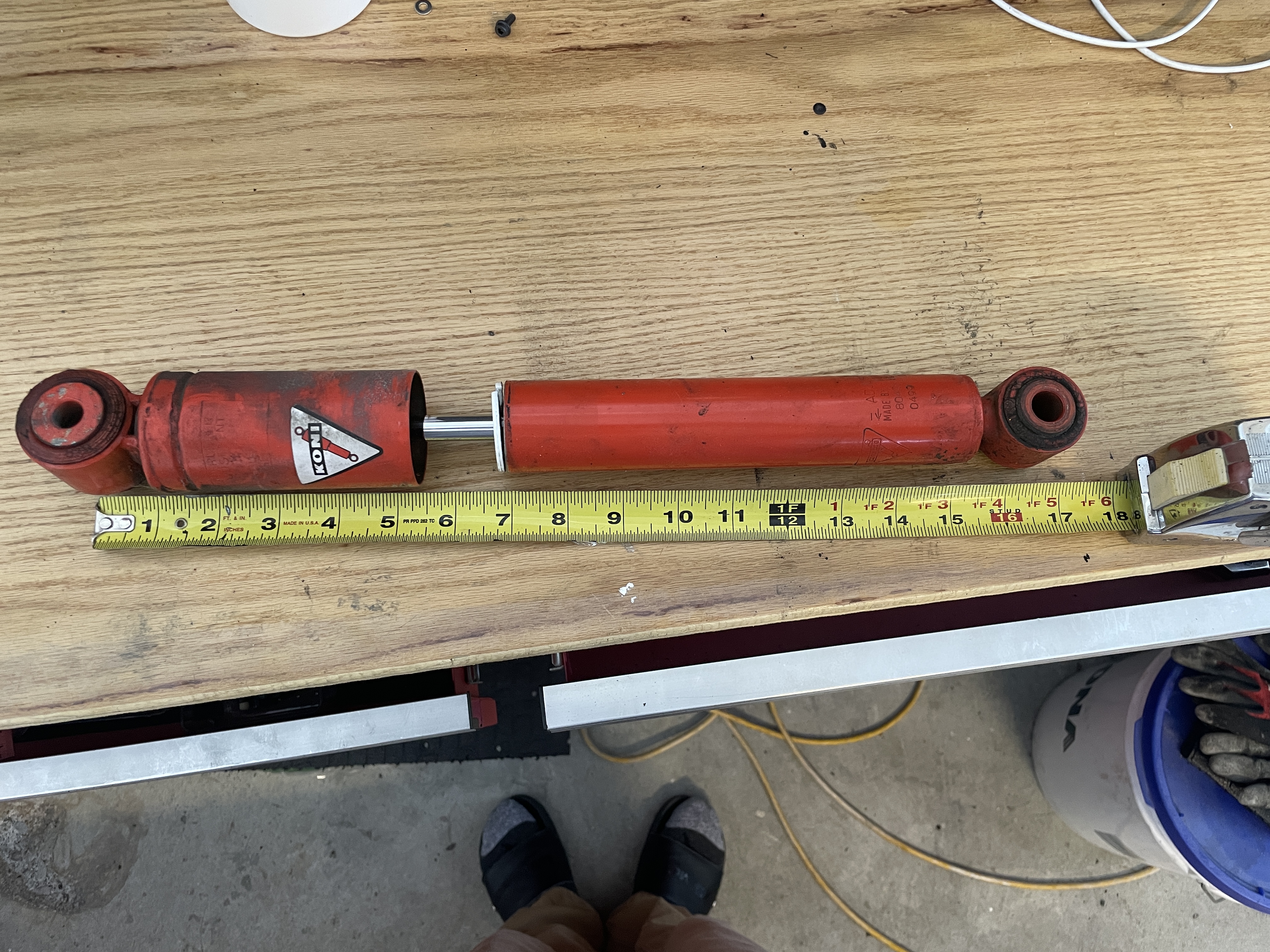

Ok I measured some older 8040 1035 sport adjustable Koni’s.
A little over 16” from bolt centre to bolt centre uncompressed
13” compressed to the bump stop.
If your car is that much lower, maybe your torsion bar as been re-indexed?

Yeah so this is all starting to make sense, the shocks new touches the foam at 14” but after jumping on it a bit the foam compresses a bit.
For what you guys are posting plus Konis email response, it seems the foam bump stop plays a part in the shock normal operation in addition to been a bump stop. Jason from Paragon also said the same.
So yeah I’m taking it on the road and see how it behaves
To close the loop on this. Took the car for a drive and the shocks are working as they should, the car is handling bumps with no issues. Now to the next project, need to look into bushings.
