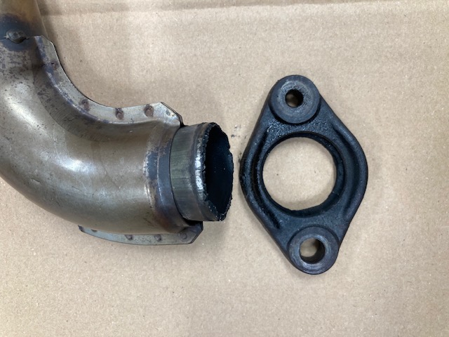

My 1&4 manifold failed at the point where the tube enters the flange. See photo below.
