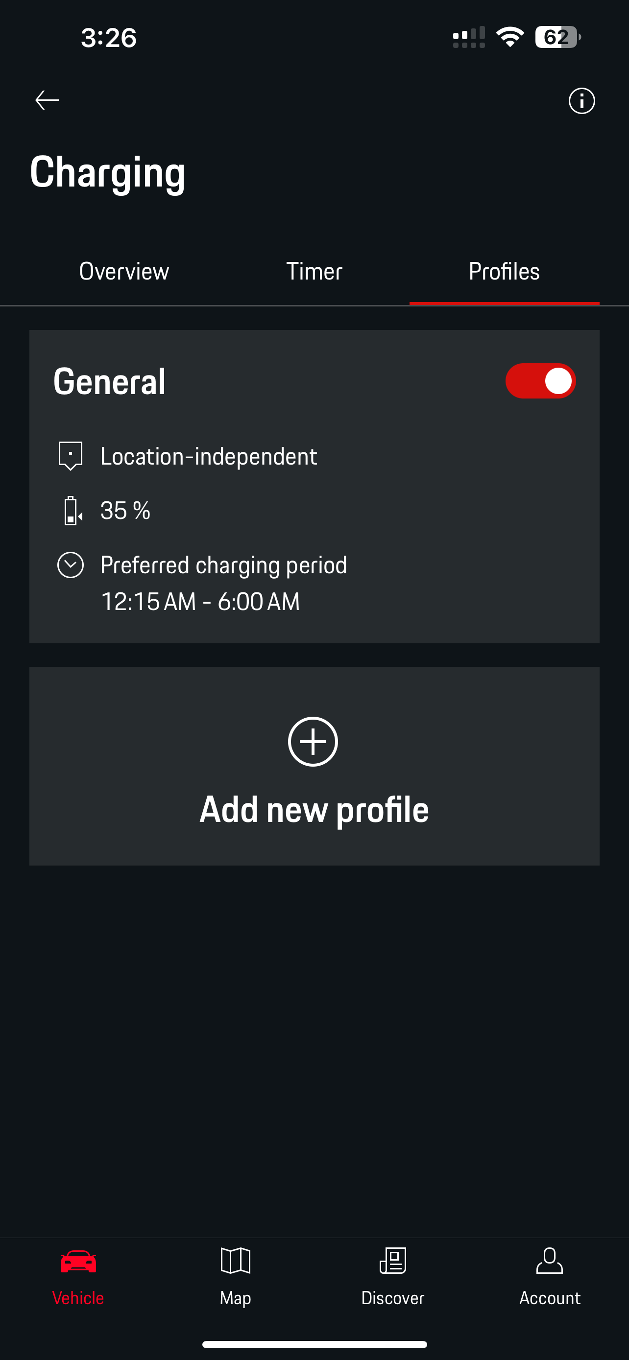

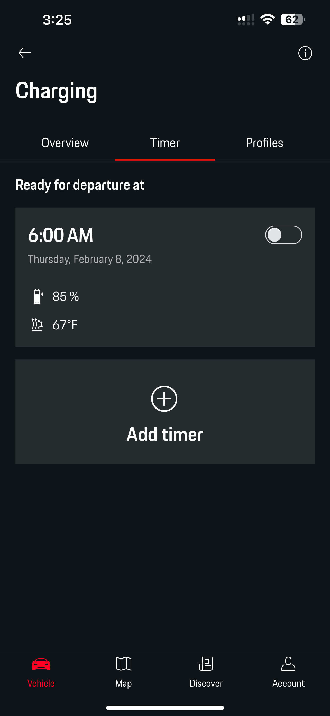

I have a 2023 GTS ST and I have a ChargePoint charger. The utility company prefers the Chatgepoint to work from midnight to 6 am. By setting the Profile to 12:15 am to 6 am, the car will charge overnight. See attached screen shots from MyPorsche app. The timer shows 85%. But the car still charges up to 100%. What setting am I missing to have it stop at 85%?

I have a chargepoint and have been using it without issue for the last two years. Your issue is with your timer and profile. The way to fix it is to, disable the timer and set the profile minimum charge to be 85%. That will fix it. Porsche does not make it clear how the two options work.
I only use the timer when I'm planning a long trip that I want the car to be at 100%.

You need to set "minimum charge to be 85%" tike toddinmind says, and enable/tick the Optimized charging option.
At least my '22 Taycan is like that.

KCG_981_Taycan wrote: Wed Feb 07, 2024 1:29 pm I have a 2023 GTS ST and I have a ChargePoint charger. The utility company prefers the Chatgepoint to work from midnight to 6 am. By setting the Profile to 12:15 am to 6 am, the car will charge overnight. See attached screen shots from MyPorsche app. The timer shows 85%. But the car still charges up to 100%. What setting am I missing to have it stop at 85%?
Your 6am Timer is turned Off in this screenshot, if you didn’t notice.
