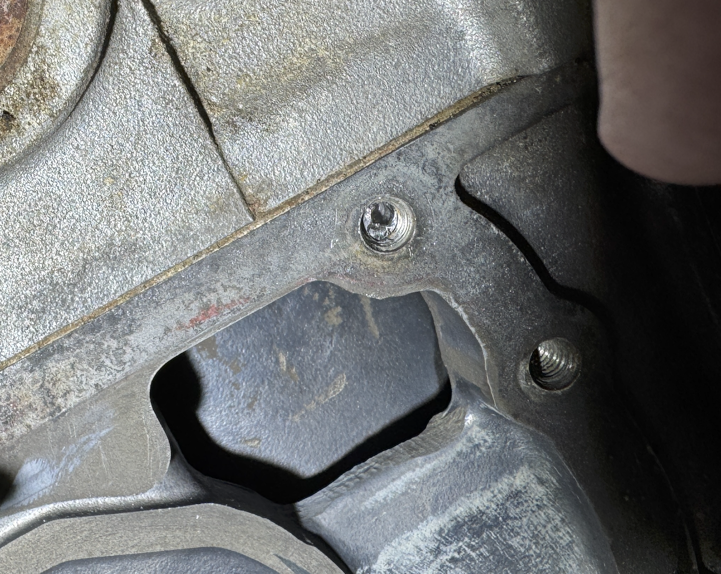

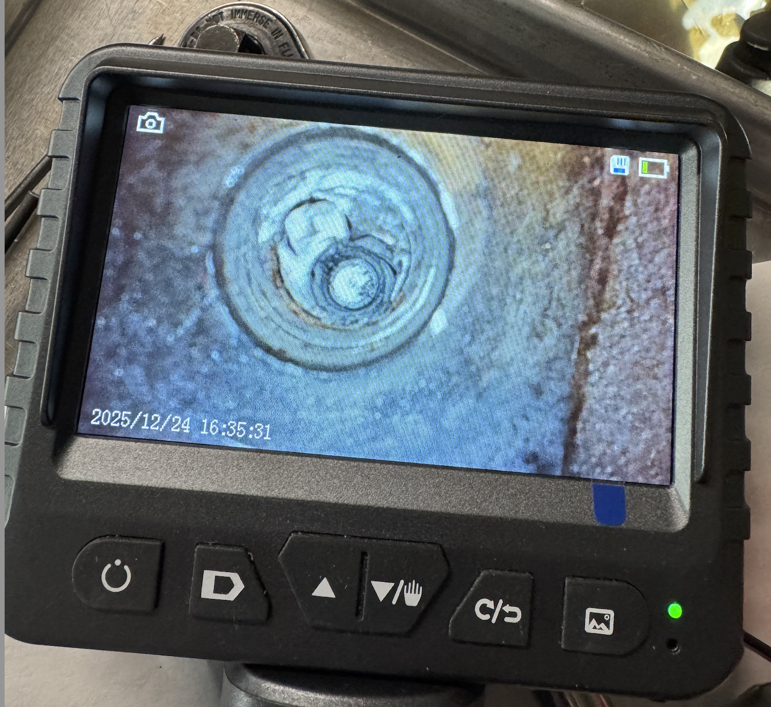

I used one of my left hand cobalt bits and have a parallel hole drilled next to the original extractor. At that point I stopped.

AudiSport
Posts: 177
Has thanked: 5 times
Been thanked: 59 times
BTDT, drilled it out for a time-sert sleeve. https://www.timesert.com/
I've even had to do this for head studs..
Posts: 8548
Has thanked: 888 times
Been thanked: 3826 times
Yeah I think you'll have to drill that, and helicoil (or time-sert) it -- unless you can find someone local with an EDM machine. I can print you a drill jig if you want, though you'd need to get the inserts from McMaster...

Thom wrote: Sat Jan 24, 2026 1:11 am Sorry to hear that.
The last time I had to drill something really hard in a narrow place (a bearing outer race in a Ferrari engine to release the full timing cover from the block) I used a rather pricey tungsten carbide drill for my Dremel, which worked great. The difficulty here is to align the drill as to not damage the hole in the block.
Good luck.
Exactly! About a million years ago, I helped (watched) @Crazy Eddie drill out this very hole. If memory serves, he took out the radiator and condenser to get a straight shot, but otherwise did it by eye and succeeded. It was that experience that inspired my drill jig many years later. With the extractor broken off inside, this is a difficulty level B situation, so would encourage the use of the jig. The hardened extractor will push the drill bit off center without the jig. An EDM machine would be even better but probably not practical in that location. I guess you could also use a tiny little bit or diamond grinder on a dremel and grind at it. YouTube has endless 'best ways' to deal with this -- including dedicated broken ez-out kits. Of course, another option is to just forget about it, use a little extra sealant, and hope it doesn't leak. The Porsche gods might smite you, but you wouldn't be the first to get away with it.
P.s. good call on tungsten carbide --better than my cobalt suggestion. More expensive but worth it for this!
