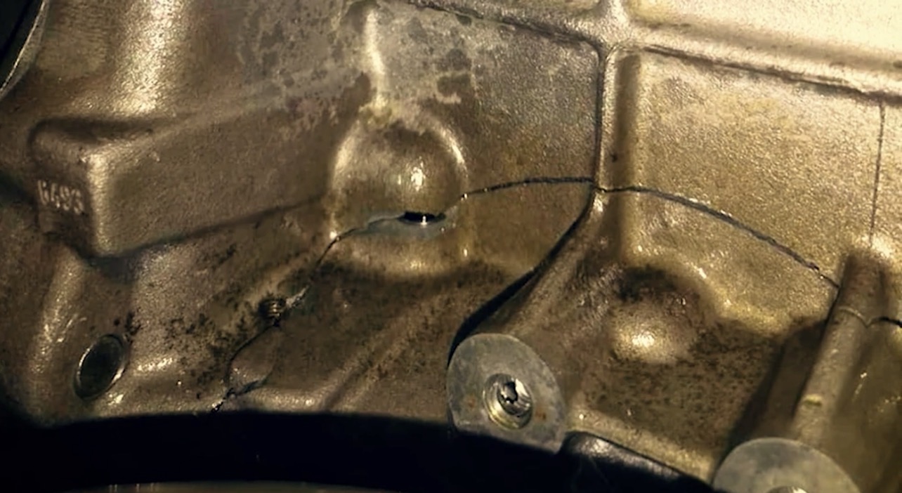

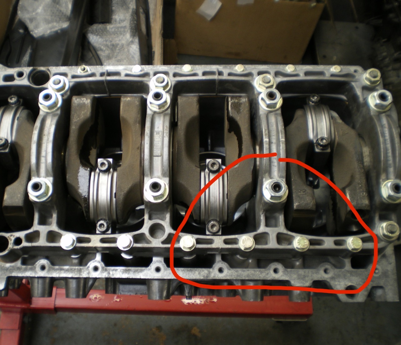

Do you have more info on that ? I heard thom speaking about a guy breaking the block at 950Nm but couldn’t find anything, did the block get reenforced ? Where did it broke exactly ? I didnt saw any 944 build with broken engine after top deck plate reenforcement and nothing at all with the resin one.Bergerac wrote: Wed Feb 11, 2026 9:04 pm Seems like most of the higher HP builds broke the block in the end

If I remember right Duke made near 950 N.m on his last dyno run before heading to World Time Attack in Sydney where the block broke as suggested by photos showing the girdle had "pulled" one or two bottom main studs out. The material in the block around the main studs cracked. It is also possible he turned up the boost to be as competitive as possible and we won't know for sure how much torque the engine was making when the block broke.
