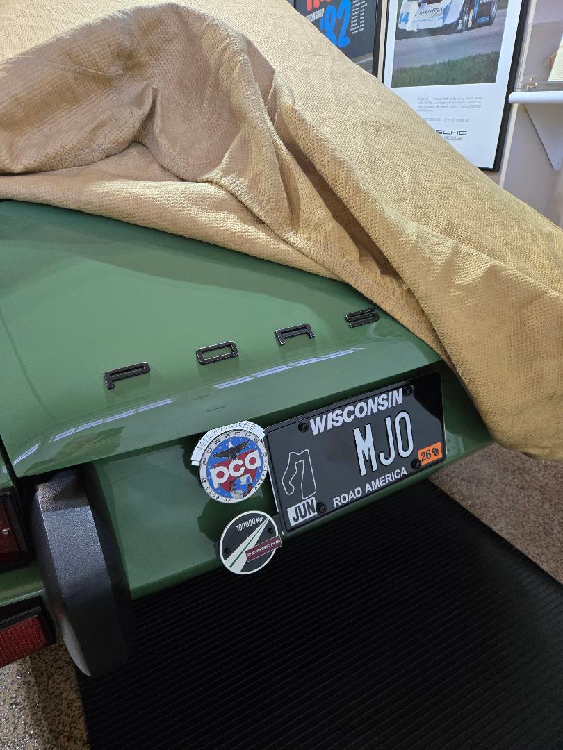

Porsche License Plate Badge Mount (Double)
Porsche License Plate Badge Mount.jpg (143.17 KiB) Viewed 443 times

Wish there was more space on a 964 bumper around the license plate...I did consider that as a location. I'll double check mine again (not at home), but if I recall I only have maybe 2-3 inches to the sides of the plate..similar to:
