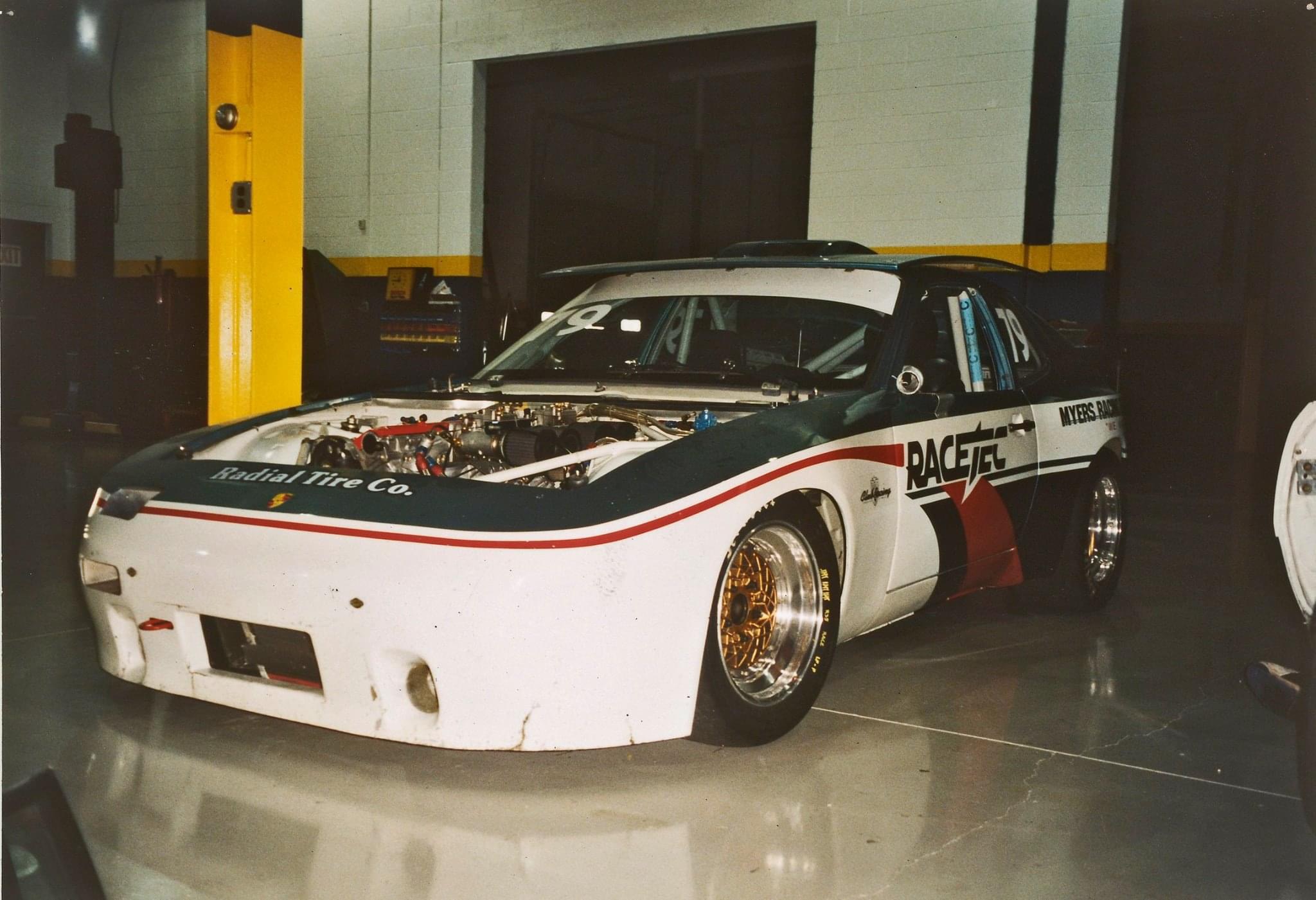

Back in the day (okay, maybe it was WAY back), I ran a 924 D/P (933) chassis with a 2.8L 4V NA engine very successfully in PCA Racing and local PCA time trials. At the time, there were no minimum weights and classification was by displacement only. My car weighed in a 1970 lbs. wet sans driver and was a consistent race winner and frequently overall FTD in timed events. The light weight configuration not only allowed it to be quick, but also enormously fun to drive and be be very easy on mechanical components such as brakes, suspension, gearbox and such.

Porsche Weissach gets all the credit for the lightweight 924 D/Production (933) chassis. Only 16 were built to bring awareness to the new front engine model and Porsche put serious effort into the program. Here's lots of info on the cars and the program: https://www.stuttcars.com/wp-content/up ... uction.pdf
My car was one of those chassis. I put lots of effort into maintaining the very low weight as I upgraded to a 944 4V NA engine, 924T driveline, bodywork to accommodate wider rubber, and ultimately aero. It embarrassed a lot of 911's and turbo cars back in the day.

I had several engines in this car over the years. I began with a 2.5L 944 2V on carbs, then went to a 2.7 4V and ultimately to a 2.8L which was the class limit at the time. I ran the c/r around 13.5 and dug up some old dyno sheets which showed 317fwhp. This was in 2001.333pg333 wrote: Sun Feb 22, 2026 7:10 pmThat's an interesting article Michael. I hadn't heard of these or at least in any detail. That must have been fun developing and racing the car. Especially when you upgraded to the 944 16v motor. What sort of hp were you pulling out of that? Must have been a noticeable jump from the 2lt 8v version. Do you recall the compression ratios?michaelmount123 wrote: Sun Feb 22, 2026 2:46 pm Porsche Weissach gets all the credit for the lightweight 924 D/Production (933) chassis. Only 16 were built to bring awareness to the new front engine model and Porsche put serious effort into the program. Here's lots of info on the cars and the program: https://www.stuttcars.com/wp-content/up ... uction.pdf

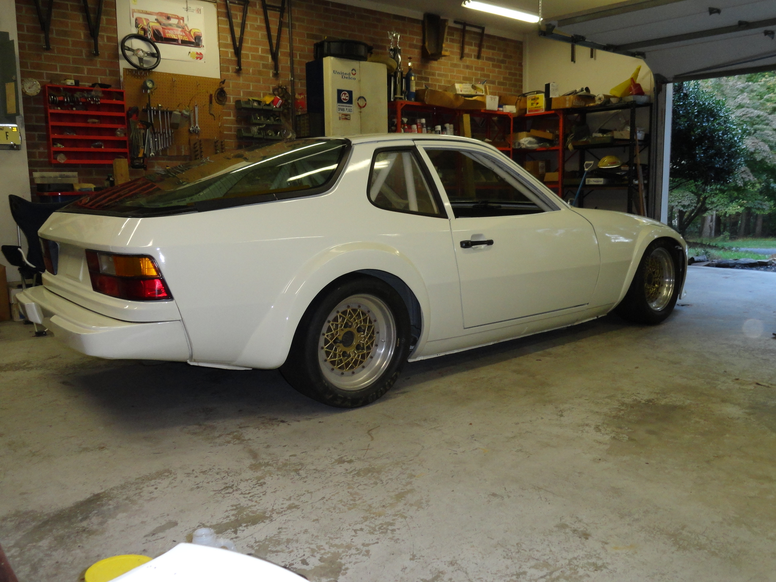

Here's a 933 assembled, but never run:
$150-$200k is some serious money right there! Are there vintage racing classes where these are still highly competitive? Otherwise that's 'real fan' money they're asking. Bet they were a ton of fun to drive. Very light and responsive with some decent power to weight ratio going on there.
