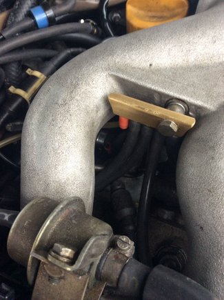

zooklm1 wrote: Thu Feb 26, 2026 5:12 pmYou could definitely use that fitting to install a gauge on the rail.
Indeed you can...
https://rennlist.com/forums/924-931-944 ... gauge.html
