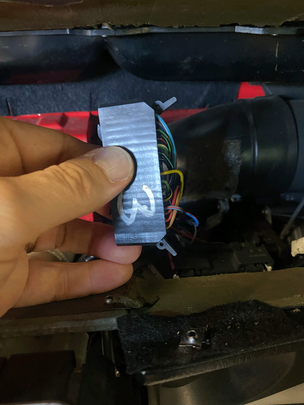

Hard to say not seeing what he has going on... but I usually do this.
1. Remove dash trim and the 4 screws that secure the cluster.
2. From drivers side, angle cluster, remove connection. Only 1 on this side. Brittle!
3. From passenger side, angle cluster, remove connections. 2 on this side. Brittle!
4. With the cluster disconnected and angled on the passenger side, tilt it backwards and it should just slide out from that side.
I didn't say remove the steering wheel, but sausage fingers may require that to get the thing to slide out... So with that...
Optional 3.5: Remove the steering wheel...
The 968 has airbags yeah? So that might suck for the tech.
Like others have said, send it out for rebuild, "they" (a couple options) do a great job! OR, just buy a working cluster off eBay/944 barn/Plyhammer, et al.

From your first post, it sounds like your fuel and temp gauge may be dead, and separately your oil sender is bad. Could be lots of causes, but if I had to handicap the cause(s) that would be my first guess. I'd ask the tech to check resistance from the G terminal of the oil sender to ground with the motor running. There's a good chance yours is a direct short to ground. If so, it needs to be replaced in order for any gauge to work -- factory or aftermarket! (In other words, until you figure out if your problems are caused by bad gauges --or by the signals going to these gauges-- buying new universal/aftermarket gauges could be just a waste of time and money.)
I don't really know what tab your tech is hung up on. There shouldn't be any tab? Maybe a picture would help us understand. With the steering wheel off, he just needs to remove the big black vent trim surround the cluster, the 4 screws holding the cluster in place, and the three edge connectors behind the cluster. That should be it, unless the 968 has something else this 944 guy isn't familiar with?
If you are up for it, with the cluster out of the car, I'm sure we could guide you through testing each of the non-working gauges from the comfort of your kitchen table while sipping hot chocolate.
Just a matter of knowing which fingers on which edge connectors drive the gauges, and what to feed them to test. A 9 volt battery, a few alligator clips, and maybe a resistor or two should do it,
if the gauges themself are bad, they are easy to pop in and out of the cluster. If the gauges are good, then we'd need to see why they aren't getting the signals they need.
