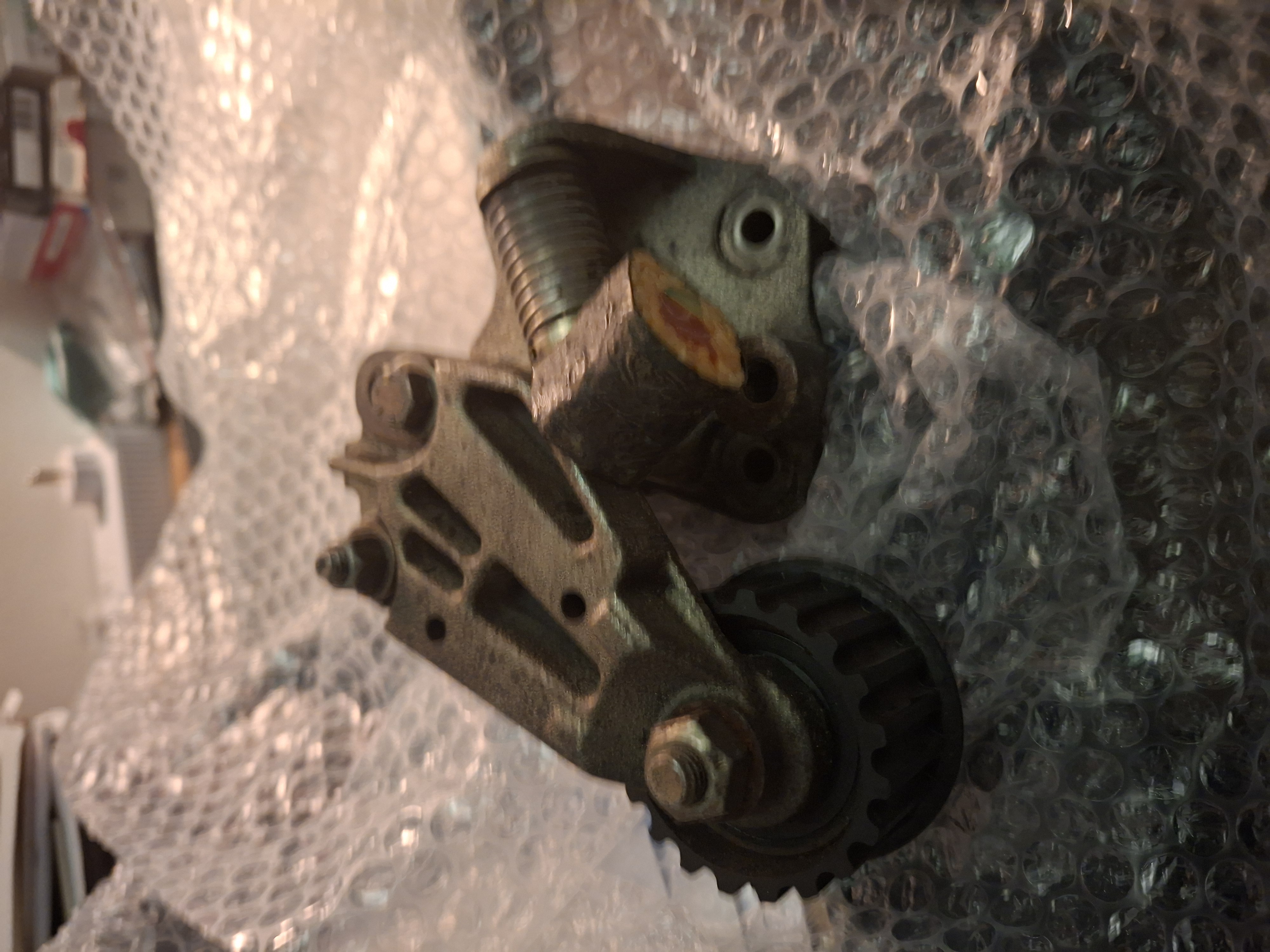

Been thanked: 10 times
Here's the heli-coil repaired alloy one i returned to the seller.

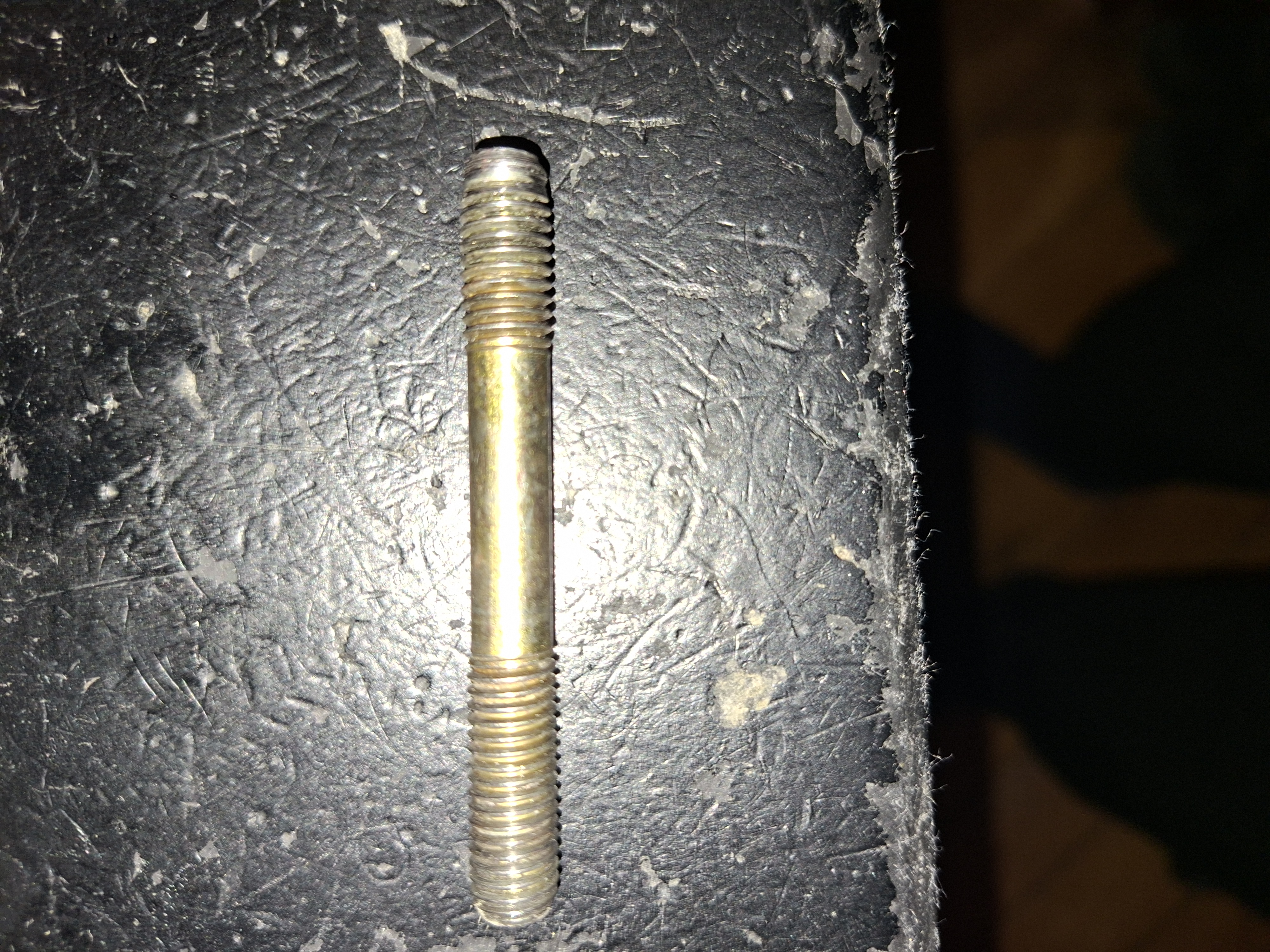

The stripped stud and a photo of the good side of the stud screwed in from the back, showing the heli-coil was not straight. The heli-coil was inserted from the back, and the tang was removed, but it wouldn't thread properly from the front side, so it looks like a previous owner/repairer just hammered the stud in until it stuck. When I got it, it was doing the "bobble thing" you described in your Wall of Shame post.
