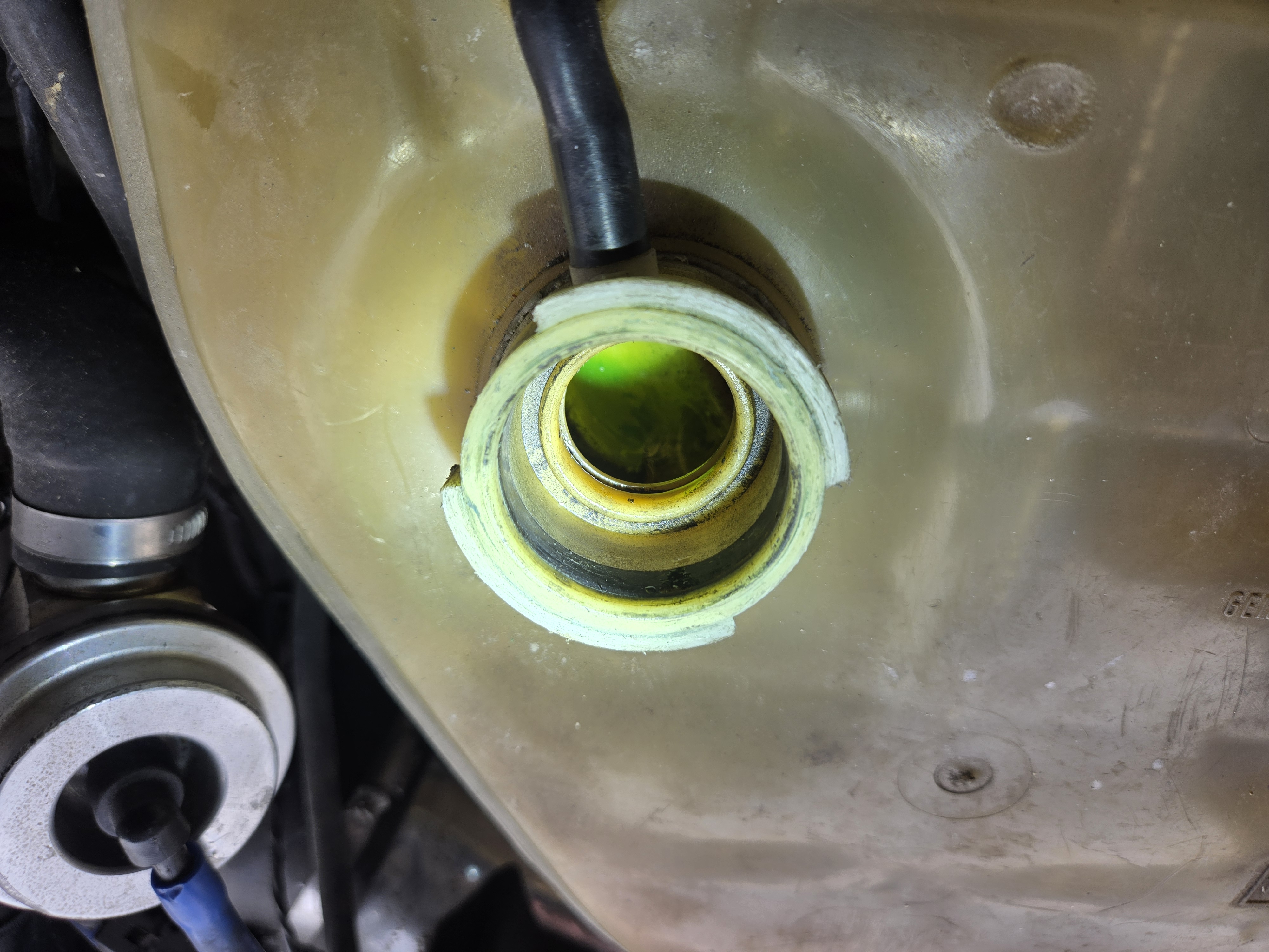

Took some time to look over the car in the storage unit over the past weekend. Everything else has been removed from storage except for the car. Oil level was checked (cold) and is right between min. and max. and still shows relatively clean. Still due for a change before running the car.
It looks like the coolant reservoir is empty. There are no signs of leaks under the car or in the engine bay, so there must be a very small leak somewhere bleeding coolant over a long period of time. No way of knowing at what time during the 1.5 years the car has sat the coolant all escaped.
Once the weather stays above freezing, I will need to fil the car with mostly distilled water and some coolant and pressurize the system to find the leak. I don't want to run the risk of leaking coolant in large quantities onto the storage locker floor or bleeding into others' units.
Hopefully it is as simple as rubber hoses cracking over time due to cold storage.

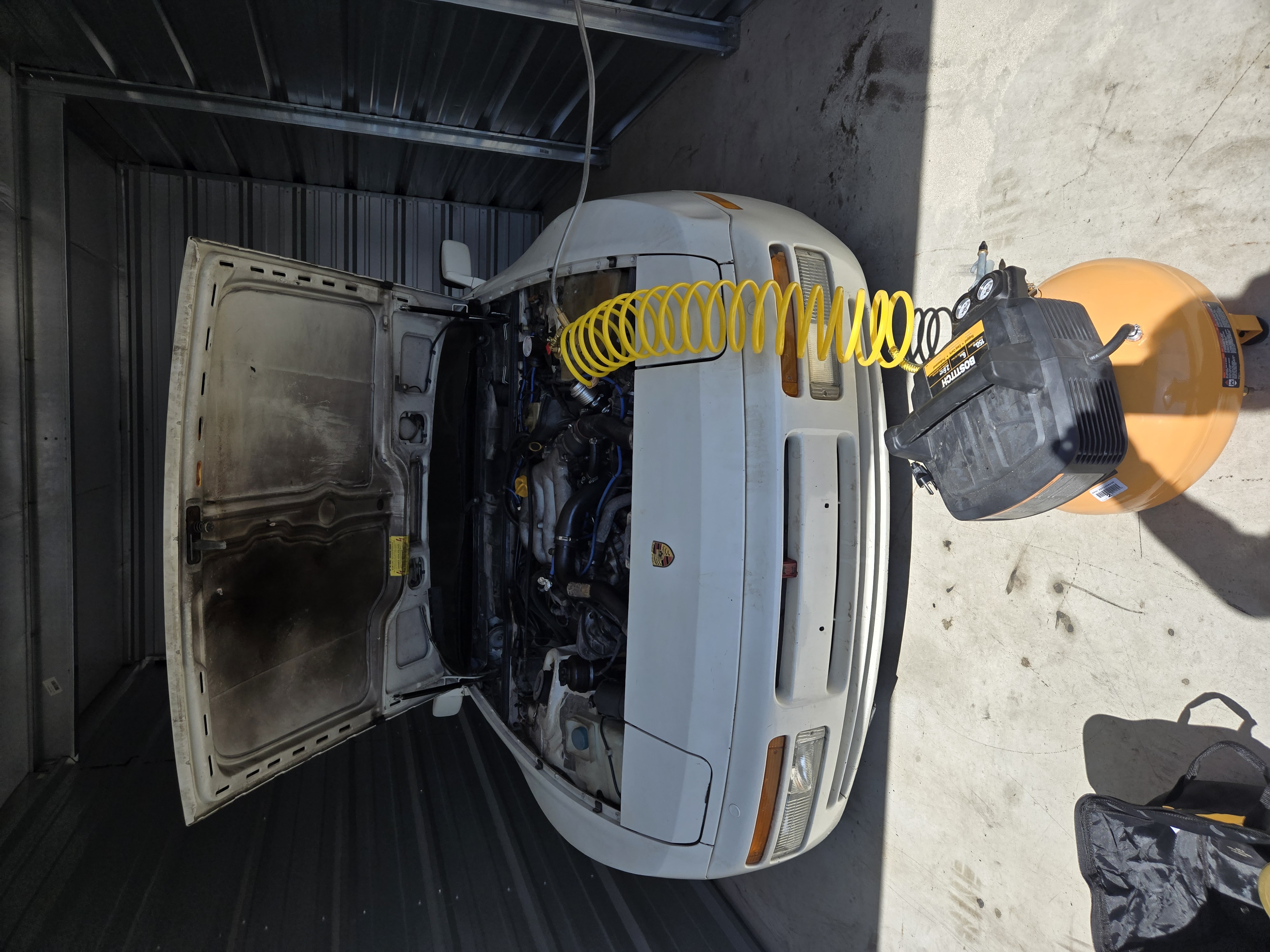

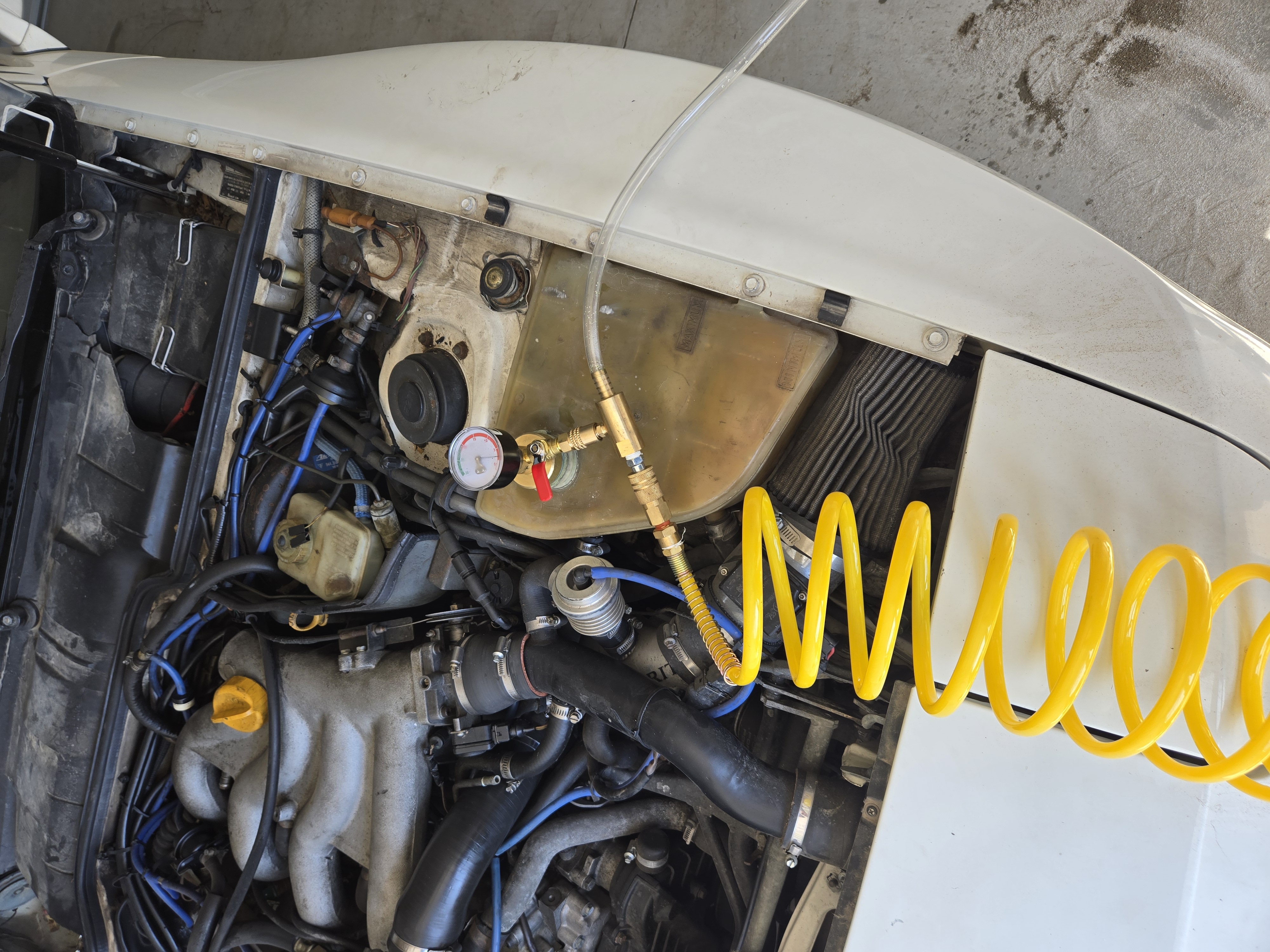

That's what I was thinking as well. I have an Airlift coolant pressure tester, so I could pull vacuum on the coolant system and spray around with soapy water to find air bubbles and where the leak is coming from.
Trouble is there is no power at the storage unit, so no way to run shop air or a compressor. Will have to get creative with an adapter from the Airlift pressure tester to a portable tire inflator.

I was able to pull a vacuum on the cooling system and saw some coolant pulled back into the overflow reservoir. The tank is tough to see through due to age, so it is difficult to see what the fluid level actually is. It also appears that the vacuum gauge on my kit is broken so I can't confirm there are leaks but didn't hear any air escaping or see any pooling or leaks in the engine bay or under the car. I'll pull vacuum on the system again once I get the replacement gauge. Hopefully the 6-gallon air tank can hold enough pressure to pull a vacuum on the system to 25psi.

Meine44 wrote: Sat Mar 28, 2026 10:04 am I was able to pull a vacuum on the cooling system and saw some coolant pulled back into the overflow reservoir.
Just to confirm/clarify, are you pulling a vacuum or pressurizing your coolant system? If pulling vacuum, then soapy water won't do you any good to find leaks because you're not pushing any air out to create bubbles. Also, it is pulling on the seals in the wrong direction. I've used a coolant/radiator pressurizing tool with good success. I combined it with UV dye in the coolant to help track down leaks. Ended up being as simple as tightening down a few hose clamps more than I would have expected.

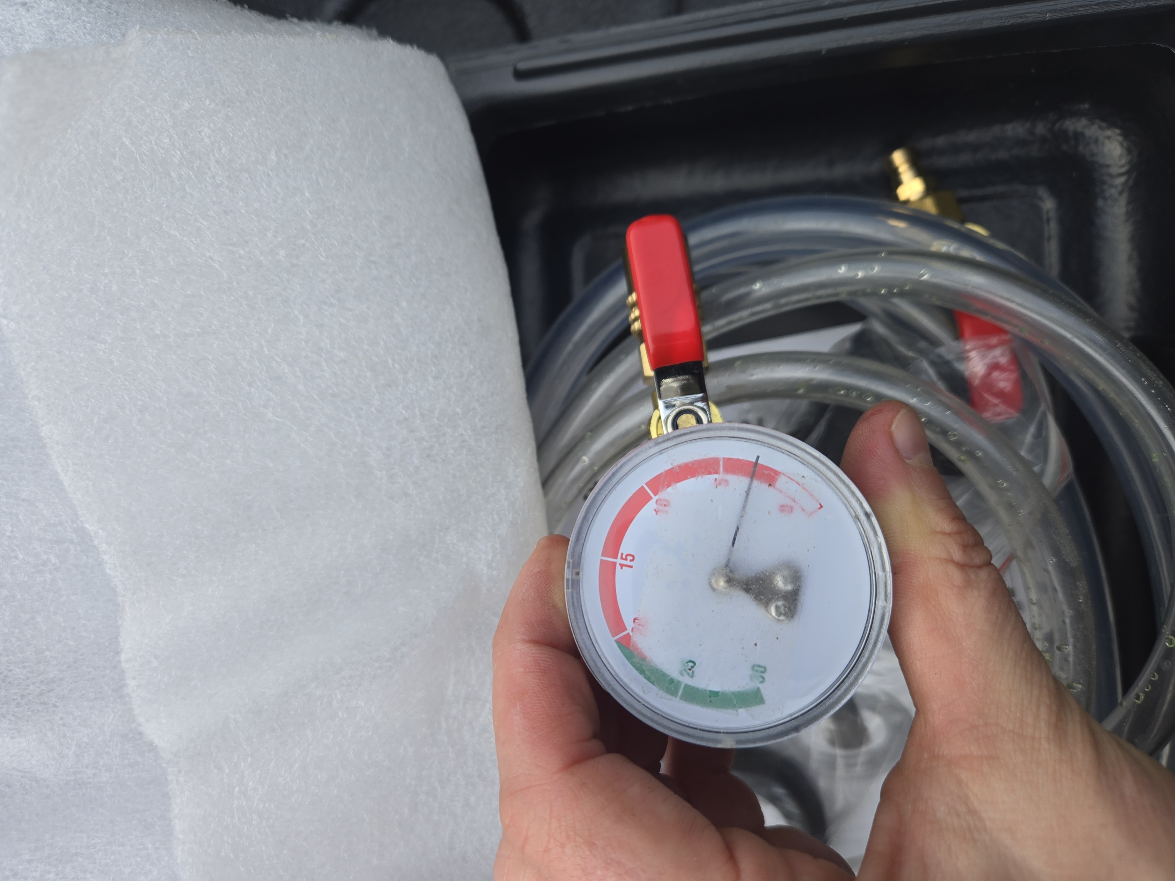

I received the new gauge for the coolant vacuum tool, and tested it on the car today. It will get to 15 in-Hg of vacuum pressure before coolant starts coming out of the venturi hose.
I left the system under 15 in-Hg of vacuum pressure for 10 minutes and the pressure didn't bleed off, so the system must be sealed. This gives me a fair bit of confidence that there are no leaks on the system. I will plan to bleed the system at the vent and top off with distilled water as needed before driving the car home from storage.
