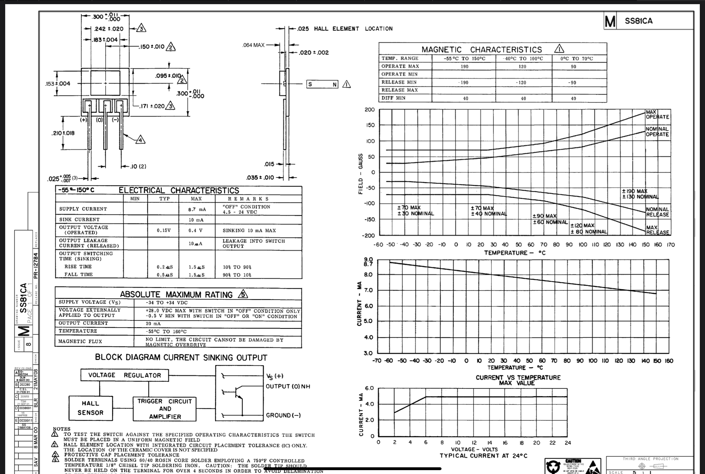

Here is the data sheet for the SS81CA on the sensor

Posted: Fri Jan 27, 2023 6:59 pm
Appears to be discontinued, but not impossible to find new old stock...
https://www.radwell.com/en-US/Buy/HONEY ... CH/SS81CA/
