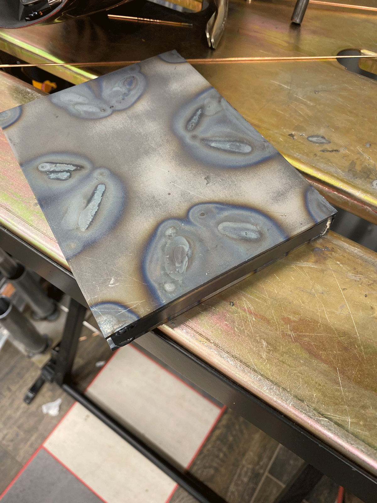

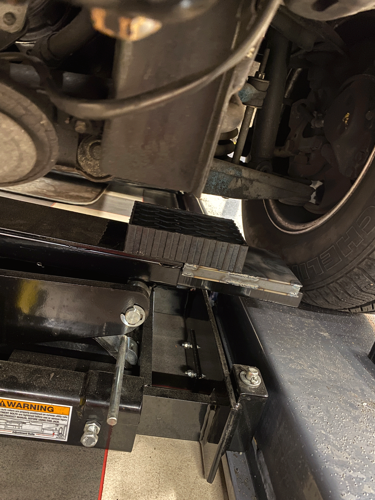

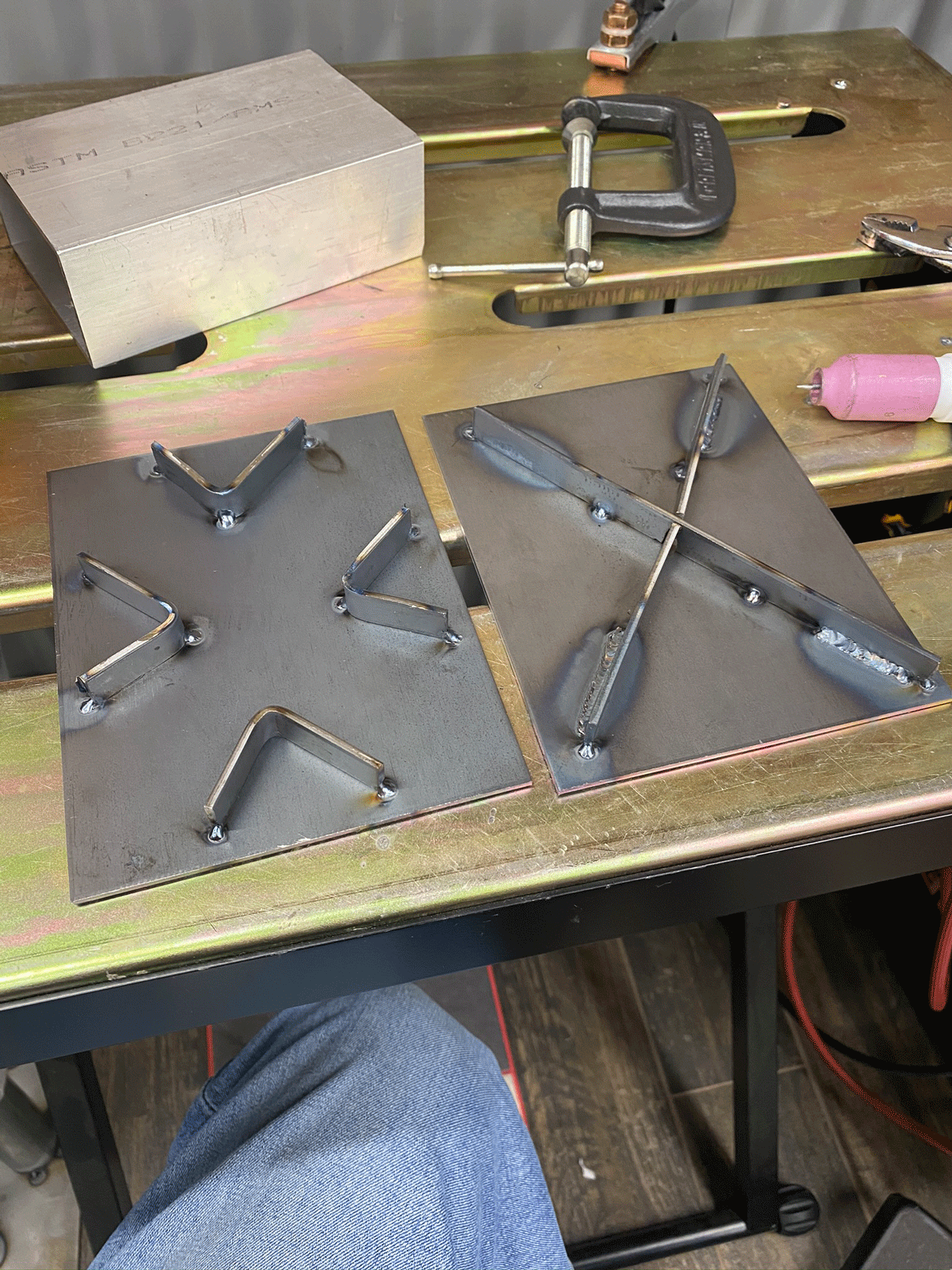

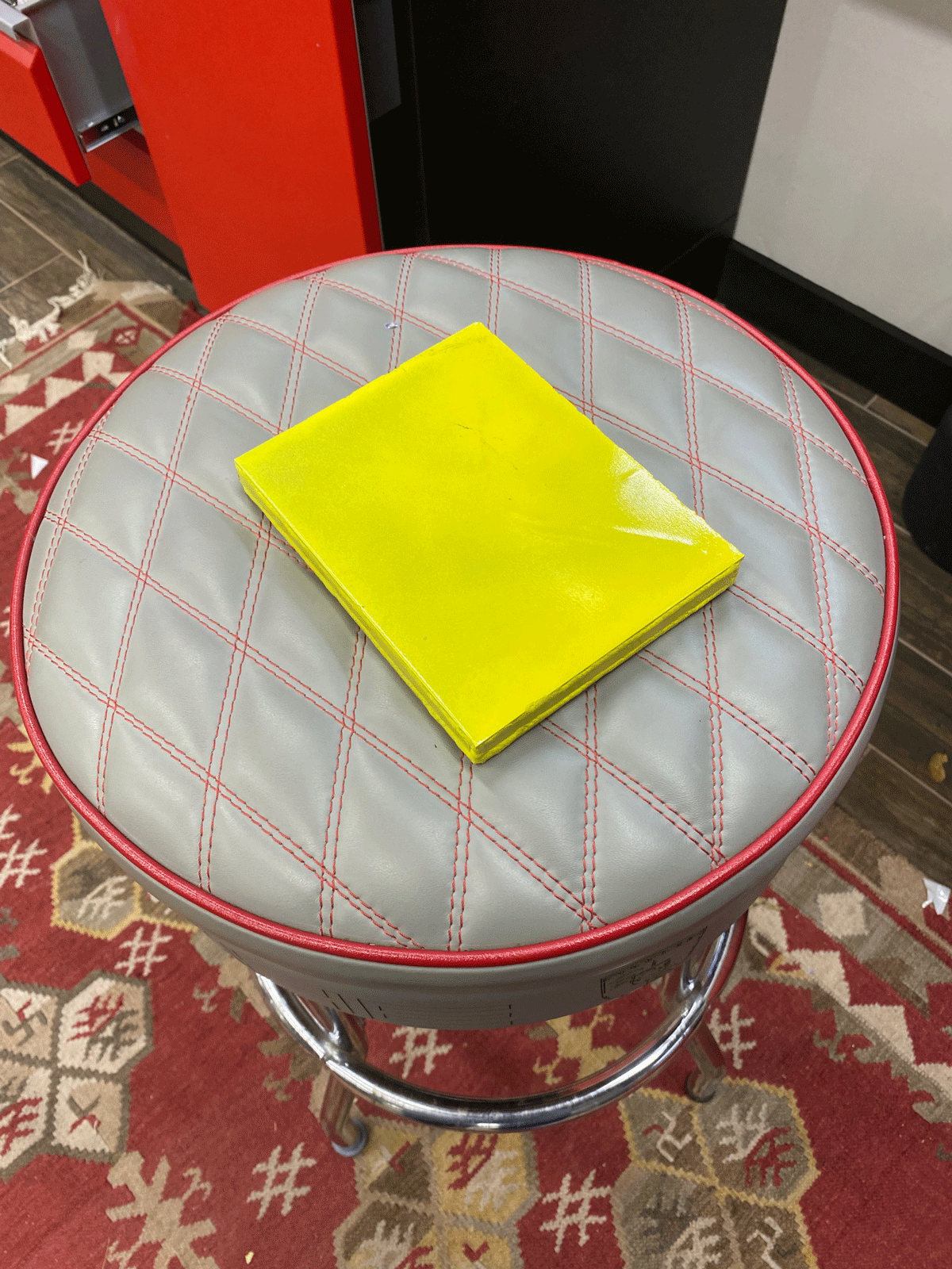

Speaking of more than needed, this reminded me of another project/tool I made for the rolling bridge jack...
I needed a spacer in an thickness I didn't have, so turned it into a TIG practice session. :)
With these plates, the rubber lifting block can sit flush on the rolling jack body and its pull-out wings....
All welded up and painted to match the safety yellow pieces on the lift.

larry wrote: Sun Sep 12, 2021 11:30 pm Why are there 2 pairs of pads with different thicknesses in this set? I’m dealing with a full rise scissor but I don’t think that makes a difference.
That's just the set I bought, to have options. I got them to put on top of my rolling bridge jack, so I could lift a car off the lift's runners without metal-on-car contact... I either use the skinny ones or the thick ones depending on how high/low the car is....
