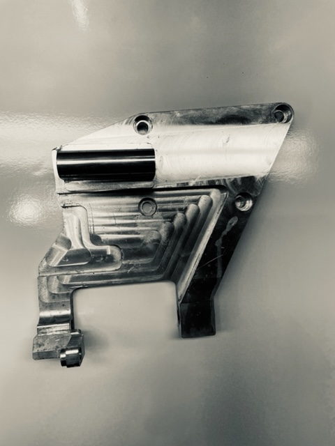

Hey,
Don't know if it helps much, but I'm in the process of designing a new mount, that allows the Nissan unit to bolt on with no modifications or grinding and will retain the AC unit. Product is currently in prototyping

If you see the picture I posted previously, there is a simpler way to be able to adapt more modern alternators to our existing mounts without having to modify the mount itself.

Darwin wrote: Thu Oct 14, 2021 9:27 am If you see the picture I posted previously, there is a simpler way to be able to adapt more modern alternators to our existing mounts without having to modify the mount itself.
As shown in post #3 of this thread you mean? Looks like a custom bracket extension? Hard to get my bearings on those pictures, but is that extension piece using the a/c compressor mount location, making it an a/c delete approach?
