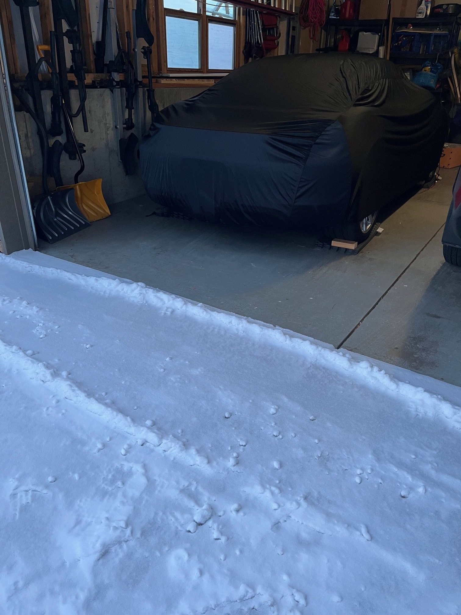

Little bit of an update as the 718 slumbers for the winter. The green light (#8) has not gone out and have been checking it frequently. Of the 5 traps I set in November, one just recently caught a visitor. All is good, although now with the distractions of the holidays being over and the doldrums of the winter in full force (pict from last weekend 15 F and snowing), it is hard to be patient!blueline wrote: Mon Nov 11, 2024 9:33 am [
If that happens. just unplug the Ctek from the car's accessory port, turn car's the ignition on and back off and re-plug the Ctek. All should be good. I don't think that you will face this issue with a 718. (I don't think it will be an issue with a regular battery in any car - I suspect it's a Lithium battery protection and safety protocol.)
Happy Winter rest to your sweet 718!![]()
Thanks for the support!
