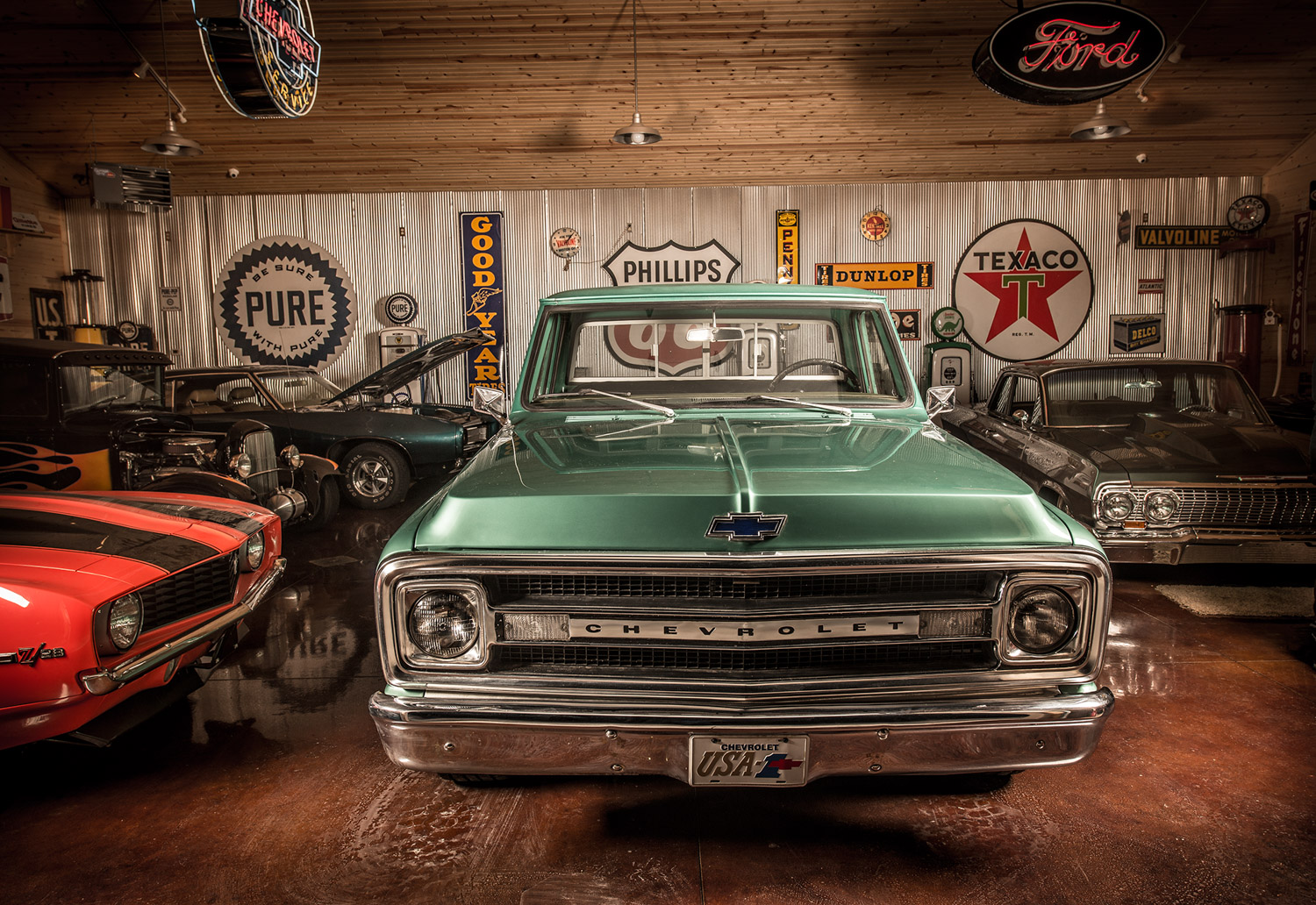

More on winter storage from a re-posted and updated Hagerty Media article. It's much of what's already been said above but with a few twists, some of which might be helpful. It's a good, concise presentation. There are also a couple of caveats to consider, depending on individual situations.
"The Best Tips for Winter Car Storage and Care"
https://www.hagerty.com/media/maintenan ... d568259d8a
