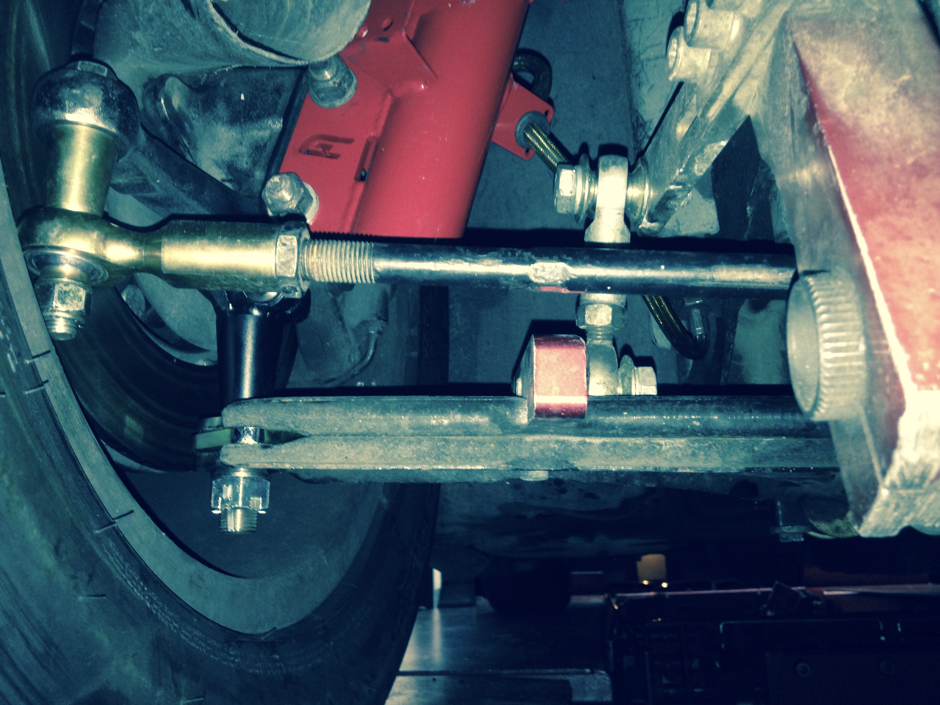

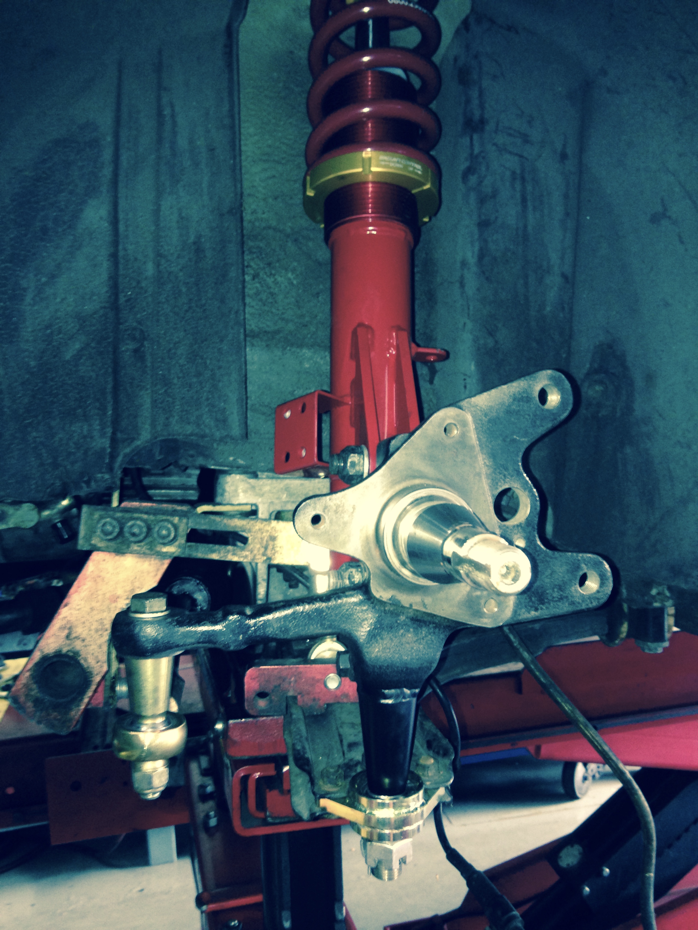

If you are serious about going fast and keeping up with modern P-cars, then you will want to lower your 944 significantly more than stock (as in almost 2 inches/50mm). The only way to decrease weight transfer side to side is to lower the center of gravity, which past a certain extent upsets the intended suspension geometry front and rear. This is why Porsche modified the uprights for 964 and 993 Cup cars, same with BMW for the production-based E30 M3 race cars, front and rear, and many other production-based race cars. The factories didn't spend the time and money to alter the front and rear suspension geometries just to make the cars look cool (though they did!). Modern damping and aero upgrades are another subject . . . .
As for the 944, I have drop pins TIG-welded into the pinch bolt sections of my 951 uprights which do the trick, they have been great for over 10 years but are not the ideal solution (though I think they are superior to the longer ball joint pins otherwise currently available for 944s). Search Rennlist for my old thread about 944 front suspension geometry, I won't provide a link out of respect to our host Tom. I attached a couple of pics of the initial setup with the early factory-style stamped steel control arms before going to Blazak boxed steel arms (which are complete overkill).
Front drop pins/longer ball joint pins also require tie rods with bump steer correction (I use an old Weltmeister 911 kit for this). Elephant Racing offers the same.
The 944's spindle-style upright with tapered roller bearings is limited, even the larger/beefier '87+ version. The ultimate solution would be a modern billet upright with a large bolt-in ball bearing for the wheel bearing and optimized mounting points for the lower ball joint and tie rod. See this link for the general idea, though nothing currently exists for the 944 AFAIK:

Coilovers with modern damping are the next frontier. I have Ground Control coilovers, which have excellent construction, but the old Koni-based damping feels, well, old.

- IMG_2605.JPG (1.79 MiB) Viewed 615 times
- IMG_2604.JPG (1.81 MiB) Viewed 615 times
