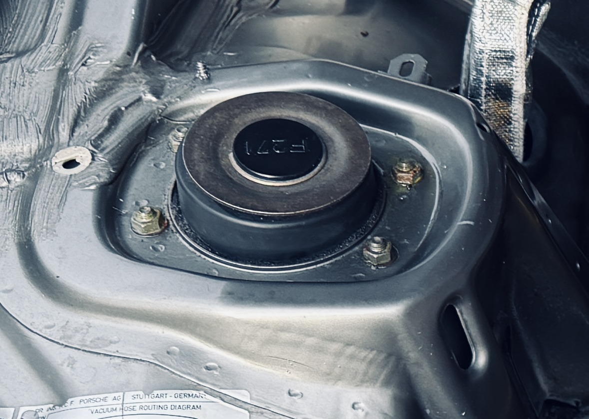

This is likely not a great photo, but I noticed this gap in my mounts, should I look closer? I hadn't taken much notice, my suspension is not awful, just aging.

spacecad3t wrote: Thu Dec 25, 2025 2:09 pm This is likely not a great photo, but I noticed this gap in my mounts, should I look closer? I hadn't taken much notice, my suspension is not awful, just aging.
I am not super knowledgeable about what happens as it does this and fails, I just know it's not supposed to do that.
But if you're spending the money elsewhere, make that investment imo.
