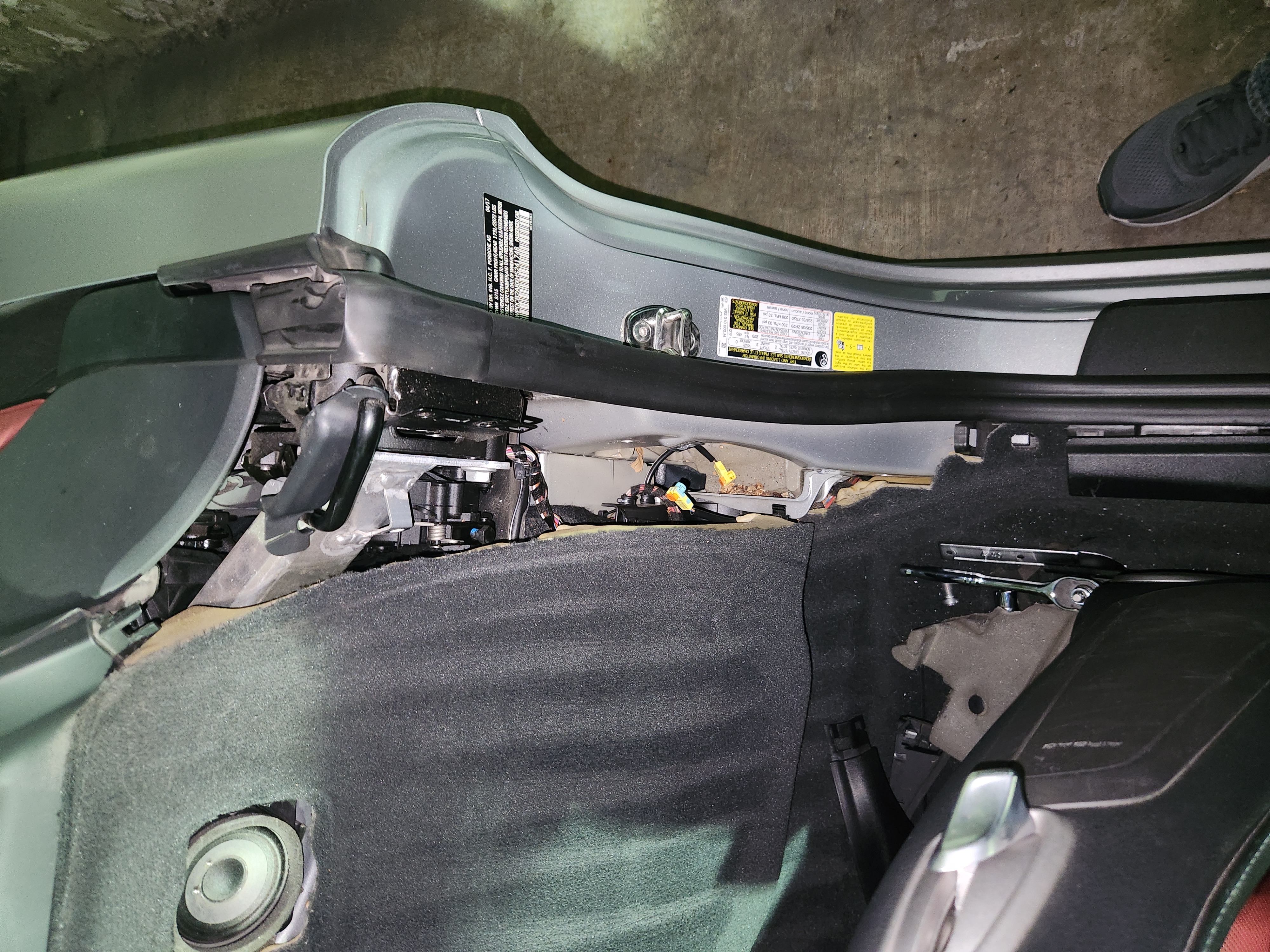

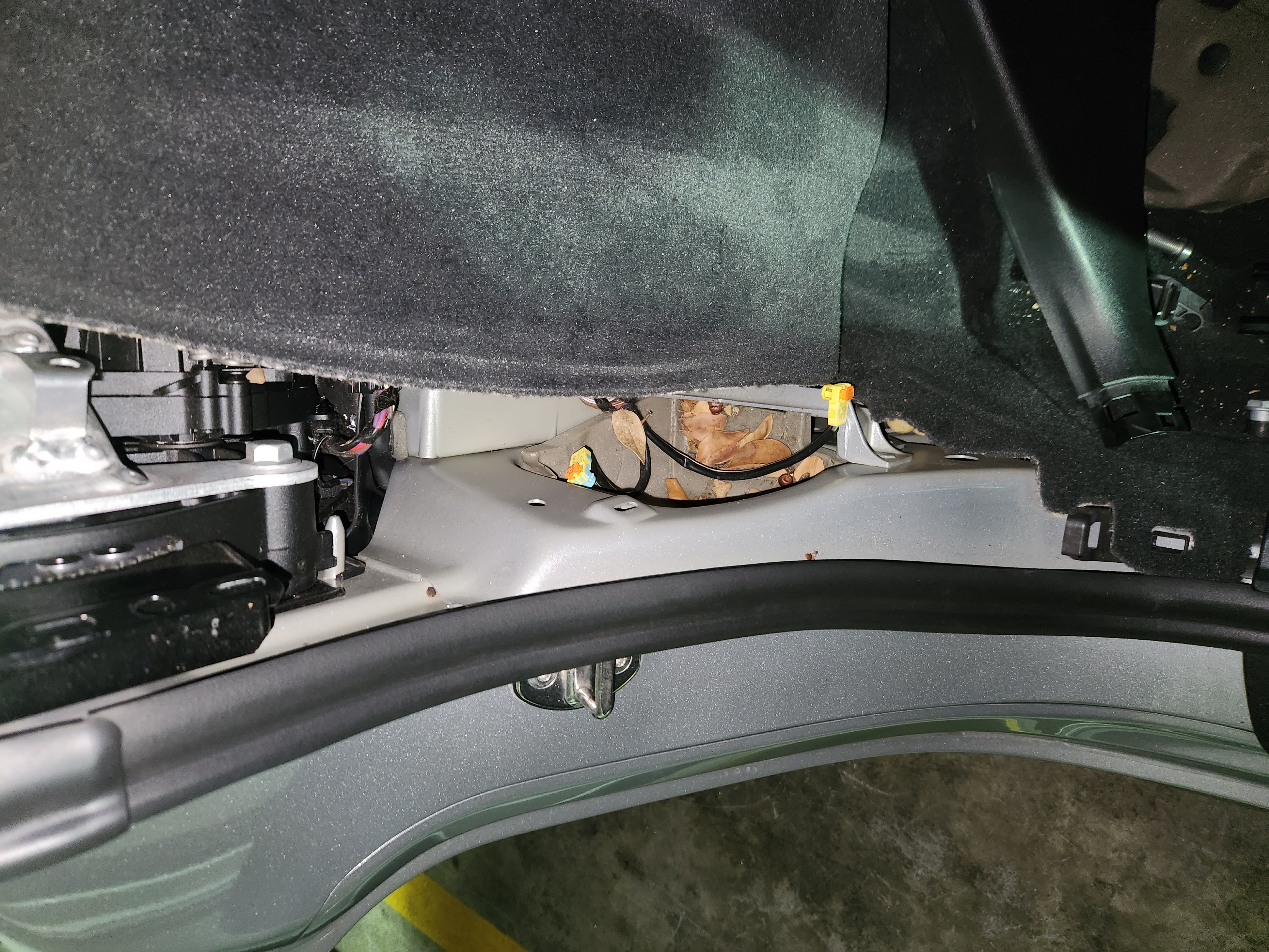

My Boxster's driver's side seatbelt was fraying at the edges, and smelled faintly of someone's cheap cologne. So, I finally decided to call time-out, and have the belts re-webbed.
I'll post pics of the results when I get my new belts. Meanwhile, I found a spot where leaf debris collects - only discoverable by removing the belts.
There are two companies that I know of in the USA who do seatbelts:
Safety Restore - https://www.safetyrestore.com/webbing-replacement
Seatbelt Planet - https://www.seatbeltplanet.com/p-35844- ... hange.html
I cannot discern a product difference between the two, though there may be. I'm going with Safety Restore at a cost of $230, versus $380 for Seatbelt Planet. That's a 40% difference on the all-in cost, including one-way shipping.
One service difference is that Safety Restore does not seem to offer sample color swatches. BUT, they promise 24-hour turnaround, versus SBP's present promise of '7-10 business days' (up to 2 weeks)! That and the big price difference made my decision.
Removing the seatbelts is not difficult, but it does involve two interior trim pieces that do not pull straight-off, so I spent some minutes on Youtube to refresh my memory of the right moves. Only two bolts secure each seatbelt. The job requires a trim tool, a box-end wrench or socket, an internal triple-square bit, and something small to release the electrical connections. Some people pull off the rubber door seal to ease trim removal, but I left mine in place. The carpet need not be removed, though it is easy to do so; fold back a corner of the carpet to access the bolt that holds the retractor.

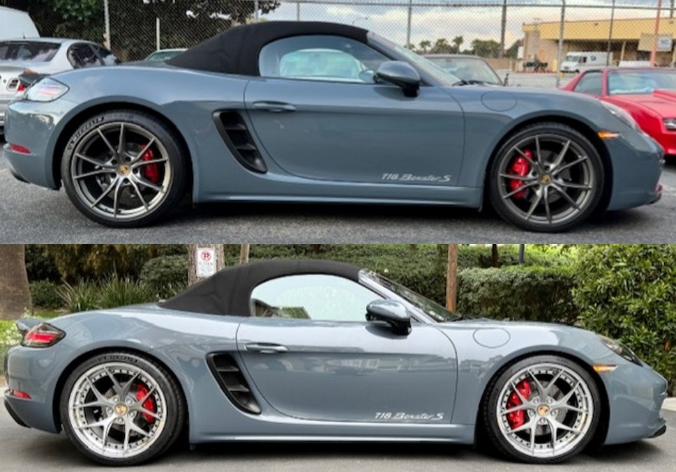

New shoes and an Eibach drop for my 2017 718 Boxster S (2.5L) tuned to 400+ hp via COBB :thumbup:
Paint color is the same, but Graphite Blue Metallic changes dramatically depending on the light and time of day.
