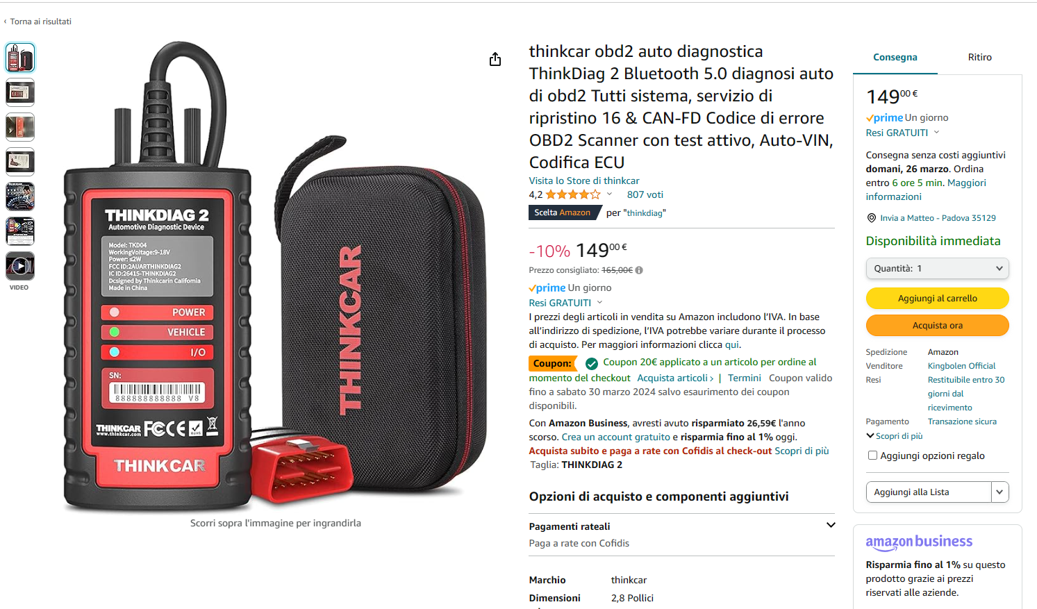

Wow Ken!!!
you have been extremely kind!
Is there a specific version of thinkdiag I have to buy?
I found this one on amazon, which appears to be version 2.0.
thinkdiag 2.0 amazon.png (800.7 KiB) Viewed 3323 times
If you confirm this is ok I will buy it and follow your pdf instruction to code some stuff.
Hoping not to blow my car up! :lol: :lol: :lol:
The item you found is version 2 of the Thinkdiag. I have the original Thinkdiag. I have not used version 2. My understanding is that version 2 has some additional features that you will probably never use. If you can find the original one I would get that since it is cheaper and I can confirm it works. If you can't find the original one, I believe version 2 should work but I do not know for sure.
With respect to blowing up your car, I had the same concerns when I started. That feeling goes away after you have coded one or two items. All I can say is, double and triple check each code that you are changing, change only one “hack” at a time and keep good notes of each code that you have changed (or even better take a picture of each code that you change).
