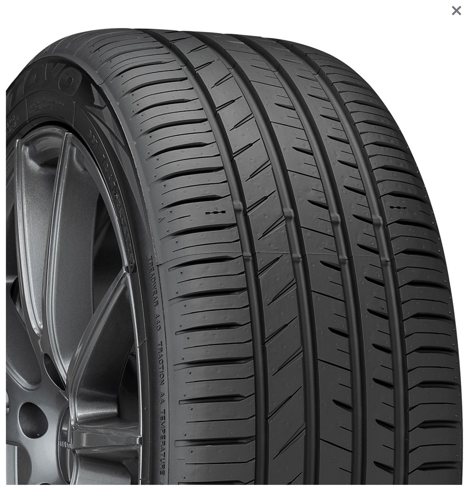

by Arne2
Arne2 wrote: Sun Oct 01, 2023 1:21 pm Still not enough miles for much of a review on the Toyo all seasons, but I can say they seem to be reasonably quiet so far. Will have a better feel for them after next weekend's PCA drive.
150 miles today, mostly on Cascade foothill backroads, with ~25 miles of freeway on the way home. And the initial impression is good. Nice steering response and feel, good ride quality, and while they are still new and at their best for noise, they seem to be very quiet. The tread design looks almost the same as the previous version Michelin PS A/S 3+ with wide grooves, big blocks and limited siping. So like the Michelins I don't expect them to be useful in snow or ice, and as an all season tire I don't expect they'd hold up well for track use. But I rarely get snow and ice around here, and when it does happen it only lasts a day or two, so I can leave the Cayman in the garage for that weather.
As a side benefit here in the US, they are quite affordable. Discount Tire sells the set of 20" for Base, S and GTS for $804 shipped, or just over $900 installed (plus tax for those not here in Oregon).
All in all, I think they will do me just fine.
https://www.discounttire.com/buy-tires/ ... duct/89573

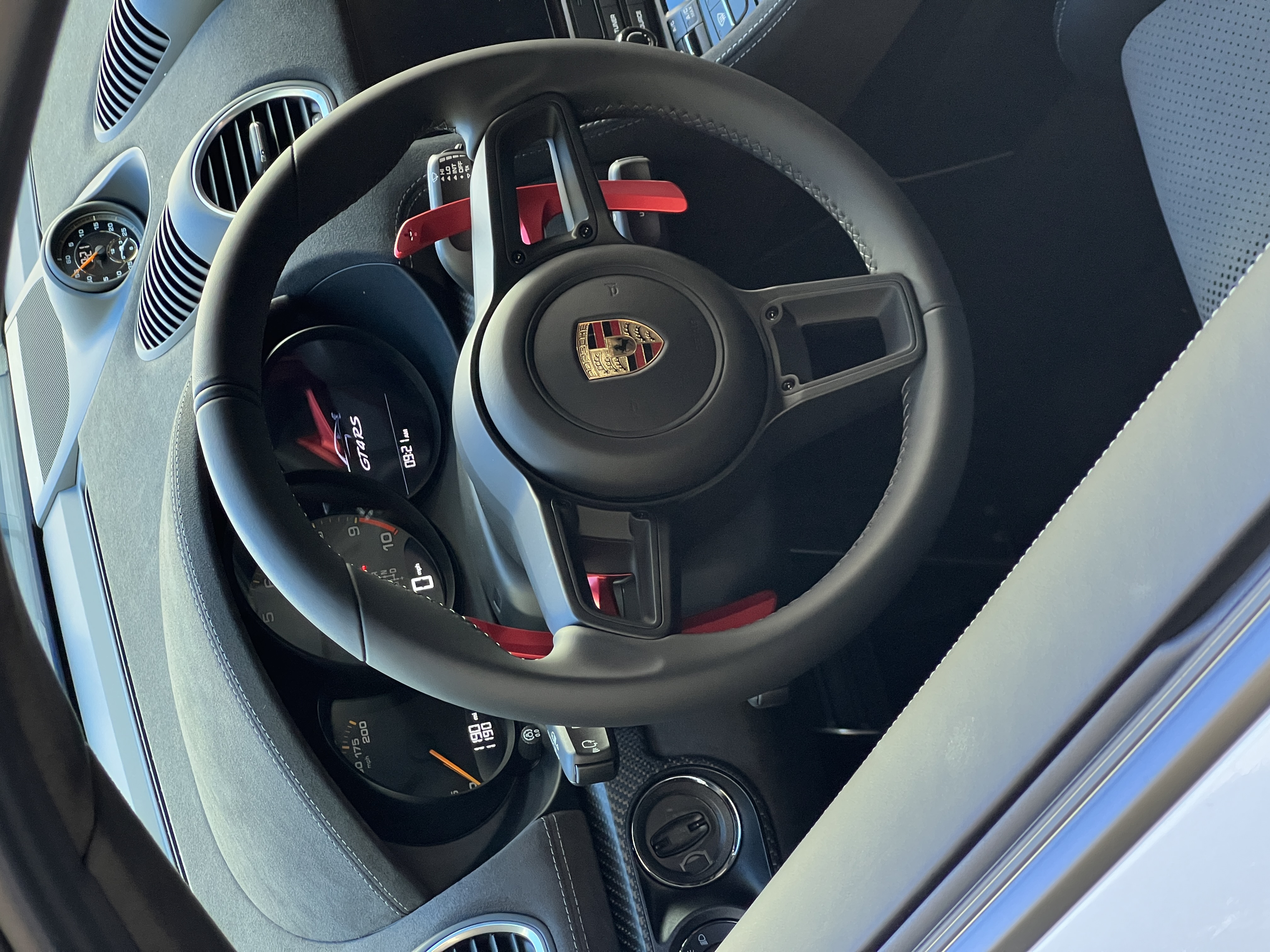

Helped a friend install some JCR aluminum paddles in his RS.

Chulander wrote: Tue Oct 10, 2023 2:11 pm Helped a friend install some JCR aluminum paddles in his RS.
Those look fantastic! I've been considering going with a set painted racing yellow to match all our other yellow interior bits...still on the fence regarding whether it would be too much yellow.

by Chulander
Treemagnet wrote: Wed Oct 11, 2023 11:28 am
Yeah, it’s definitely a “look” to have paddles in a bright color. I have some elements in my interior that’s bright—door handles, seatbelts, and fire extinguisher. I found the bright painted trim can get to be a bit too much when sprinkled all over the place.
So for my car, I went with black paddles:
