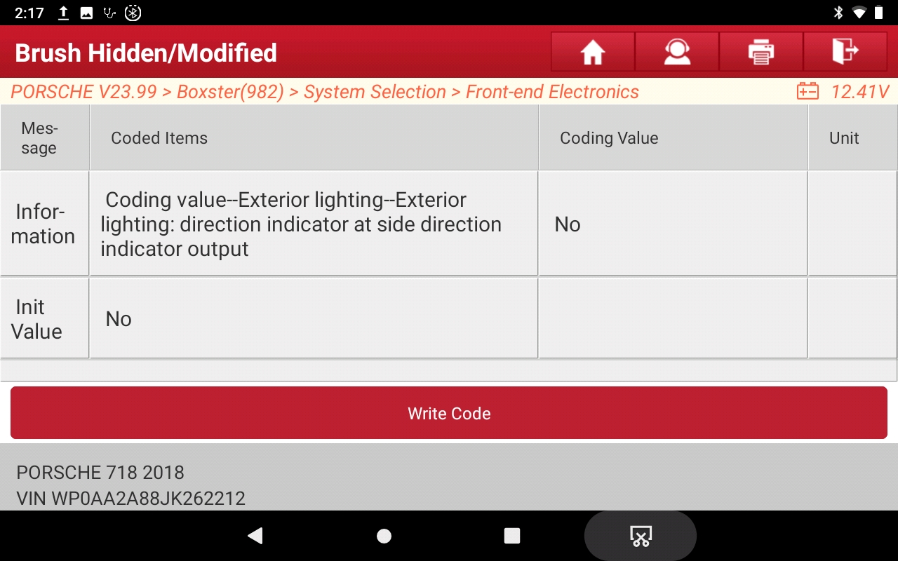

Don't like the side marker lights? Everywhere other than North America the front "marker" lights are used only for side indicators. So turning off the side marker function is simple. But do note, this cryptically named setting defeats all side marker (position) light functions. They only flash with blinkers or hazards if you do this.
Side marker defeat
  • System Selection > Front-end Electronics > Coding value--Exterior lighting--Exterior lighting: direction indicator at side direction indicator output = No
    {Default for North America: Yes}

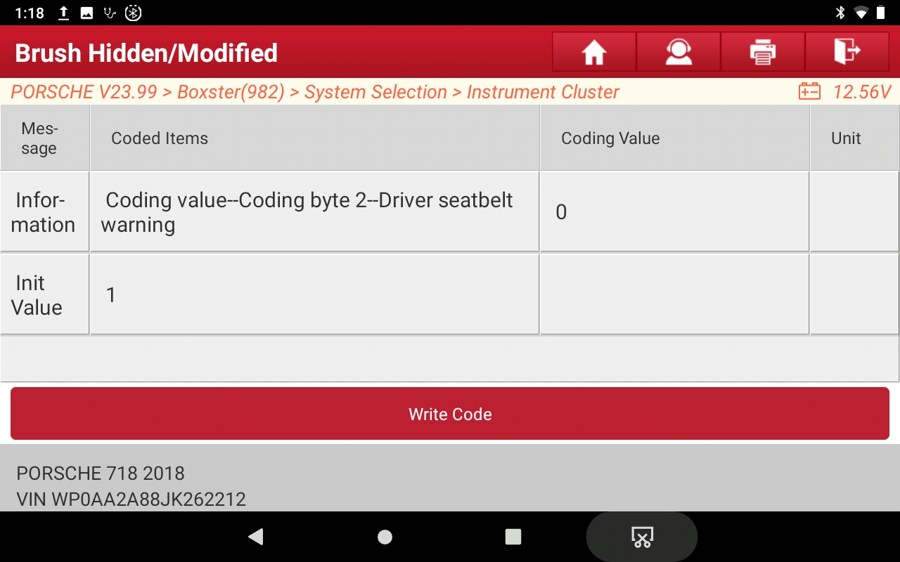

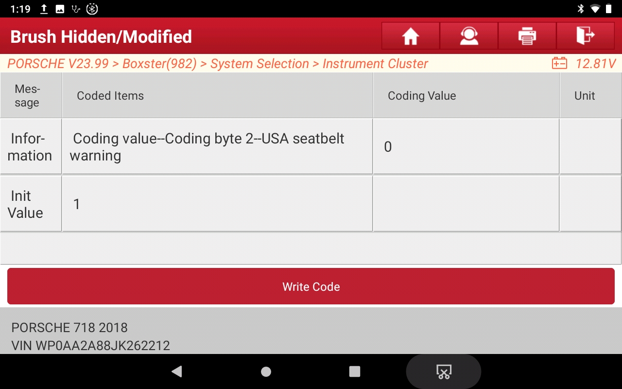

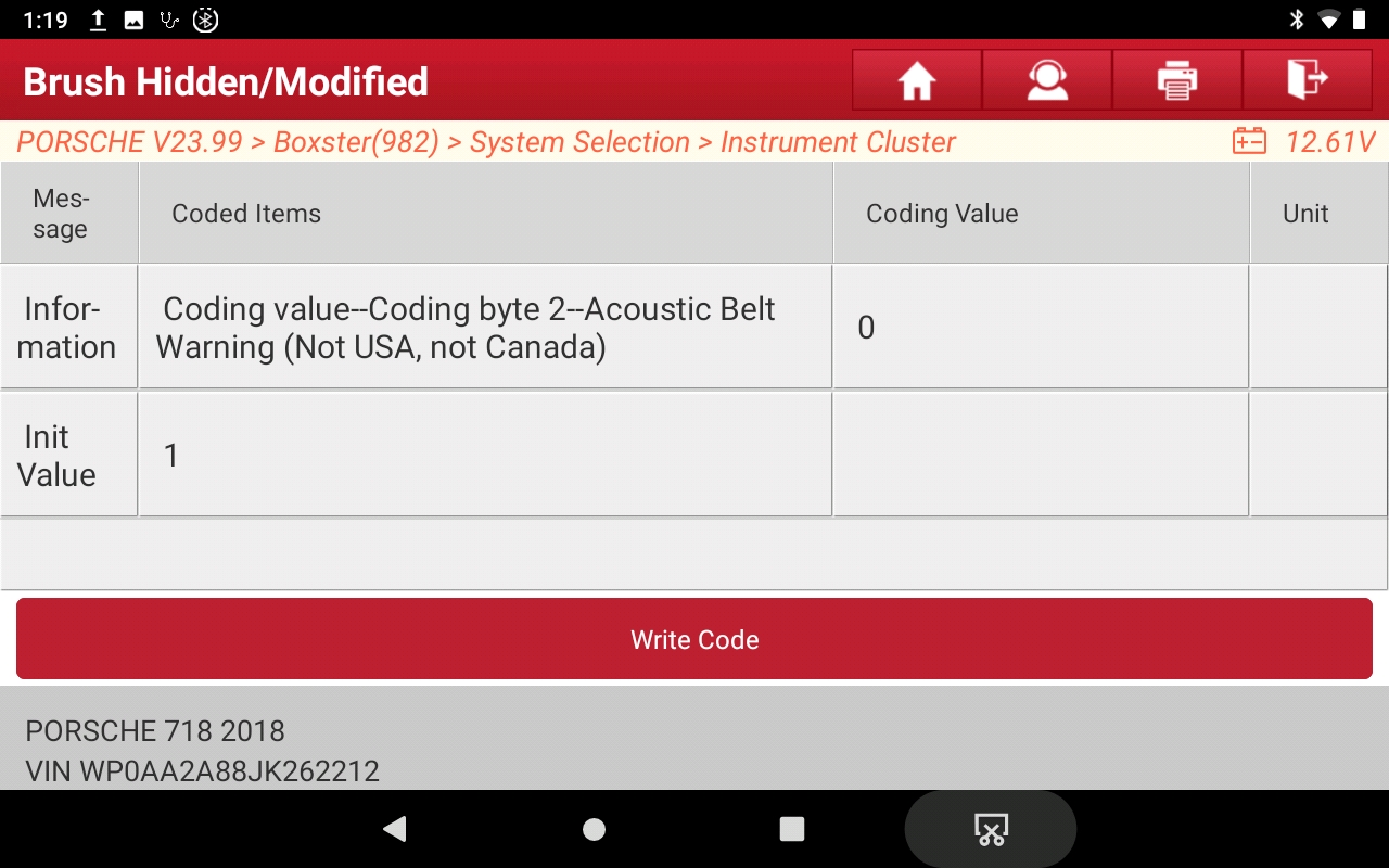

Seatbelt warnings. I never drive without belting up, but I do not need my car to chime and display warnings if I start it to back it out of the garage to wash it (for example). So those chimes and lights and warnings just annoy me.
There are either 1 or 4 params to change, depending on preferences.
Disable seatbelt warnings
Do only the 4th one (Acoustic) to simply kill the chimes without affecting the lights and MFI warnings. Do all 4 to completely disable all belt warnings.
  • Instrument Cluster > Coding value--Coding byte 2--Driver seatbelt warning = 0
    {Default: 1}
Seatbelt warning-1.jpeg (425.15 KiB) Viewed 3495 times

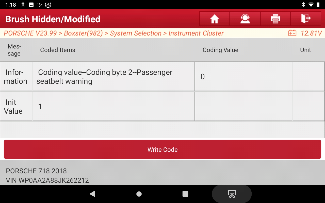

  • Instrument Cluster > Coding value--Coding byte 2--Passenger seatbelt warning = 0
    {Default: 1}
Seatbelt warning-2.jpeg (425.56 KiB) Viewed 3495 times
  • Instrument Cluster > Coding value--Coding byte 2--USA seatbelt warning = 0
    {Default: 1}

  • Instrument Cluster > Coding value--Coding byte 2--Acoustic belt warning (Not USA, not Canada) = 0
    {Default: 1}

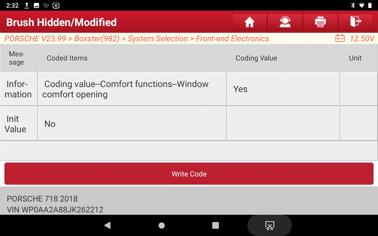

  • Front End Electronics > Coding value--Comfort functions--Window Comfort Opening = YES
    {Default: No}
Comfort windows-1.jpeg (429.32 KiB) Viewed 3494 times

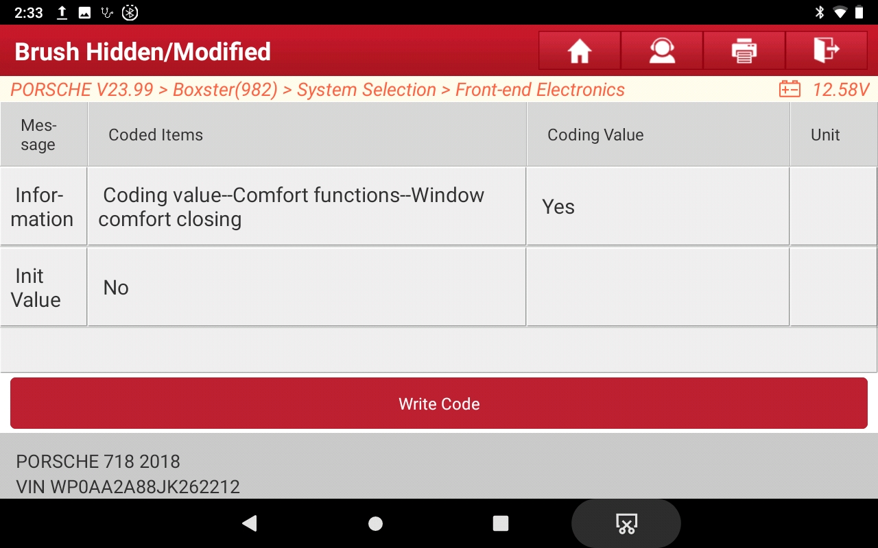

  • Front End Electronics > Coding value--Comfort functions--Window Comfort Closing = YES
    {Default: No}
Comfort windows-2.jpeg (429.04 KiB) Viewed 3494 times

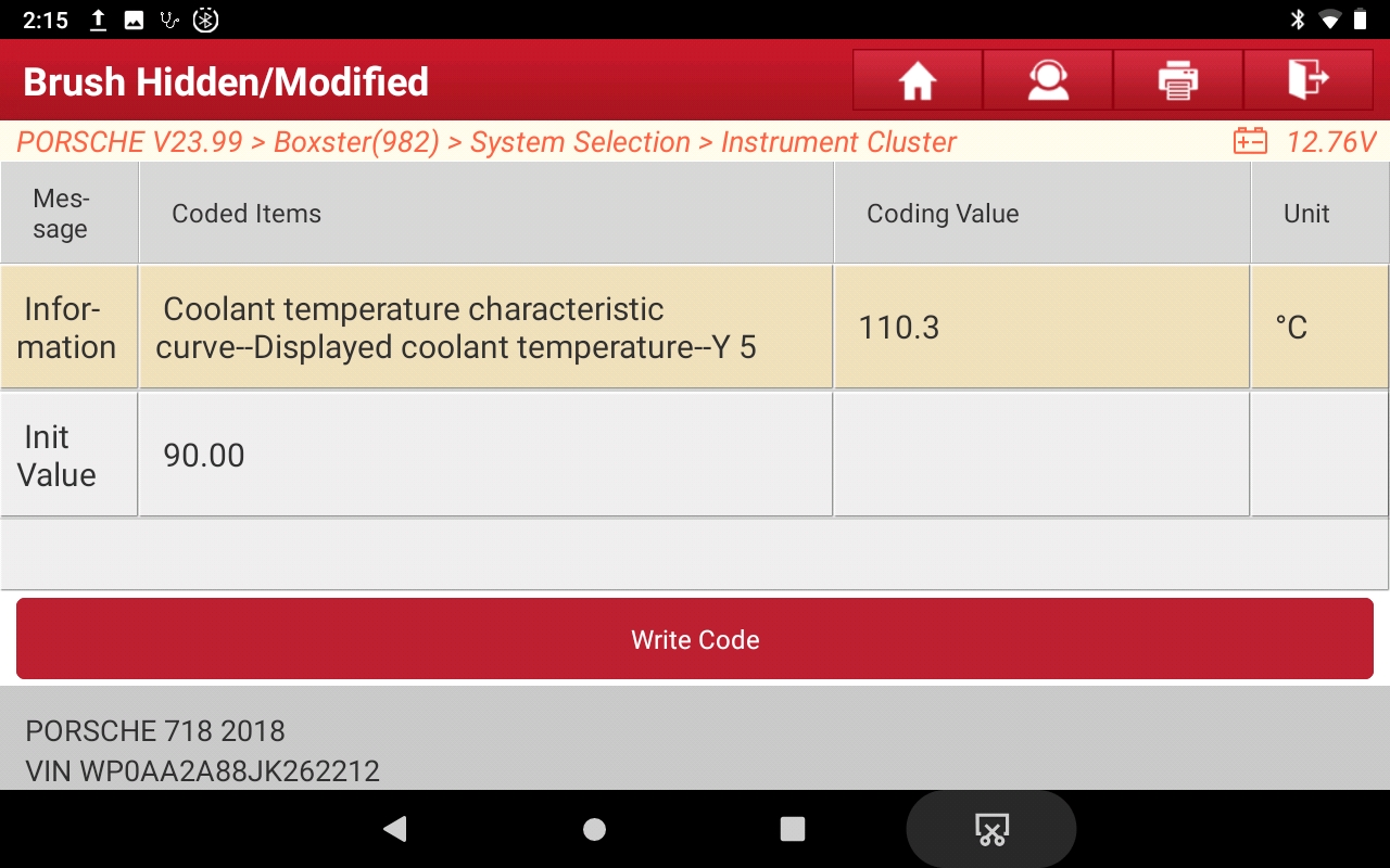

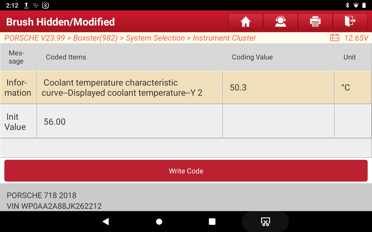

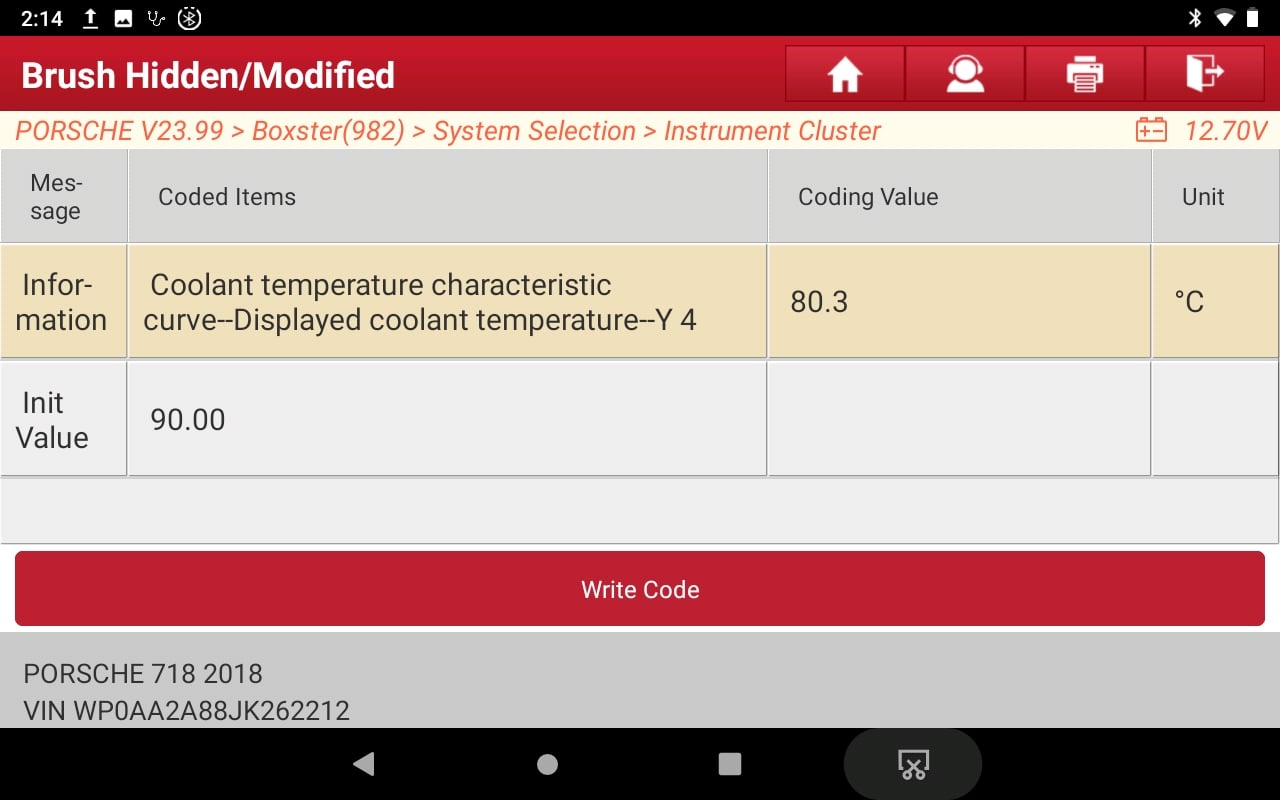

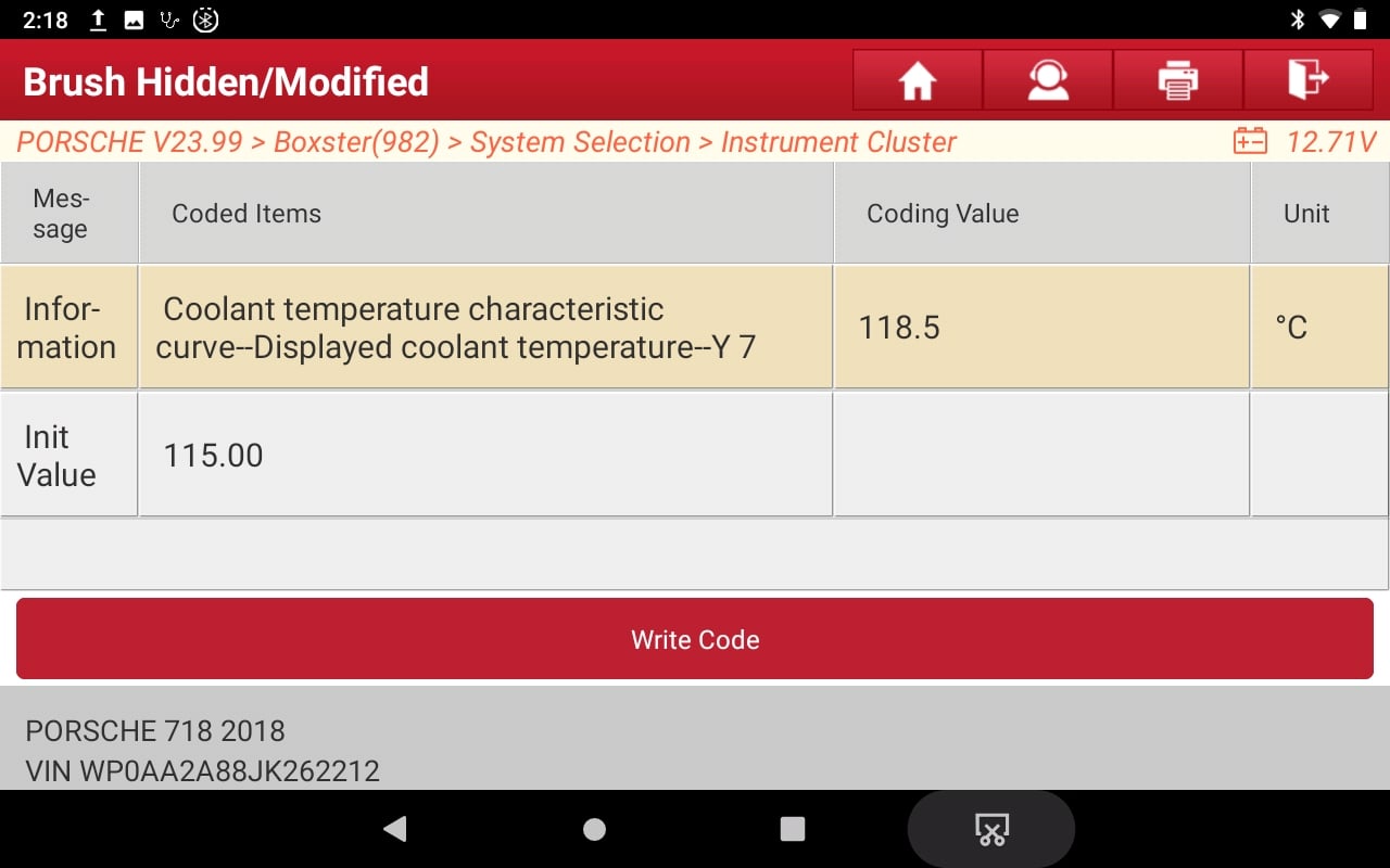

Porsche, in their wisdom, seriously constrains the coolant temperature display in their vehicles (except the GT2/3/4). It is interesting how Porsche is modifying the actual values you see, probably to decrease variability in the display and avoid having unnecessary calls from customers that don’t know what’s going on. In actuality, they have made the coolant temp gauge nothing more than a glorified idiot light.
For example, all temps from 80-115°C (176-238°F) are programed to display 90°C (194°F). The gauge doesn't start reflecting true temps until it gets to 125°C (257°F).
To me, if I have a gauge, I want to see real data. And since the GT cars can do it, so can ours. This change requires six changes, for ranges 2-7 in the chart shown above.
Coolant Temperature Characteristic Curve
  • Instrument Cluster > Coolant temperature characteristic curve--Displayed coolant temperature--Y2 = 50.3
    {Default: 56}
Coolant temp-1.jpeg (464.9 KiB) Viewed 3464 times

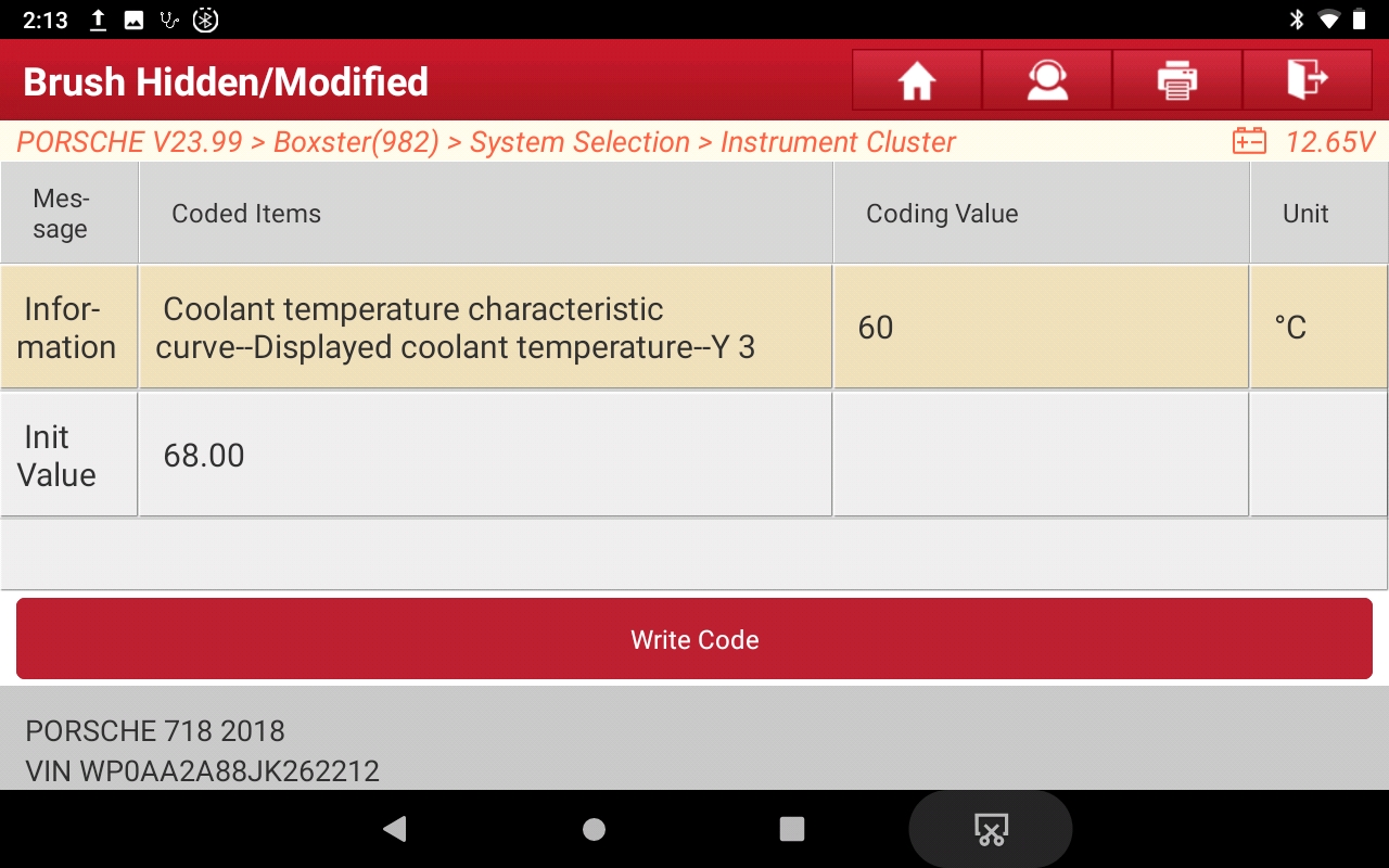

  • Instrument Cluster > Coolant temperature characteristic curve--Displayed coolant temperature--Y3 = 60
    {Default: 68}
Coolant temp-2.jpeg (464.45 KiB) Viewed 3464 times

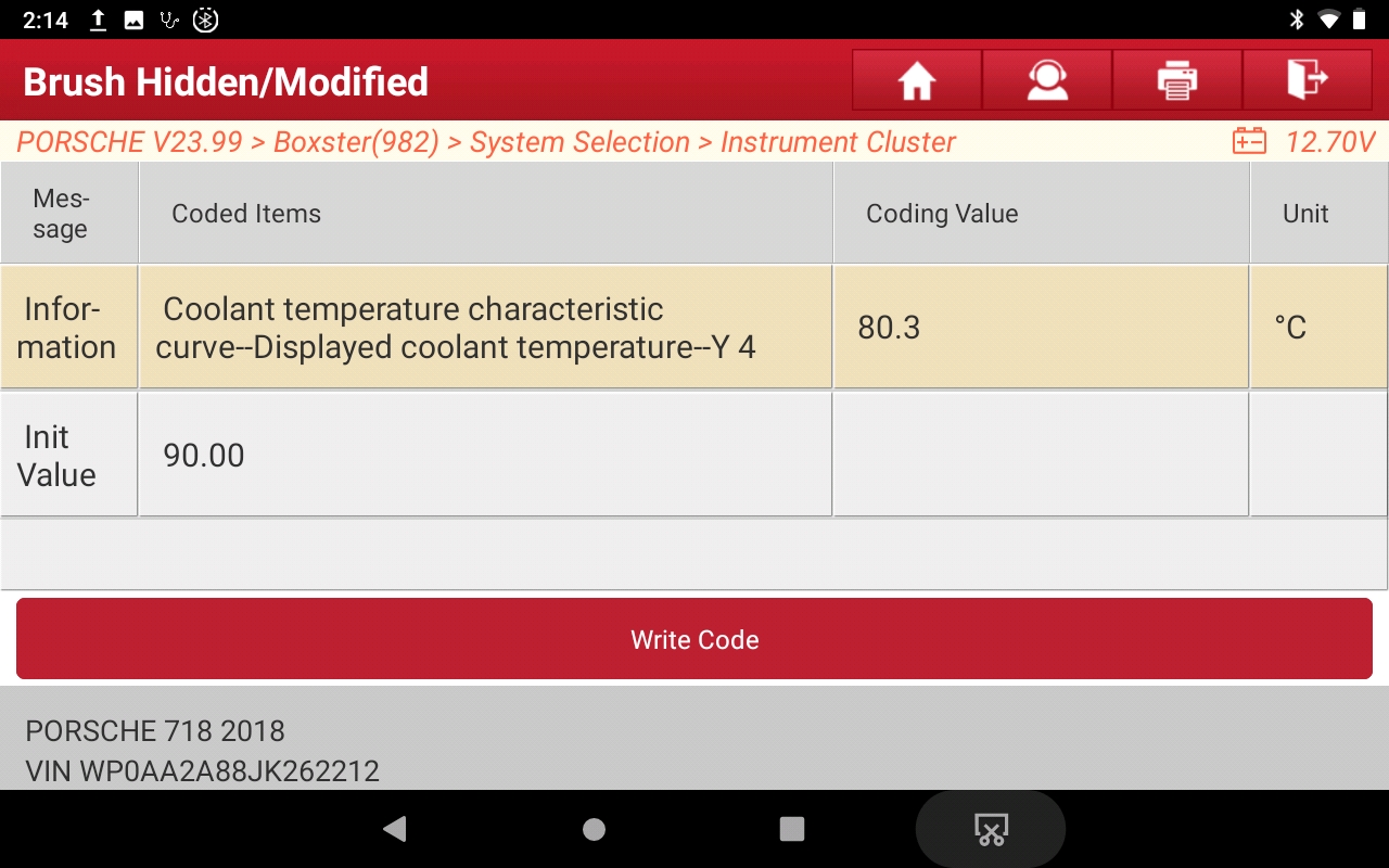

  • Instrument Cluster > Coolant temperature characteristic curve--Displayed coolant temperature--Y4 = 80.3
    {Default: 90}
Coolant temp-3.jpeg (464.32 KiB) Viewed 3464 times
  • Instrument Cluster > Coolant temperature characteristic curve--Displayed coolant temperature--Y5 = 110.3
    {Default: 90}
Coolant temp-4.jpeg (463.84 KiB) Viewed 3464 times
  • Instrument Cluster > Coolant temperature characteristic curve--Displayed coolant temperature--Y6 = 114.8
    {Default: 105}
Coolant temp-5.jpeg (464.9 KiB) Viewed 3464 times
  • Instrument Cluster > Coolant temperature characteristic curve--Displayed coolant temperature--Y7 = 118.5
    {Default: 115}
Coolant temp-6.jpeg (465.02 KiB) Viewed 3464 times
- Arne

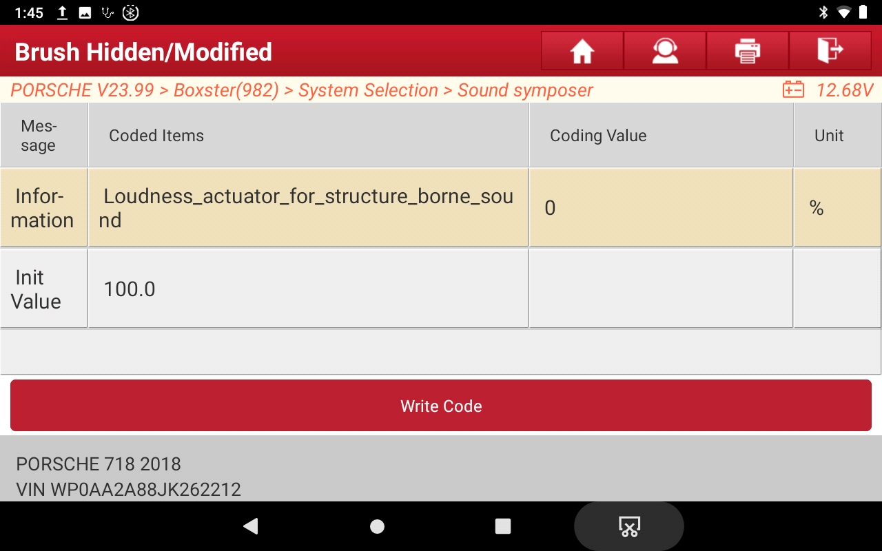

You can change the Sound Symposer (Soundaktor) sound volume, or even turn it off. The soundaktor is a device that produce artificial engine sound to ”enhance“ engine sound in the cabin. (I've found very little difference between 0 and 10%. Mine is set at 10% now.)
Edit or defeat Sound Symposer volume
  • System Selection > Sound symposer > Loudness_actuator_for_structure_borne_sound = [0-100]
    {Default: 100}
