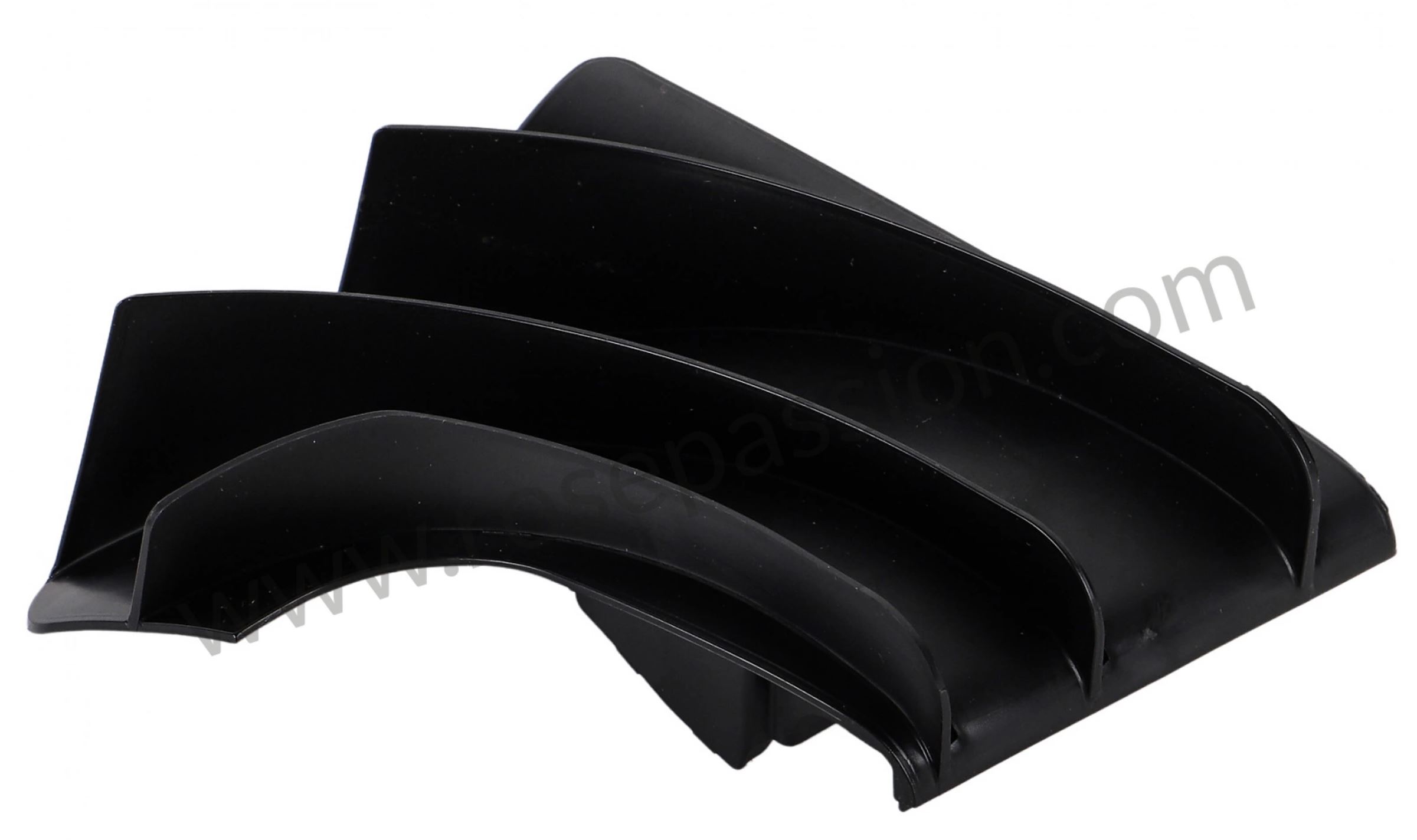

There is some confusion here because two different parts are being discussed and they have similar part numbers.
982505569A - top.JPG (119.01 KiB) Viewed 5463 times
982-505-201-A Brake duct, top half, LH rear
982-505-202-A Brake duct, top half, RH rear
982-505-569-A Brake duct, bottom half, LH rear
982-505-570-A Brake duct, bottom half, RH rear
These are for 718 GT4 rear LCA's. They consist of two halves that clamp onto the LCA and screw together. These DO NOT fit the 718, 718S, 718T, 718GTS. Different LCA's.
What will fit the rear tension links on non-GT4 718 are these:
982-505-569
982-505-570
911T rear.JPG (73.54 KiB) Viewed 5457 times
The tension link will need to be removed and the air scoop slid onto it, then strapped in place. The plastic strap is built in.
