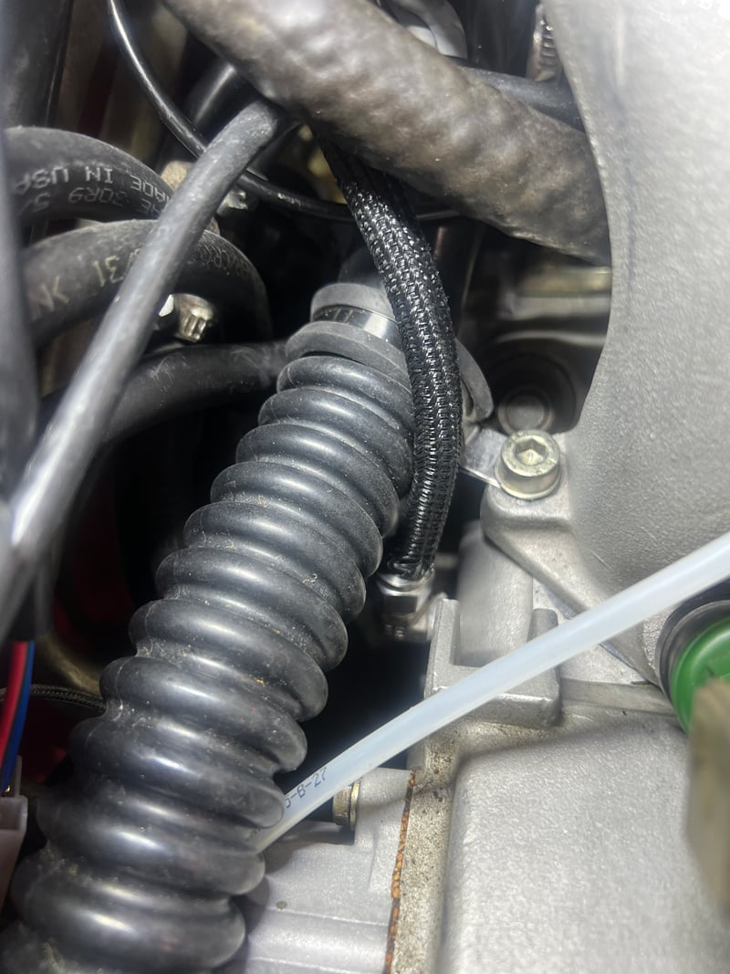

One thing I'd suggest when installing this harness is to take very close note of how all the old wires are routed, where they are clipped and clamped, what goes over and under what, etc. Take tons of 'before' pictures! The new harness isn't baked into shape like the old one -- the snorkel points up straight and all the wires are super flexible and give no clue how they should be routed.

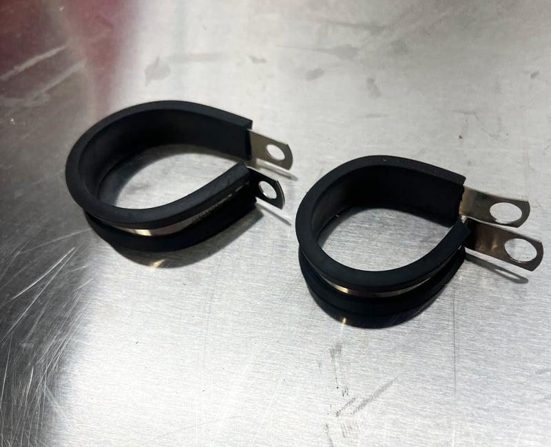

The new snorkel needs a clamp to hold it down. Since I didn't have the factory clamp, I opted to use a cheap stainless cushion clamp from Amazon at dr bob's suggestion. A 1-1/4" clamp is the best fit around the Kroon harness, but I opted to modify a 1-1/2" clamp to extend the tab 3 or 4mm to make for my steam vent fitting. I just pounded the bent end flat and re-bent it a little further away from the hole; then trimmed the rubber cushion part to fit, and had to drill the holes out to 8.5mm for the intake bolts.
Original on left; modified version on right.
It worked!

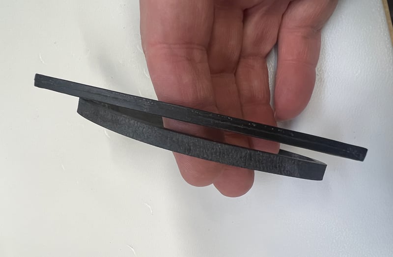

Still loving this harness and think it's probably the best money spent on my car in a long time!

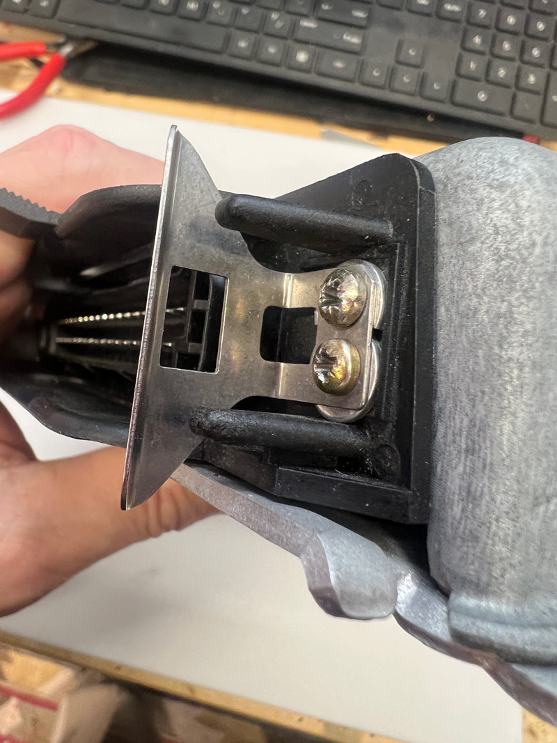

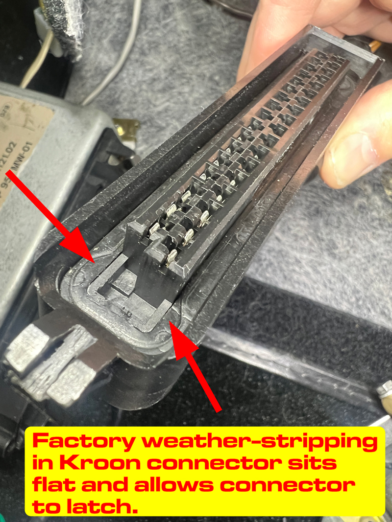

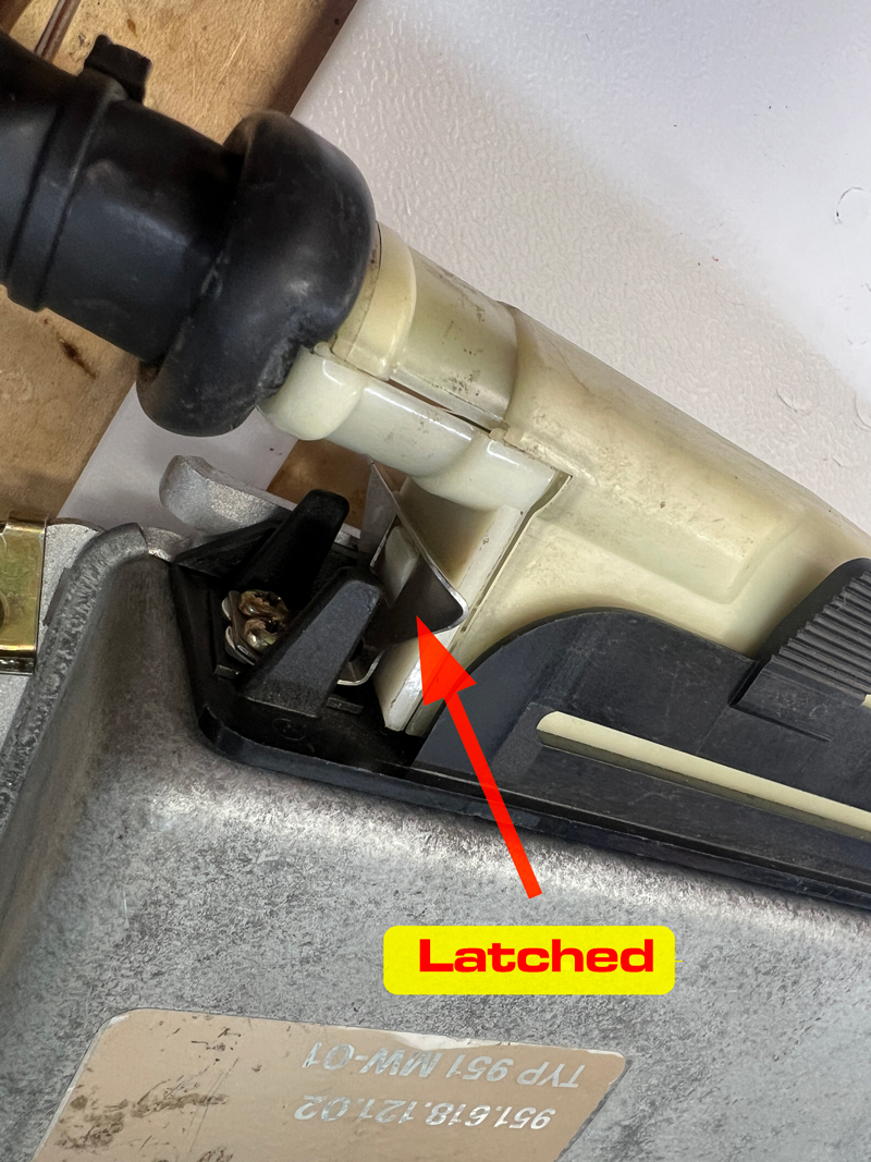

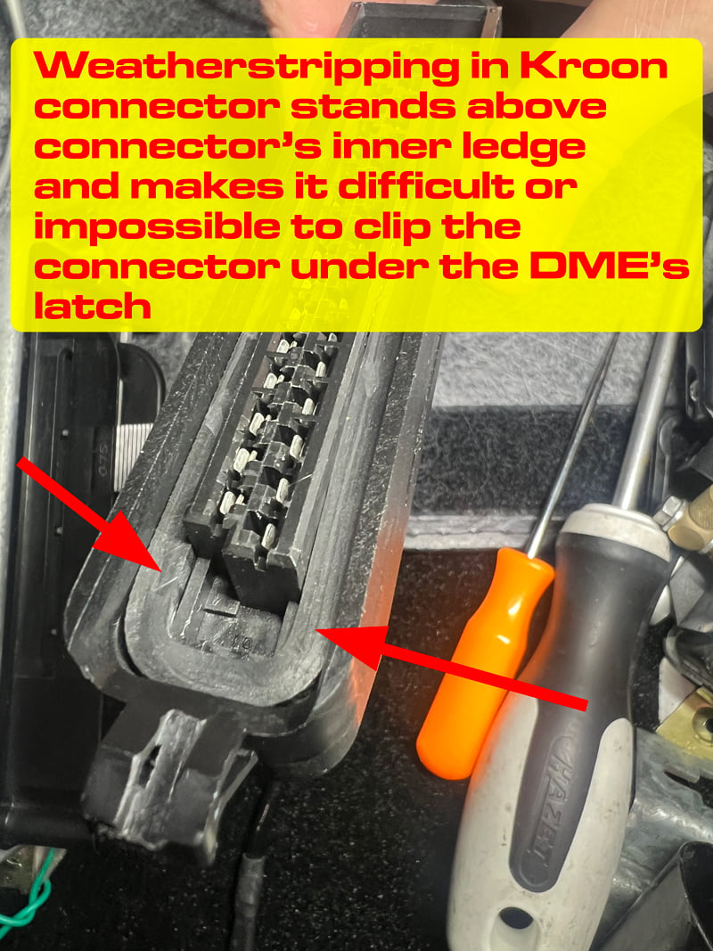

That said, here's more on the connector issue I mentioned. The main 35-pin connector is supposed to hook in on one end and then clip into place with the shiny spring-metal latch on the other end. Same with the KLR. The problem is that I could not get the connector to latch no matter how hard I pushed, and without it latching, it kept springing up and unplugging itself.
The culprit appears to be the rubber weather strip seal inside the connector. The Kroon version is about 1.5mm thicker than the factory piece. I don't 'think' the factory rubber is just flattened out after being squished for 40 years, because it just don't look deformed in any way and is uniformly skinnier -- not just skinnier where the connector clamps down on it. The rubber is just sitting in its groove and can be picked out easily (no glue, etc.). So my solution was to just swap over the rubber pieces from my factory harness. You could also just remove the rubber altogether and probably never miss it.
Below: here's the latching mechanism holding a connector in place as designed.

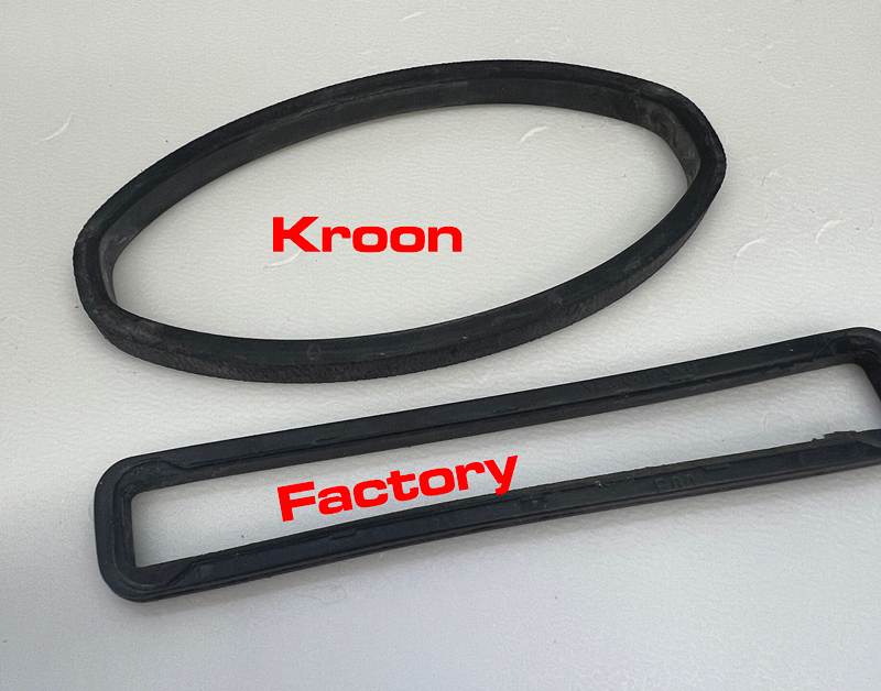

Below: here are a couple pictures showing the smaller factory piece compared to the Kroon piece. Given @Kroonwireharness's endless abilities to replicate rubber parts, I'm thinking they might want to create a thinner rubber gasket more akin to the one used by the factory.

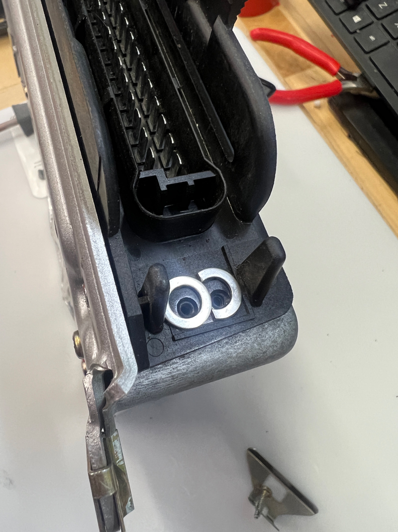

Below: if you don't have a skinny factory rubber piece available and don't want to go without the seal, another option that works is to put washers under the latching piece on the DME/KLR. Doing this raises the latch so that the connector doesn't need to be pushed down as far to latch.
Below: Here is the factory rubber in the Kroon harness.
Below: And here is the rubber that comes in the Kroon harness -- notice how much higher it sits.
