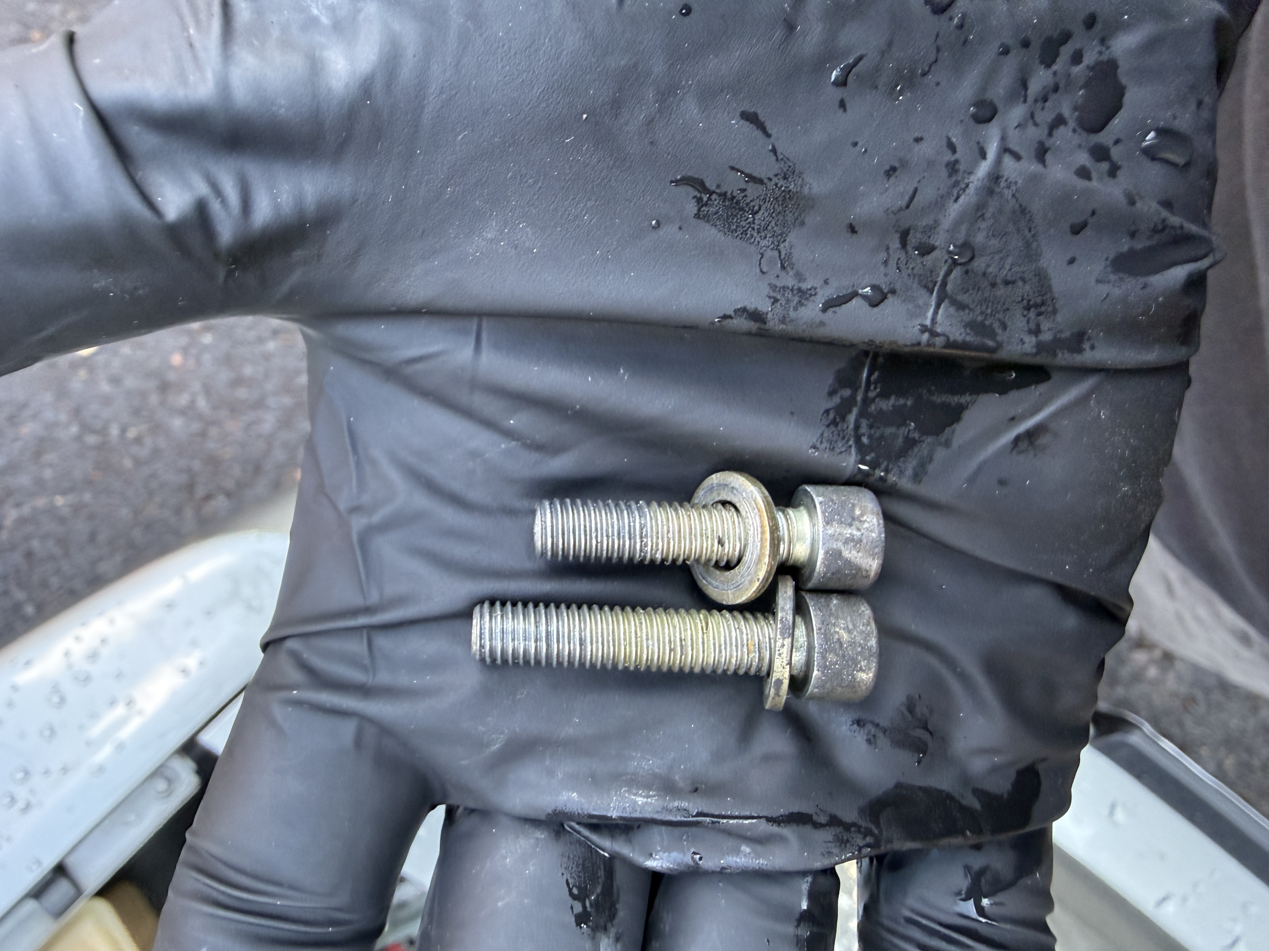

Look, here is the one long one compared to 3 same size bolts. These had yellow paint.
I ordered new hardware with the helicoils. I seems I may have used the long bolt on the outter two holes and wrecked their threads. The 2 holes closer to the intake runners seem to be intact.

spacecad3t wrote: Sat Nov 08, 2025 8:20 am Thanks Tom!
Look here is the one long one compared to 3 same size bolts. These had yellow paint.
All four should be 25mm long (~1 inch). Somebody used the wrong bolt in there, and it probably bottomed out and stripped the threads as you kept tightening. You can get M6x25 bolts at most hardware stores (along with an M6 heli-coil kit). You can use the standard shiny silver (zinc-plated) bolts from the hardware store, or shop around a little for the yellow versions to look more original. They are both electroplated in zinc (no paint); the yellow ones just get dipped in "yellow dichromate" after they are plated to give it that yellow look. You might also find them in other colors using a similar process. Just FYI so the Porsche gods look favorably on you and your car.
