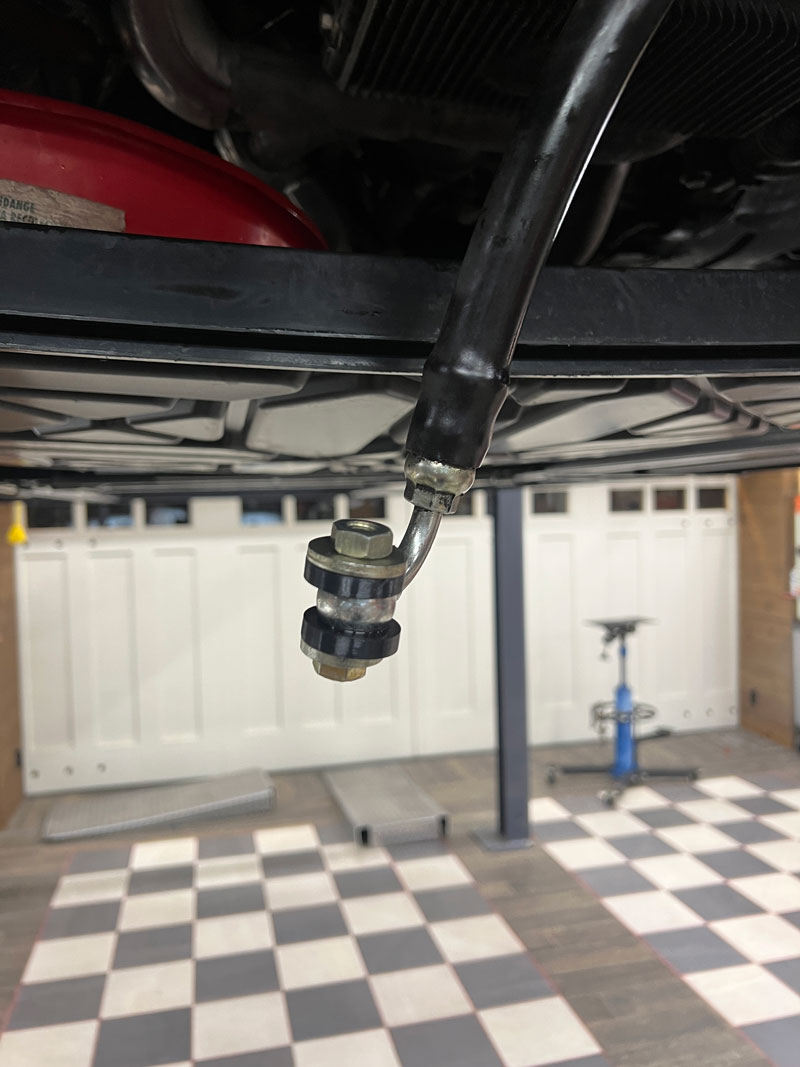

I need to fight the urge to make this a 5 year oil-seal job. :lol: Today I killed an hour printing rubber seals for the various disconnected oil and PS lines. There was a time in my life when I'd fight through stuff dripping in my hair but, curiously, the less time I have left on earth, the more time I feel like I have to do things like this. I get a weird sense of satisfaction knowing how badly it wants to drip on me...but can't....
