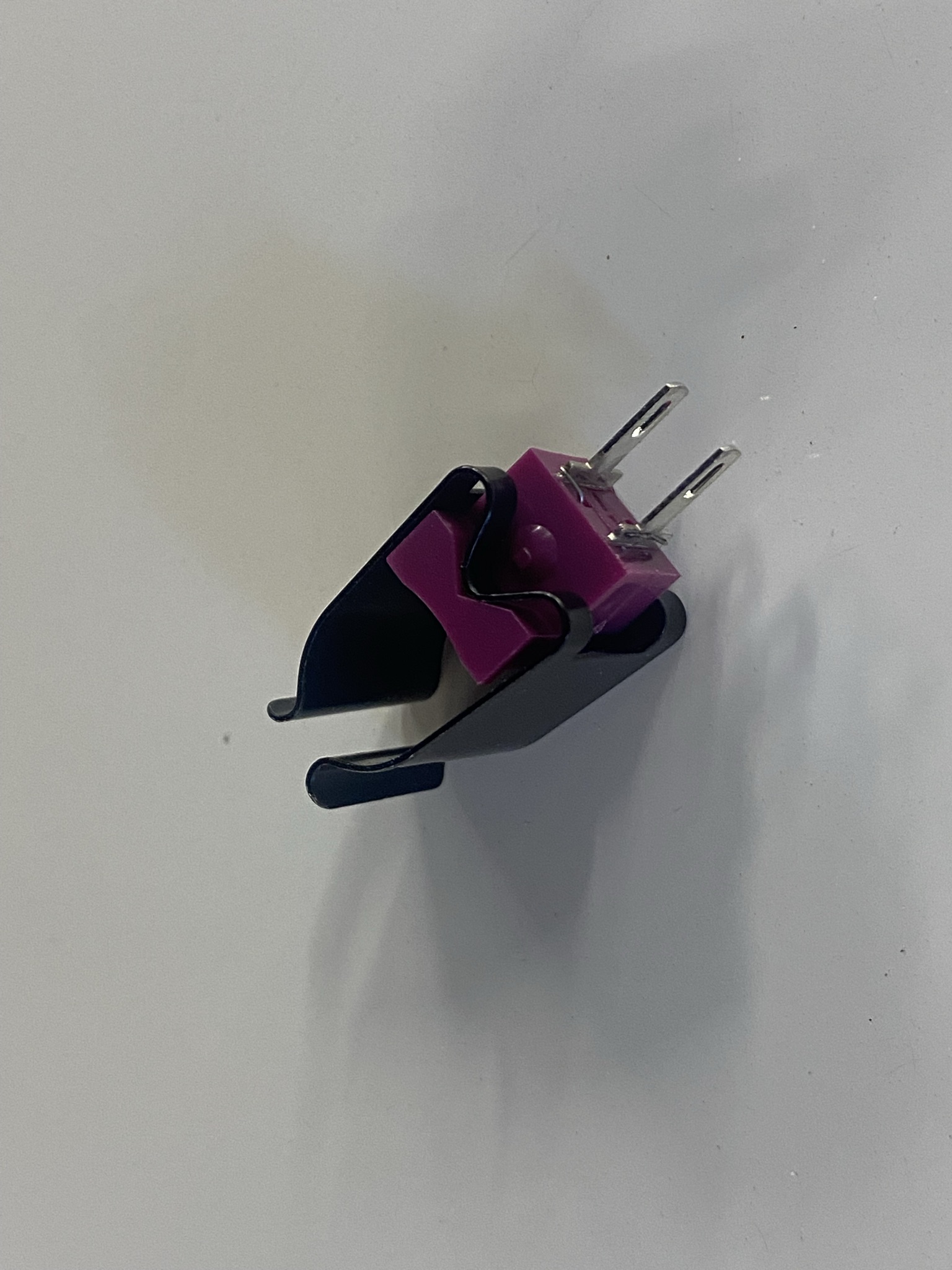

After toying with the idea of making a 3D-printed temp sensor mount, I found these clip-on pipe sensors at digikey. By pure luck the pipe is the right diameter. The sensor is spring mounted in the clip so it stays pressed against the pipe. It reads up to 100C which I sure hope will be plenty high enough. Will work on a little digital gauge for this soon, hopefully before the weather starts getting too much cooler....

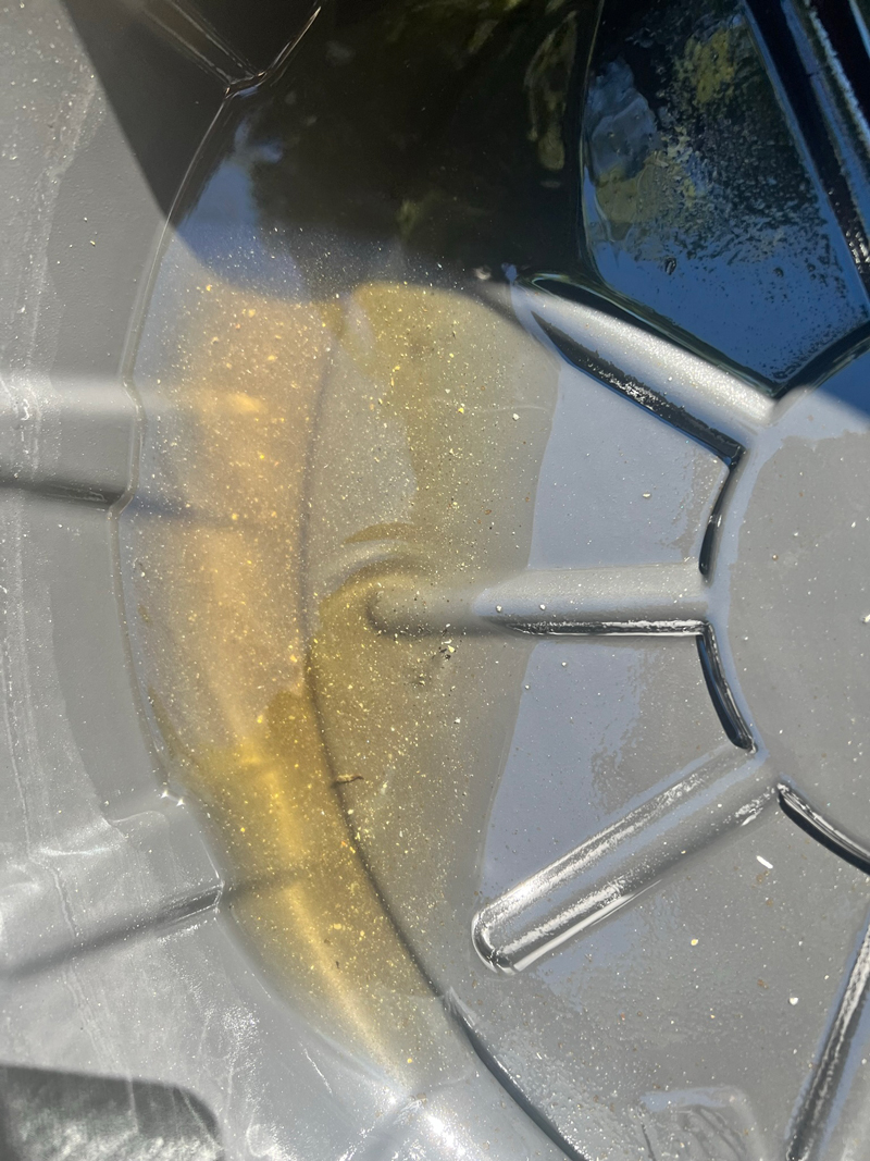

Well I finally got back to dealing with the fuel pump today, as it's been getting louder and louder and my smog check is due. I decided to pull out the gas tank strainer, which meant I had to drain out the last few gallons of the E85 that was in the tank. The strainer didn't look horrible, but it did have a film of muck on it. It rubbed off easily with my fingers, but it's possible that film was impeding the flow. New strainer and filter are on their way. In the meantime, look at the E85 that came out of the tank!?! If I was panning for gold, this would be great, but not so much in the gas tank. Much of that crud are metal flakes, and only a small fraction of it sticks to a magnet. I assume the strainer keeps most of that out of the pump, but I'm perplexed where it's all coming from? The gas goes through the strainer at the bottom of the tank directly to the pump, then to the fuel filter, and then up to the fuel rail/injectors, and then back to the tank. So where in that process do metal flakes get created and find their way back to the tank? I'd guess it's the pump failing, but anything the pump spits out should be caught in the fuel filter I would think? Would hate to think it's coming from the E85 gas station? Will cut open the filter and pump tomorrow....
