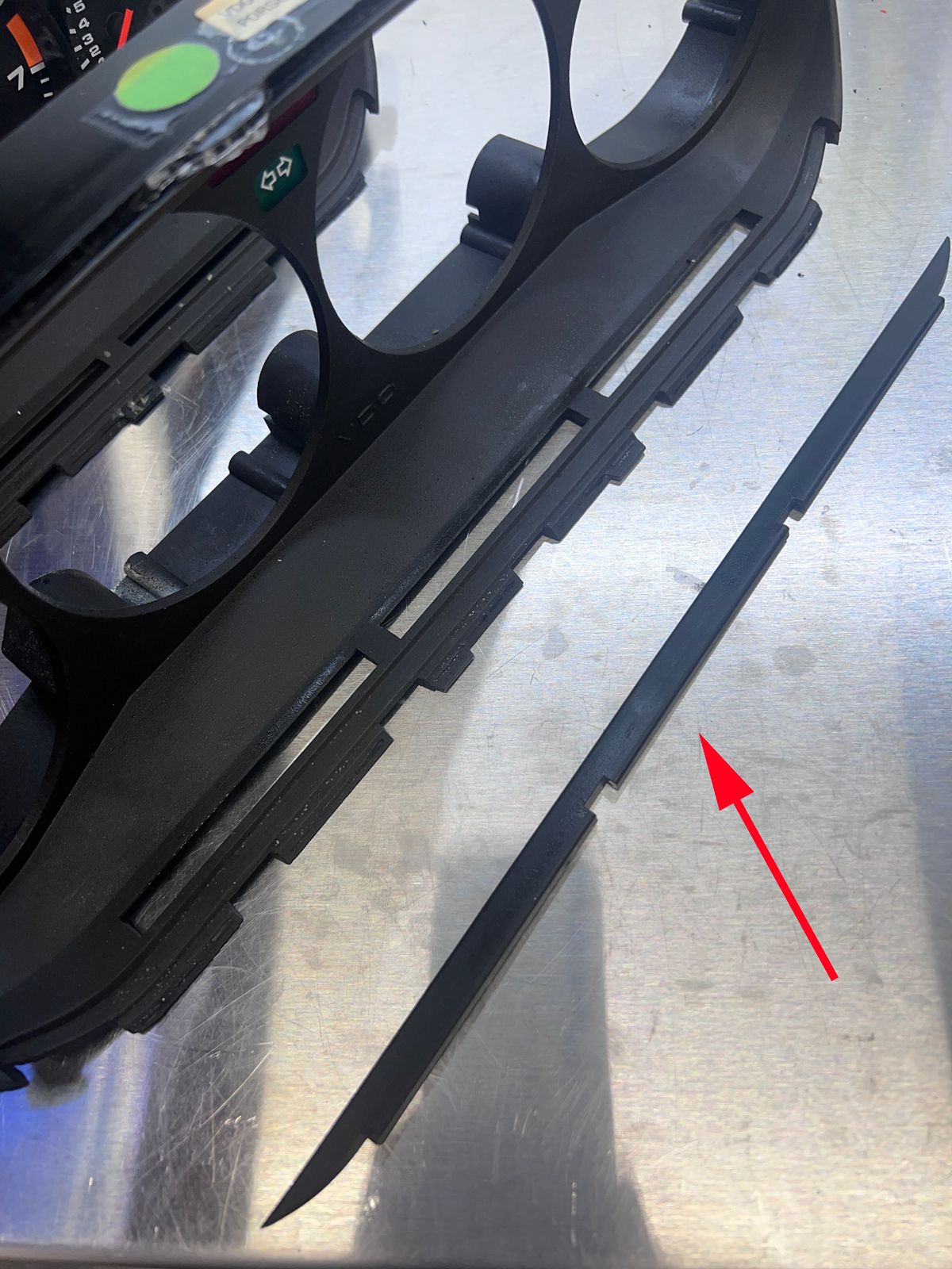

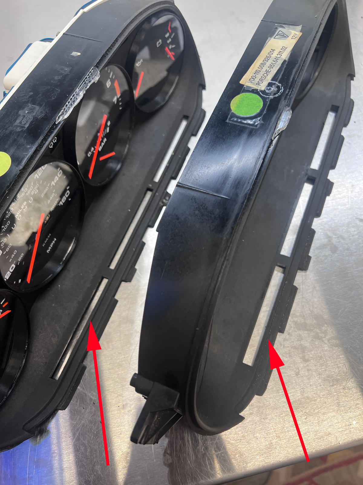

In the meantime, I discovered something I never noticed before. There are (at least) two different styles of the black binnacle for the 944 instrument cluster. While all the binnacles I've seen use the same light tunnel pieces (i.e., the part that loses its reflection and causes the lights to be dim), some of the binnacles have a little trim strip in front where the light comes out. I can only speculate that they were working to reduce hot spots and/or glare on the dial faces, by blocking the light from shining directly on the gauges. If you have this piece, it is probably contributing to your dim lights....
I'm not sure if they added this strip to reduce glare, or if they removed it to improve the lighting -- but would be curious to hear from others to see if your binnacle has this piece and, if so, what year your car is. In all my years of 944ing, I've never seen anyone mention this piece or its effect on the light level. It's not easy to spot in an assembled cluster, because there is also a wider black strip at the base of the cluster that hides the light tunnels altogether, but if you look from above with a flashlight, you should be able to tell if you have this piece....

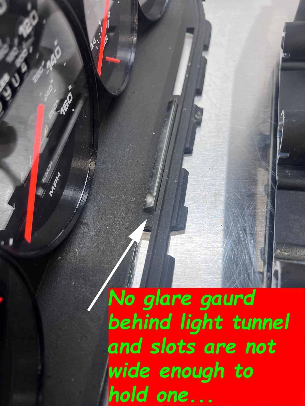

With the light tunnels removed, noticed how the binnacle without the glare guard (on the left) has slots just big enough for the light tunnels, whereas the other binnacle has wider slots big enough for the glare guard and light tunnel.
