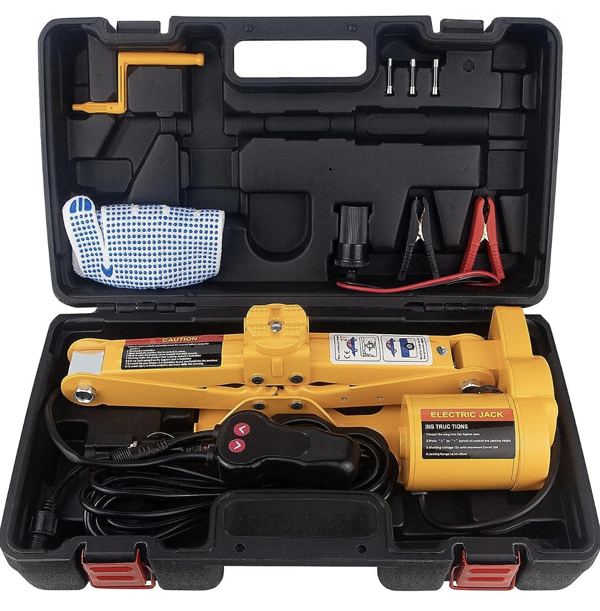

I am researching electric jacks based on some discussions elsewhere.irishbirdman wrote: Sun Apr 21, 2024 7:11 am Interesting reading y’all. Any thoughts on a compact jack? We do a ton of PCA roadtrips here in BC and the law of averages means someone’s bound to get a flat and the law of Murphy will dictate it’ll be miles from anywhere - AND it’ll be a centre lock that the AAA/tow truck guy will never have seen before, etc, etc…
I already have a cordless impact (plus a low profile floor jack - gets all my wheels off in seconds for an occasional deep clean!) so with that, repair kit and a jack we’d back on the road pretty quick WITHOUT having to lay on a blanket. i don’t know if any of us have given any thought to the possibility of flats when we head out, I’ve definitely never heard it mentioned - so I’m glad I read this! Thx again and hope someone has some jack ideas…
Example only:
- IMG_2659.jpeg (563.43 KiB) Viewed 849 times

Ya. The aluminum manual jack makes the most sense - the lazy-ass powered ones are probably more bulk and weight that can be done without. One always hopes that it’s like bringing an umbrella to make sure it doesn’t rain.
