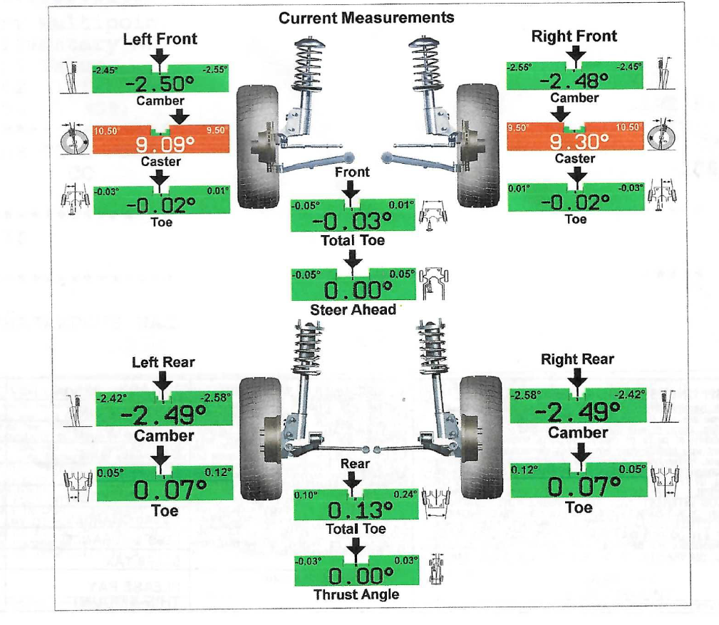

Some good progress Jeremy.
If it were me I'd wait until you have some time on track and/or more adjustments with what you have now before lowering the front with changed parts. Personally, I would never cut the springs - can't go back if they don't work out and there could be other unintended consequences. Clearances need to be considered which is why Porsche says "nein" to using control arm shims as those with GT3's often do. Even though those particular GT3 parts are the same on a GT4, the clearances are not the same. Less wheel room in the GT4??
Following is the direct quote from the 718 GT4 tech manual courtesy of my Porsche dealership's lead tech:
"Front-axle camber setting: The camber adjustment on the front axle on the Cayman GT4/Spyder is performed only via the supporting mount. The intermediate plates on the 2-part wishbone must not be changed, as this can result in an impermissible wheel overlap at the wheel housing."
Also, you should be able to achieve more negative camber than you are currently measuring and I think you might find that to be the case with the pro alignment you are planning.
The toe at or near zero is where the consensus seems to be. However, as you can see, I chose to run slightly negative in the front and even further from zero on the positive side in the rear. This works very well for me. My current alignment setup seems about perfect based on what I'm experiencing on track.
My alignment specs done last summer after the Tarett upgrades:
