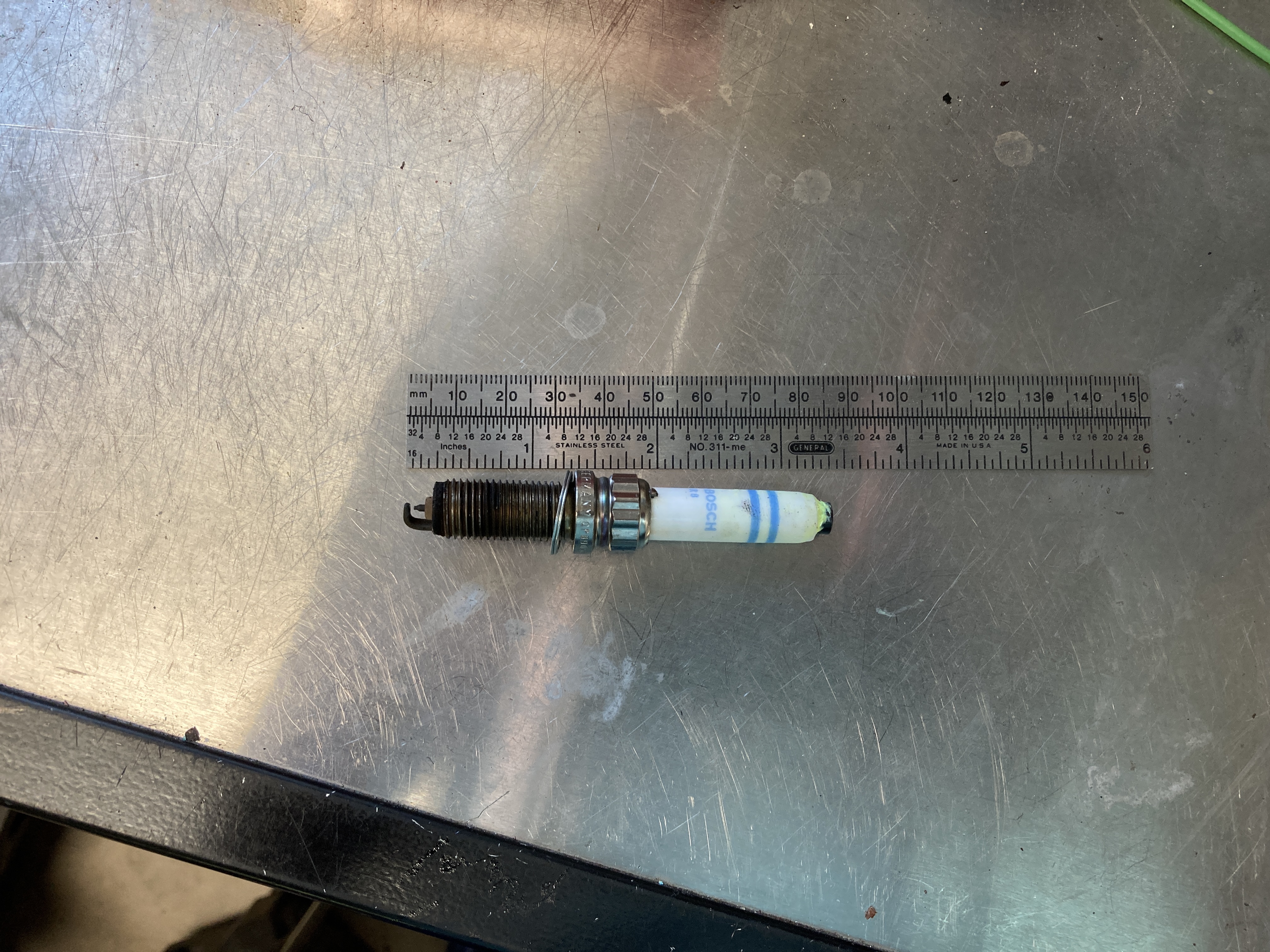

Tom wrote: Wed May 10, 2023 11:25 am Wow, those are the longest spark plugs I think I've ever seen. Which motor are those for?
Here's a better picture to judge by. They aren't all that long overall, but they are very thin. Pretty long reach, too.
