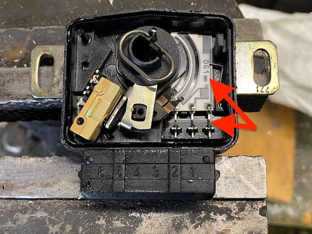

If the goal is to replicate the TPS... due in part to it being out of production and extreme cost etc... could we not just buy the more readily available units for BMW and others and transfer the inside parts into our original housings?
I am assuming of course that those printed boards are the same inside and the incompatibility lies with mounting or number of output pins etc

It's possible, but finding a BMW part with the same internals would be the trick, if such a thing exists. If you know of one, I'm all ears. The pot traces on the 951 TPS look designed in place for that case, and the idle contact switch is either NLA or not off the shelf. Bosch may have used the same parts in other units, I really don't know, but without opening a lot of units, I wouldn't know where to start. My plan was to find off-the-shelf parts that are electronically compatible with the originals, and design a new case around them... That seems like the path of least resistance unless someone knows of another TPS with internals that would transfer over like that...

The trace board has a part number on it.. and there are only three connections to it? Perhaps one of the 3-pin connection TPSs have the same board (if any work as potentiometer like the 951s)
How about a call out to BMW and Bosch car owners from the 80s & 90s to open up their TPSs :lol:
And I suppose there is no way to re-plate those traces?
