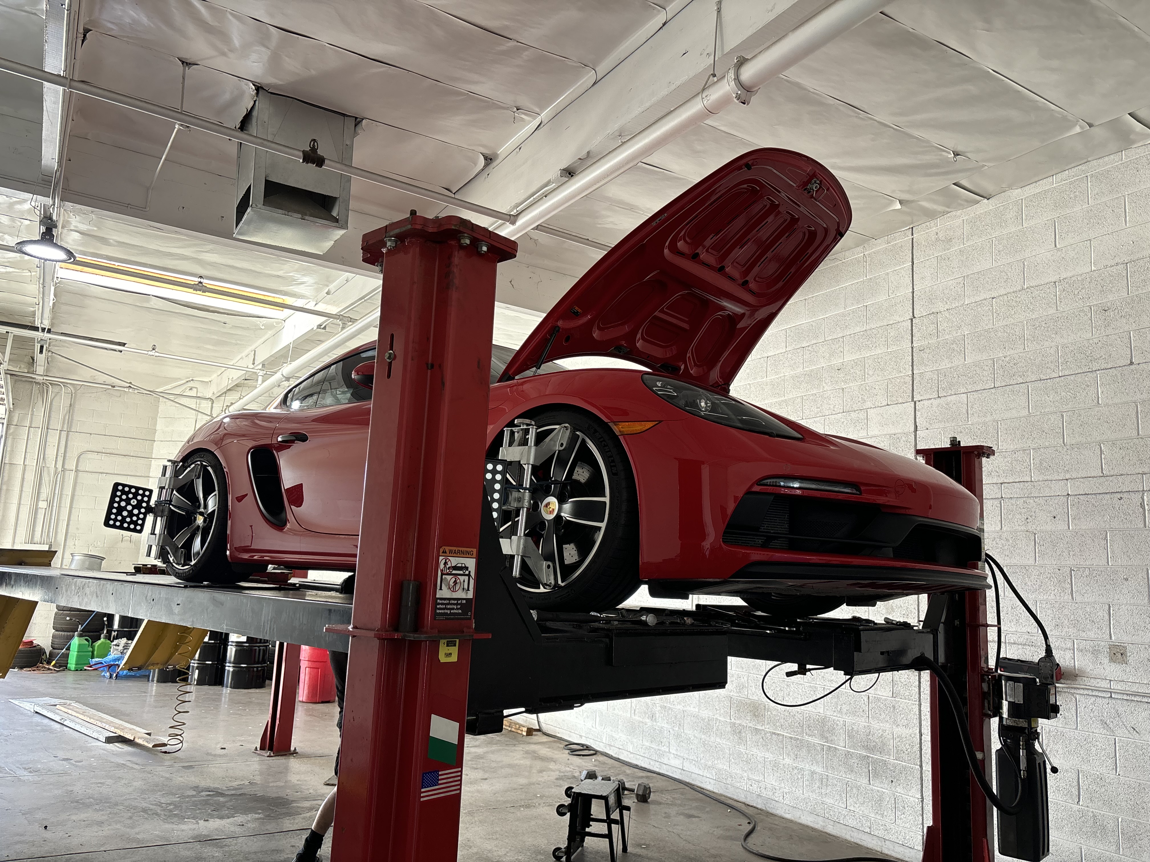

Alignment day
Posted: Fri Mar 01, 2024 9:13 am
J-Dub wrote: Fri Mar 01, 2024 9:03 am Alignment day
Good and proper alignment = Happy Car.
(A color-matched lift no less! :D )

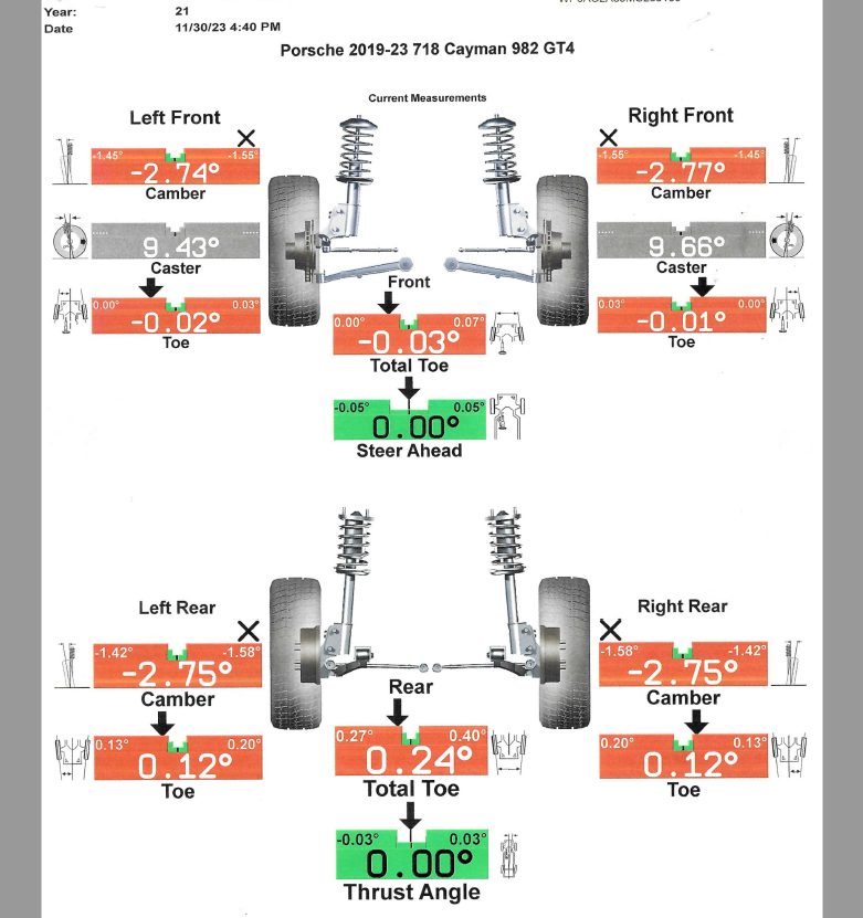

For reference, my last alignment is as follows:
RF -2.74° Toe -0.02°
LF -2.77° Toe -0.01°
LR -2.75° Toe +0.12°
RR -2.75° Toe +0.12°
We're both together and right in what I think may be the sweet spot for both track and street.

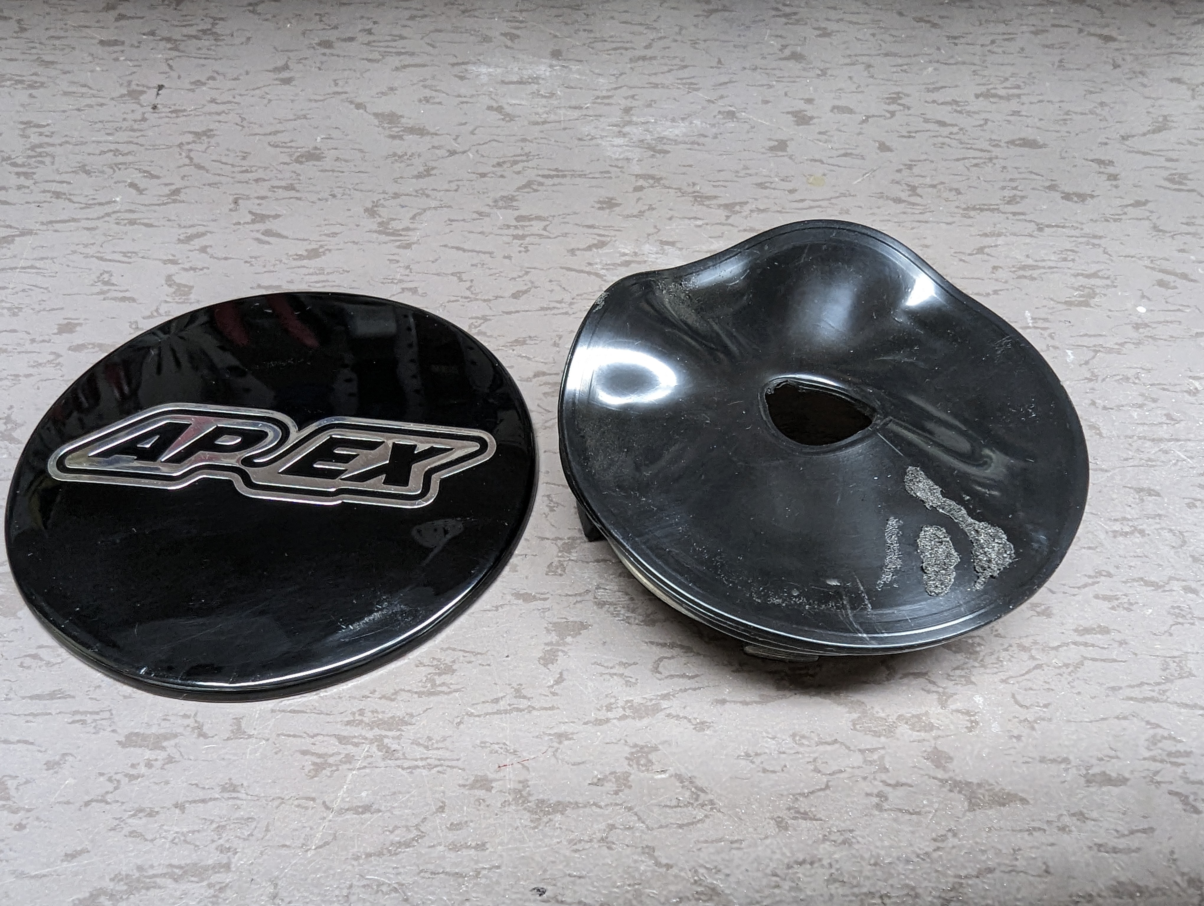

Don't forget to take out the Apex center caps before getting on track Bill - they melt! (Would be fine for AX but probably not for full on-track sessions. :angel: )

Thanks Tim for reminding me about the Apex Center caps as I popped them in for the picture and the funny thing is I have never actually installed them in any of the previous 6 sets of wheels I have gotten from them. I have seen melted caps and your reminder will get me to pop them back out. I never put any caps in before since many racing series won't allow them. Metal or plastic, if they pop out under heavy G loads, bouncing down the track and hitting a competitor it could do severe damage.
