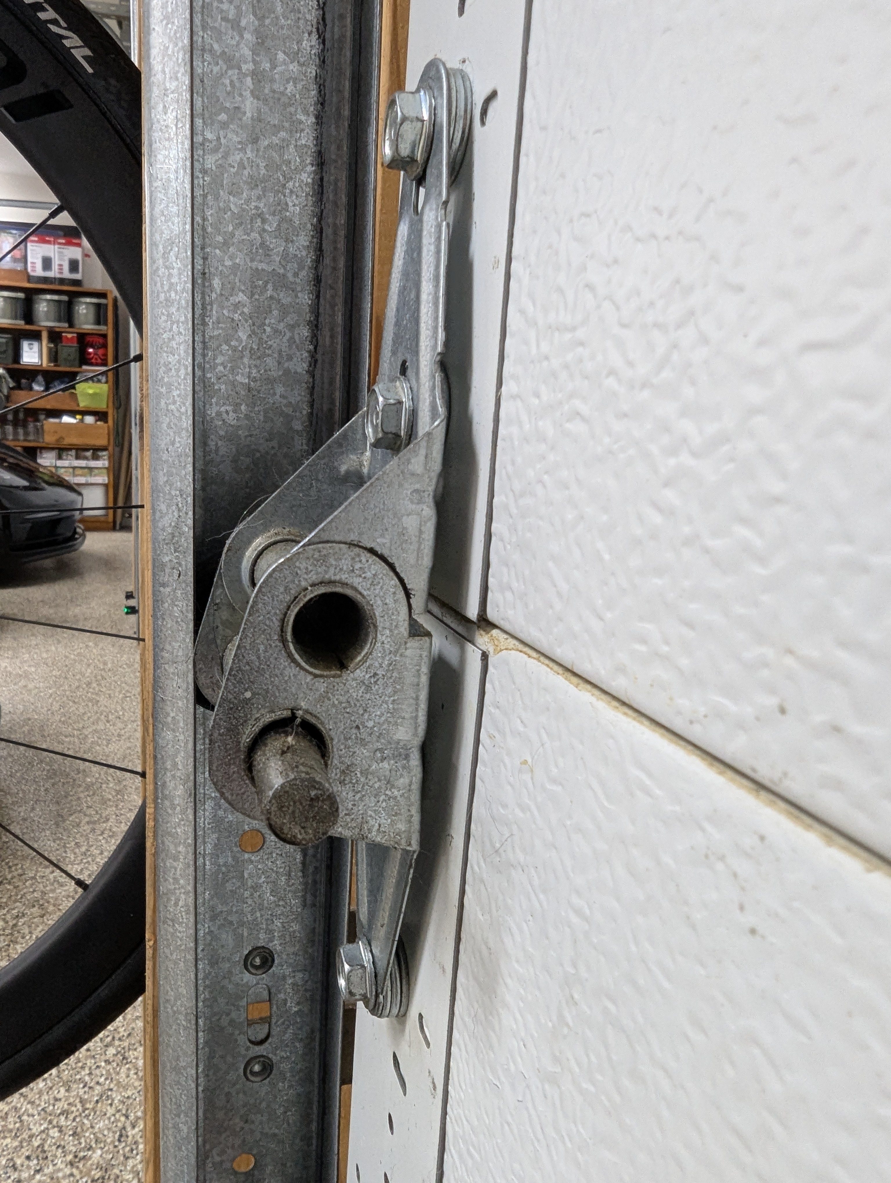

@Tom Thank you. More going in soon. The garage doors have some gaps when closed (1/4"), so I need to find a solution for that first and I want to see how this fairs during this winter. My rails are not in/out adjustable, nor do they have the type of articulation hinge that allows for spring loaded hinges, so looking at what other options are out there.
The electrical panels are in the garage, so adding a 220 V outlet would be pretty easy to put in a heater to take the edge off once I get there.

Gaps were not too bad on my doors but I solved the few that I had by using washers behind the hinged roller mounting plates where needed. This rather inelegant fix pushes the rollers back into the rails forcing the doors forward, thereby closing the gaps at that spot. I only had a few panels on each of the three doors that needed help.
It's not a very sophisticated solution but it works and doesn't bind up the doors when opening/closing. I was careful to not over tighten the sheet metal screws so as not to strip out the holes in the aluminum doors when snugging the screws back in. You could also get longer sheet metal screws if your gaps are really huge. The attached pics were of the most extreme roller hinge that I "fixed". :angel:

@blueline That is great, thank you! Reminds me of a bent trailing arm fix my brother and I did many years ago on my $300 VW Rabbit I purchased. He and I had a contest for a few years on who could buy the cheapest car and successfully drive it as a DD. The fix cost us 4 washers on the passenger side and a few hr. of work.
But, I digress. I will look at this over the weekend. My hinges are short and rectangular so I will need to see if I can fit washers behind the hinges and not interfere with the articulation point. Sometimes the simplest fixes are the most elegant.
Thank you again! I will let you know how it turns out.

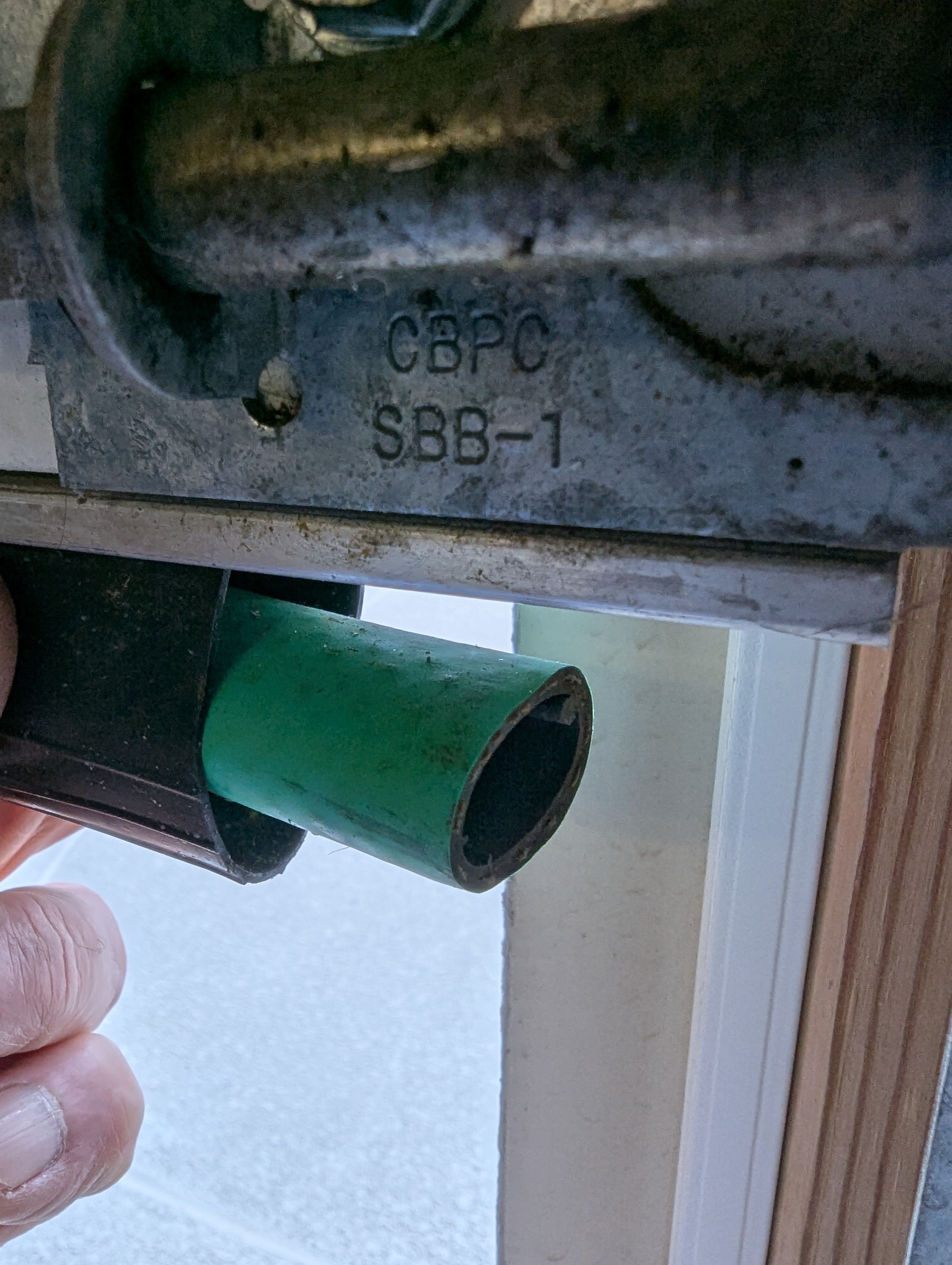

Another big piece of the puzzle to help seal out air, grime, bugs, rodents, etc. is the garage door bottom seal. I keep mine cleaned and siliconed. Replace it when it shrinks and loses elasticity and effectiveness. I replace mine every 4 or 5 years. A roll of new channel compatible rubber is inexpensive preventative.
Another great tip to not only extend the life of that all-important bottom gasket, but to also create a super good seal to the floor is to slide a piece of small diameter, cheap garden hose the full length inside the gasket. It's a miracle worker.
Very few bugs make it inside my garage. For the few who do find a way in, I have strategically placed glue traps adjacent to the floor highways along the edges of the walls that the critters prefer. Also, FWIW, after many years (36) in our current home, I have yet to have a rodent of any kind disturb the interior peace of my former and current garages. (Yeah, I keep some baited Victor spring traps out just in case!)
