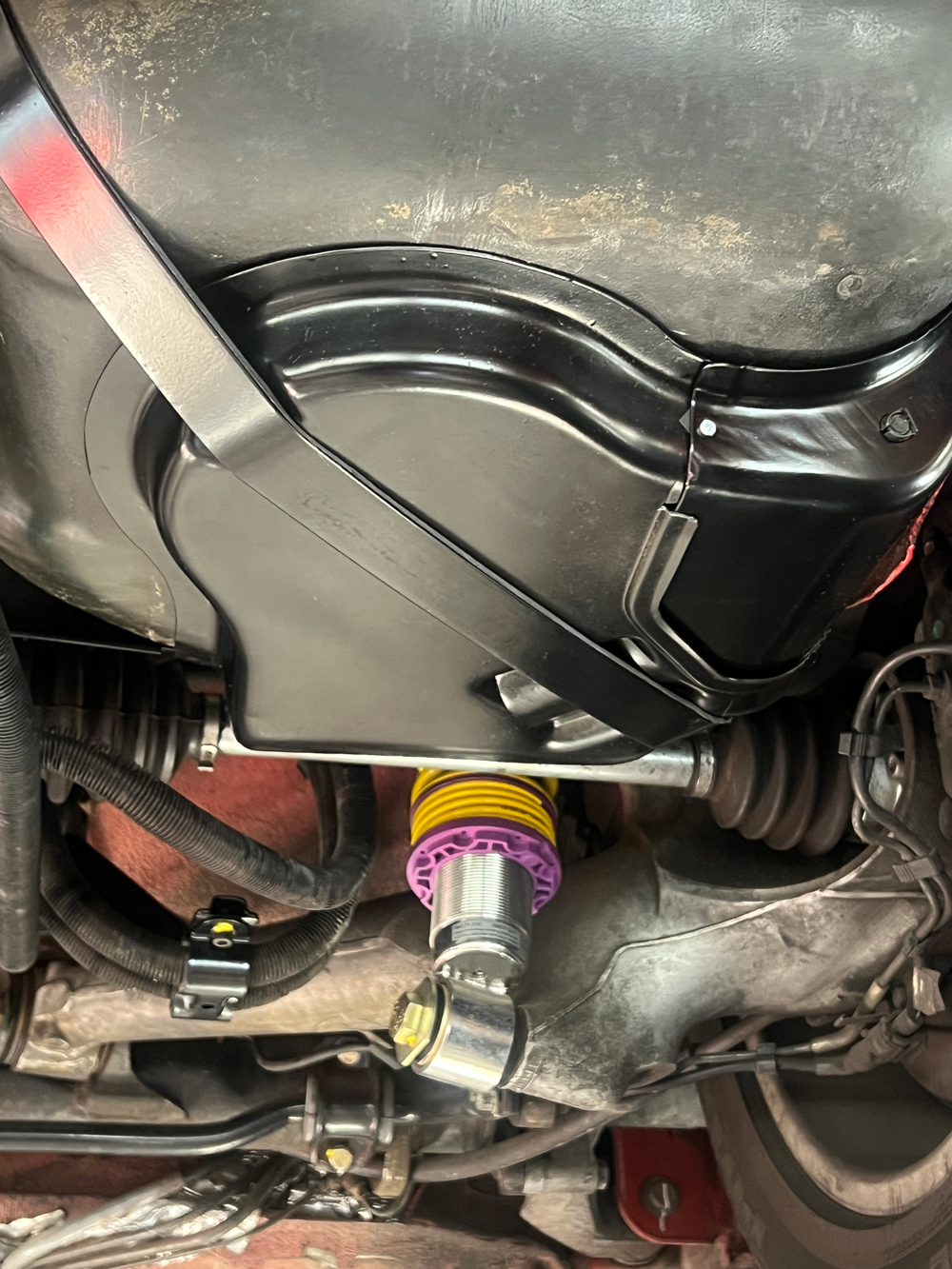

I'm incapable of fixing anything without getting side-tracked 'while I'm in there.' This week's edition is stripping and powder coating the fuel pump covers and transmission oil cooler brackets.... My powder coating won't win any awards, but certainly better than the 40-year-old road grime and crusty Cosmoline..

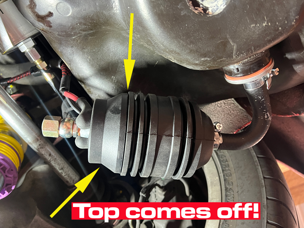

Just finished installing a bone stock 951 fuel pump, with new filter, strainer, and all hoses. My plan is to run it with gasoline (e10) rather than e85, which might have been part of the problem. The swap was uneventful. Other than 'restoring' the covers with several hours of sandblasting and powder coating (and new foam), the only interesting thing of note is that the factory fuel pump rubber casing now separates in two, which makes it WAY easier to get the pump inside. Sadly, I discovered this after shoving the pump down through the removable top. :roll: :lol: But good to know Porsche is still thinking about these thing.... Fingers crossed this one will last as long as it should! With my car detuned, the factory pump seem adequate for my fueling needs. I did some spirited 14psi runs around town and all was well. No where near as fast as the old days, but nicely balanced with impeccable drivability, thanks to mostly stock chips (with only the WOT and over-boost values modified). Onward and upward!

by Thom
The improved rubber casing design dates back from the 968 I believe. The original 944 casing is probably not available from new anymore.
