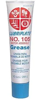

Oil pump hack:
I've mentioned this elsewhere, but if you lube the oil pump rotors with white grease before mounting the pump, the thick grease will cause the pump to pull oil from the sump quickly. Barely any sweat during initial start-up! This lube is great for all the new bearings too.

I've used Redline assembly lube in the past. Would you recommend this for all parts that would otherwise need assembly lube?michaelmount123 wrote: Sun Apr 21, 2024 11:59 am Lubriplate 105.webp

No doubt there are many suitable assembly lubes. I like the Lubriplate. It's not very messy, thick enough to not run off surfaces, and not expensive. I use it on all rotating parts (including seals) except the cams and lifters. Here I use a cam lube that's more suitable for high pressure applications.Tom wrote: Sun Apr 21, 2024 12:35 pmI've used Redline assembly lube in the past. Would you recommend this for all parts that would otherwise need assembly lube?michaelmount123 wrote: Sun Apr 21, 2024 11:59 am Lubriplate 105.webp
