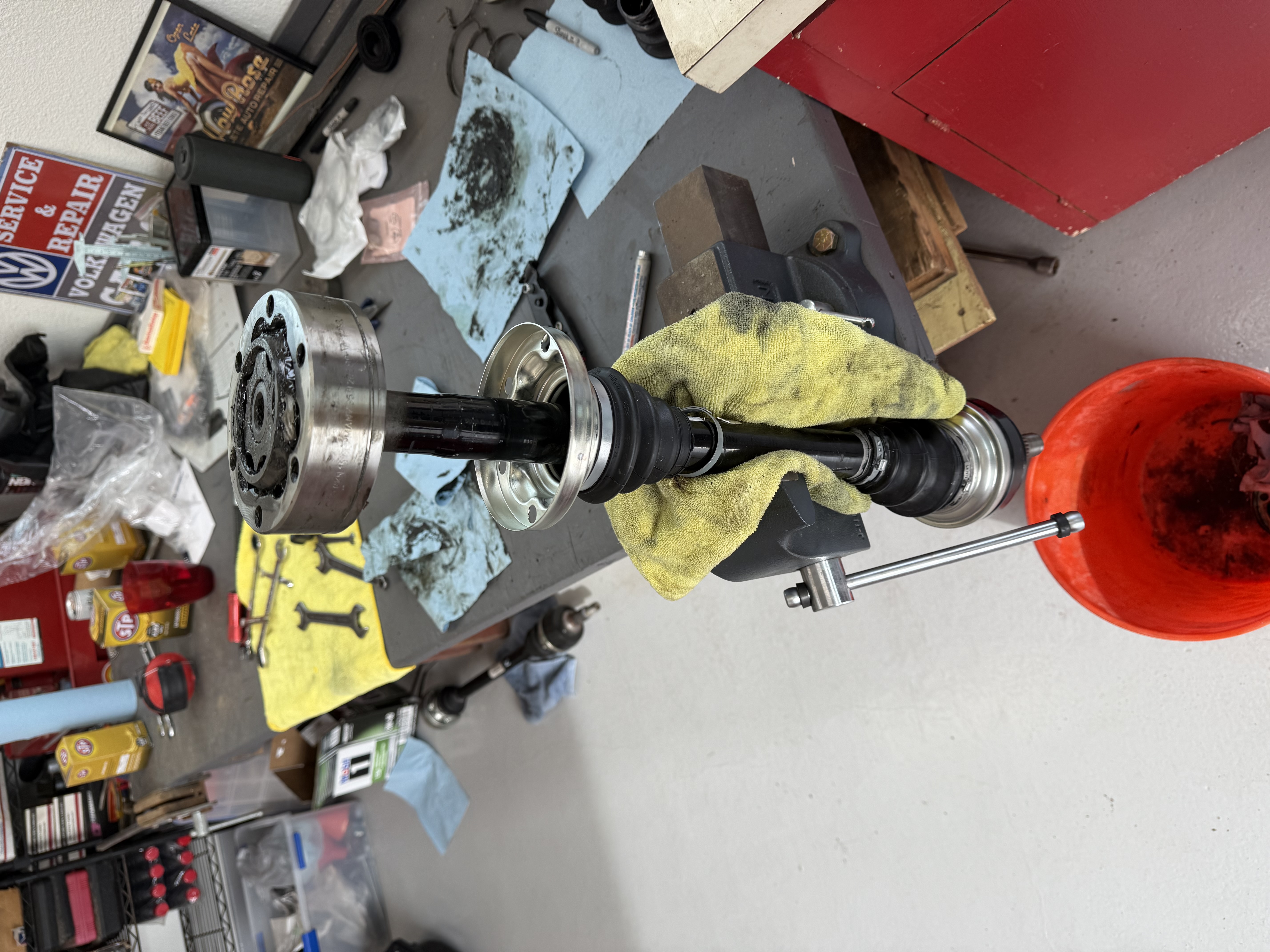

I have an ongoing battle with leaking CV boots. I believe the core issue is the heat generated from track use however I recently realized they are also being roasted by the aftermarket over axle pipes and the fact that the heat insulation they have is not sufficient. I have fashioned a home brew heat shield for now however after my last track day the driver side outer finally split and I had to address it further. Long term the OAP manufacturer is working on a solution so I will keep my home brew solution for now.
Axles out and new boots and cups all the way around. New grease, c-clips, CV bolts, axle nuts etc. I have taken all I have learned with high temp RTV and good CV clamps. Just got them back in the car tonight.

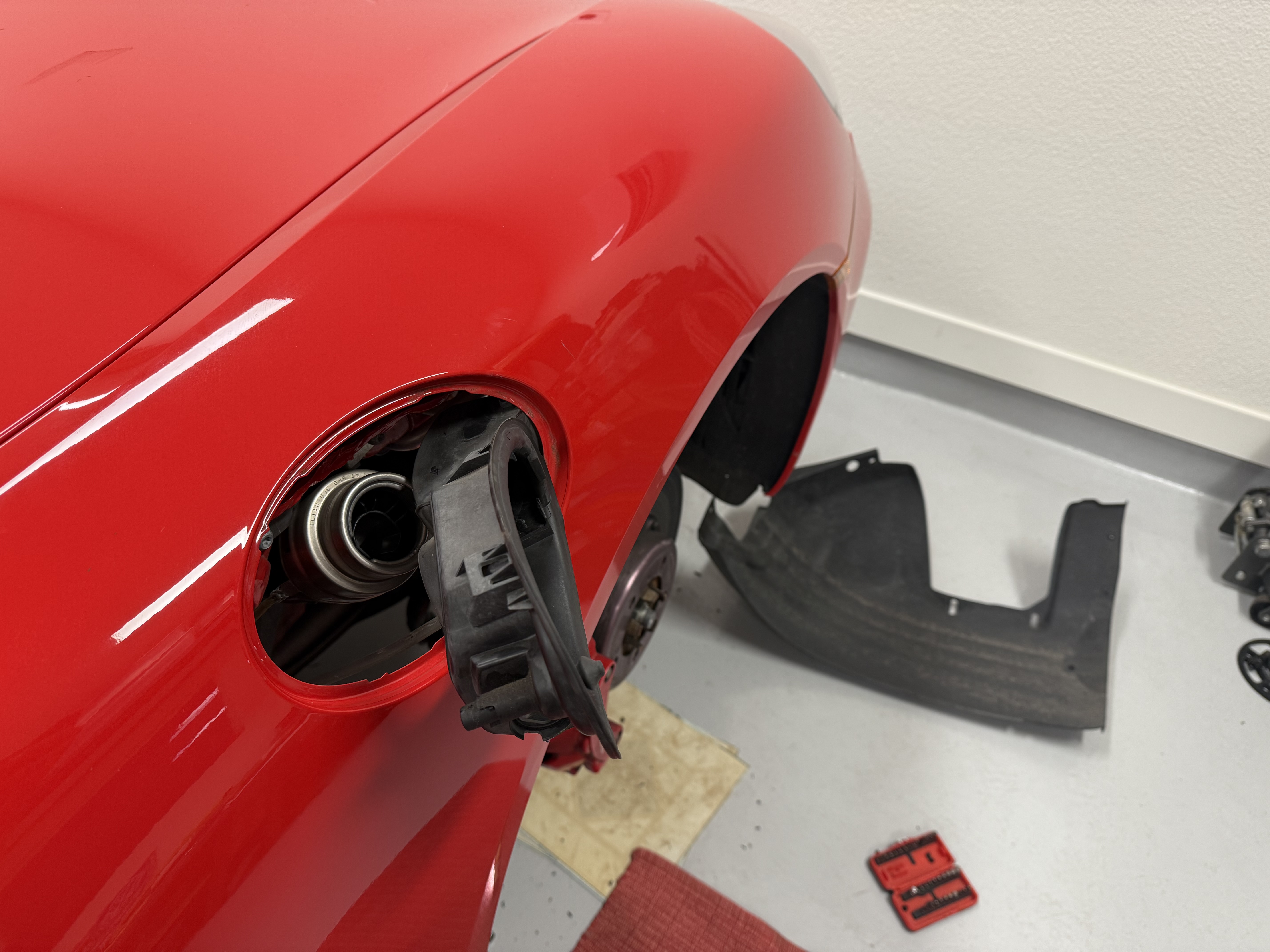

A few weeks ago I was at the gas station and went inside while the gas was pumping. For several reasons I was distracted and pulled out of the parking spot while the gas spout was still in the gas filler. I broke the gas door filler hinge. Thankfully it is actually easy to replace, simply remove the fender liner and swap out the assembly. Porsche calls it a gas pocket, it is the assembly under the gas flap door that contains the hings, holds the lock, surrounds the gas spout etc. The painted cover was not damaged and snaps on to the replacement flap.

Regarding the CV boots they are all the same size, and yes they are available separately,97033229300. The Inner can be purchased on their own or as a kit with the cup and already clamped. I ended up using the kit on the inners, seemed like the right thing to do. The outer "Cups" are really attached to the stub shaft and did not look easy to replace.
Since this image I have added one additional piece of heat insulation wrap around the three bolt flange as that entire area is close to the brake lines, CV boots etc.
